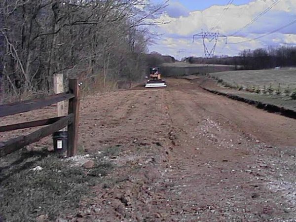

Don't think a hoe is the best tool for your application. Here's what we used, and it made short work of a 650'-700' gravel drive.

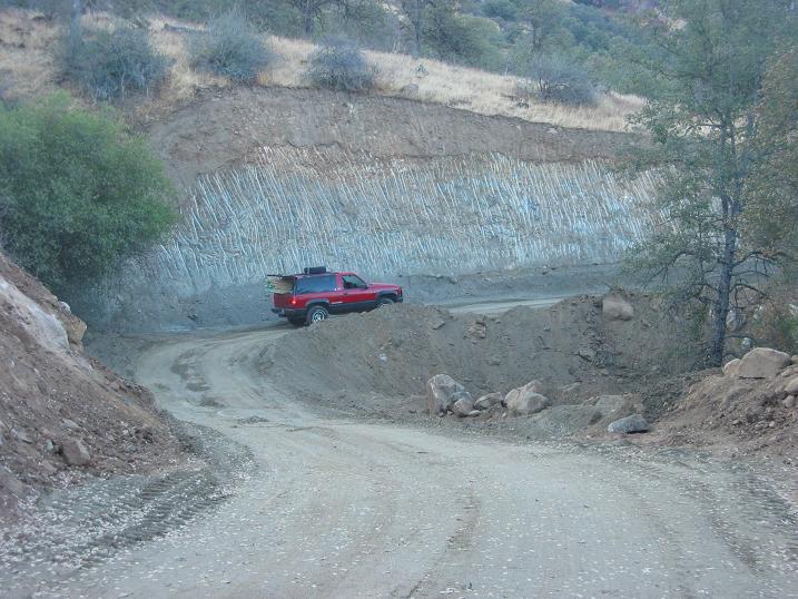

If your talking Rock, boulders and such, you'll have your hands full and I agree with the other posters to consider having and expert handle THAT part. You can do the other. If your talking like decomposed granite, that can be done with an excavator. Some of you may have seen this photo before, where part of my road had to cut through a ravine with a lot of hard DG in it. You can see the teeth marks on the bank.
As far as the side note about wind or solar power, you'll still need a backup generator for those days the battery bank does not charge for lack of sun or wind. We are going totally off grid with solar. Here in So CA, SCE wanted to charge us $25/ft to pull from nearest box and another $25/ft to put it underground in conduit. HA! The nearest pull box is almost 3,500 ft away! Do the math...

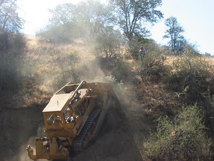

This is what we used to do the rough work in the ravine and also the entire road... a little 55 to D-9. Check out this photo.
