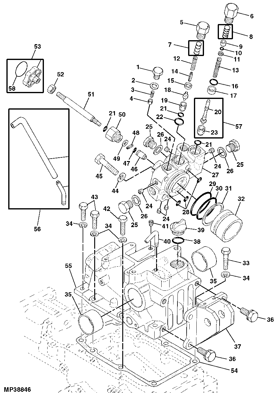

Hello, I got a Hole in Hydraulic Line John Deere 790 with 70 front loader. I got part order but my question is on the hydraclic oil, where is the fill point? and also do I need to change the hydraclic oil or can I just add? is it like brakes you got to make sure there is no air in the line?

Hyd will self purge as you use the cyl's.
Just add more same type fluid.

Dipstick(parts key #3) for hyd oil level. Filler cap(parts key #39 2nd photo).

Fill is behind the seat. Dipstick is also behind the seat further back and to the right. Use Low Viscosity Hy-Gard oil.
