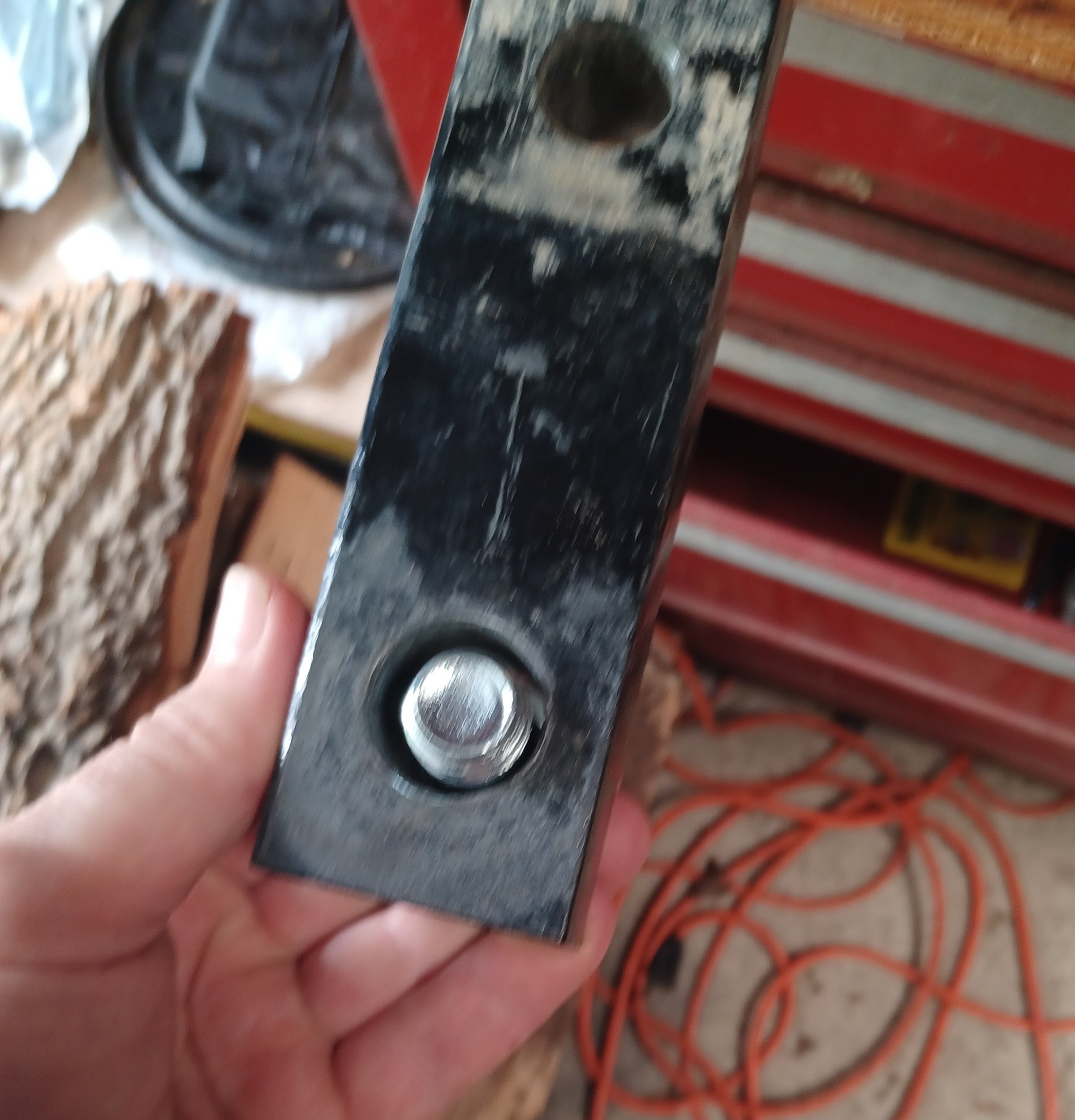

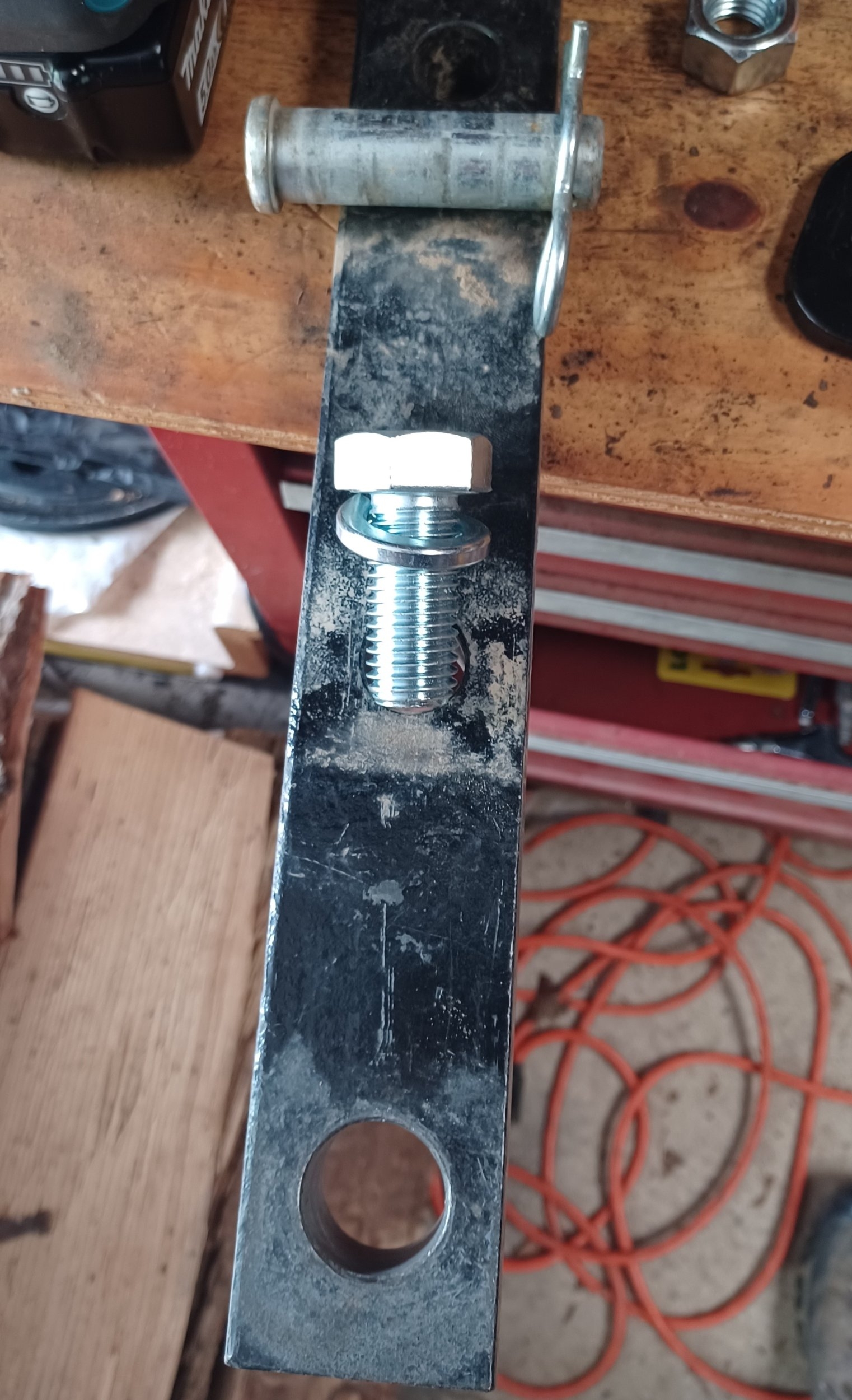

Not sure if its too late or not but I happen to have my drawbar out on the work bench trying to find the right size ball shank for it. The draw bar is thick you need at least a 2" long shank so thats the first hurdle.
Its larger than 3/4" - Im thinking its 1"
Here are pics to show. The pin to hold the draw bar on the tractor is 3/4" - the bolt in the pic is 3/4"
That same 3/4" bolt is in the 2nd pic is in the hole for the ball you can see the hole is larger than 3/4" and the bar is pretty thick at least 1" if not more so you need a longer shank than standard size for a pu truck.
You can probably "make due" with that 3/4" ball for a short driveway pull. I think the bar is square so the thickness is pretty close to 1" prolly metric tho.
   / Hole sizes in standard draw bar LSMT335H #5
Ball end hole is 1”. The pin holes are .80”
They are actually metric so they are 26mm and 21mm
Draw bar on my 2 series tractor is 25x50mm. On my MT347 it is 30x50mm.
A 2” long shaft is just long enough for the 25mm. You will probably want one at least 2.5” long if you have a 30mm.

I have one that I was able to break free from a drop hitch I had laying around. 1" x2.125" so that should work. Thanks a lot for all the information.
Checked the parts lookup, and you have the 50X25TX623L drawbar, so 2 1/8” long shaft should fit fine.
