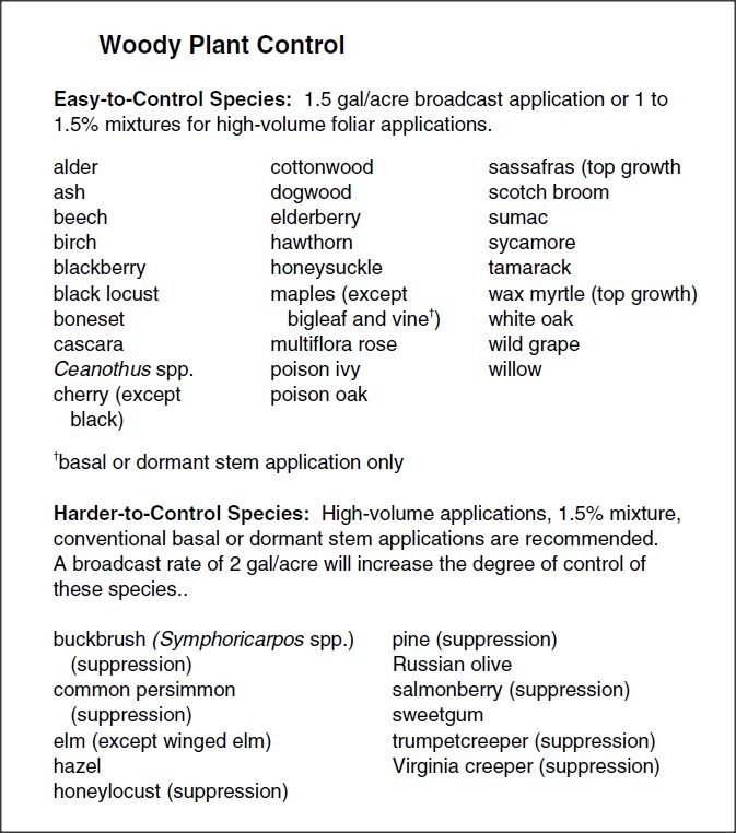

Crossbow instructions do not mention Holly, but they mention whole bunch of other easy & harder-to-control species:

my two cents FWIW..... since crossbow approach would be an off label approach I would say not a great idea.
around our parts a glyphosate or a triclopyr is considered an approved approach
