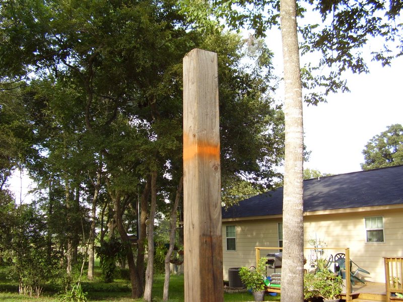

How to build a fancy wood pile. Locate 7-10 foot dia. spot with max. sunlight. Seven or ten foot vertical pole (above ground) in center of circle. Paint mark at 80% up on pole. This mark is drying indicator. Once pile shrinks to expose mark it is supposed to be ready to burn. Form outer edge of circle with scrap treated lumber, bricks or just split logs (place circle on tin, plastic, trated soil.) Lay wood around circle, only one stack-course, with outer end on raised edge of circle and inner end pointed at pole, ie spokes. After completing one or two layers it will be necesssary to place pieces as spacers at the outer rim to raise outer edge again, many inner ends will overlap causing inner edge to build higer-faster than outer edge.

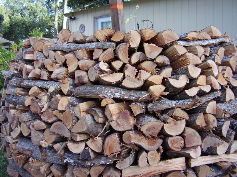

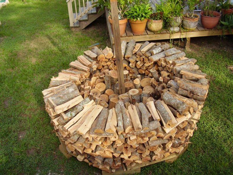

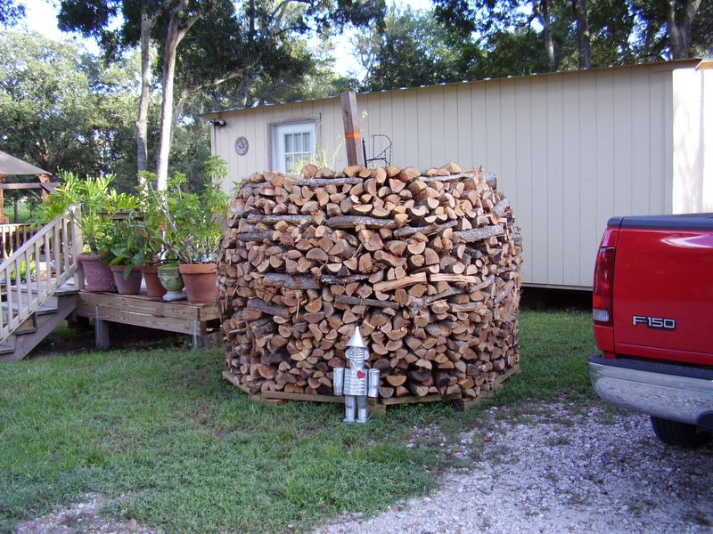

Holz Hausen-Wood Pile pic's as promised. Looking for trees to finish pile. Should be done this weekend, if Head Honch dosn't "find more important things for me to do." Orange paint mark on pole is dry wood indicator. Wood is piled to top of pole and mark is uncovered as the pile shrinks during the drying process. Note Tin Boy guarding almost finished pile. Tin Boy was adopted as a ranch hand several years ago. He thinks he may be related to Tin Man. Anyine knowing whereabouts of Tin Man and if he had a son, lets us know.

Aww, now ain't that purty? It's amazing how much wood you can stack in a small holz hausen footprint. I'm glad you tried it, don't forget to report back in 3 months! :)
Thanks for the pics!
P.S. That wood looks darn near burnable as is, what kind is it?

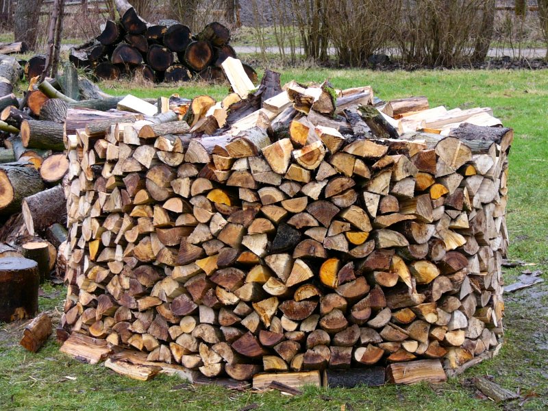

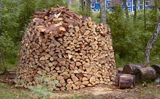

I have seen piles like that at a Finnish farm museum. It was referred to as a beehive woodpile. I found several pictures of them and always wanted to pile one, but found it faster and easier to do the row.

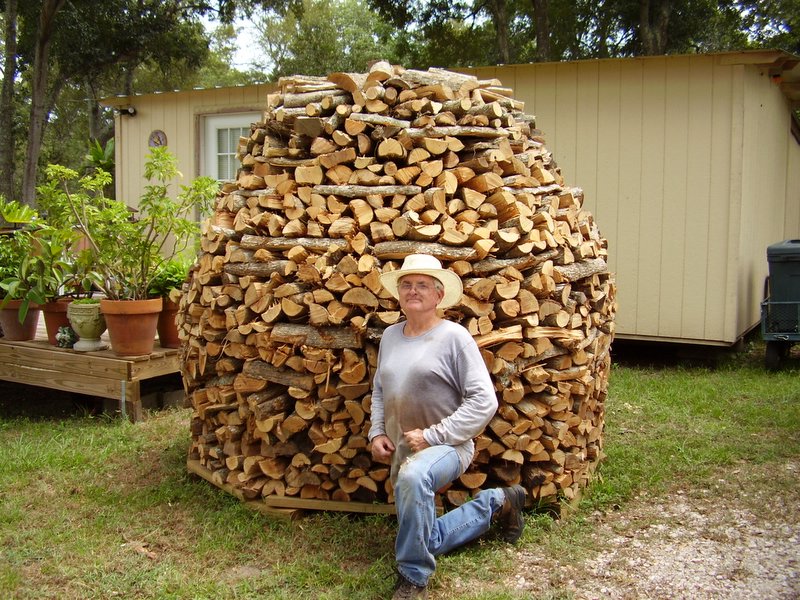

Pic. of finished Holz Hausen. Old man on ground is one tired Bar-Bob ranch foreman. Felling trees including stump, cutting and splitting two plus cords is real work.
And now on to next project. Washout concrete floor for tractor barn.

Status report @ 2.5 months. Pile is almost at paint mark. Recent 40 degree nites make fireplace a good option. Wood from top of pile (was covered with tarp when rain expected) is burning nicely. Some stacked normaly as a test case is not ready. Summary. It works. Stacking takes longer, the pile foot print is much smaller and it generally looks nicer. Was it woth it? YES
