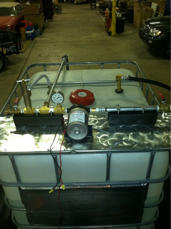

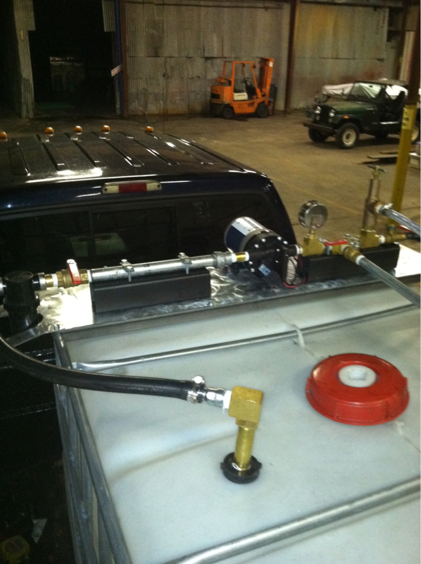

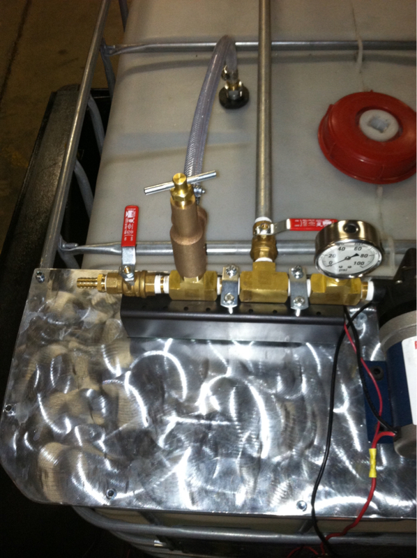

Here's one i built. It has a valve to divert from the rear broadcast to a wand. Works great. It will spray a 40 foot swath. I use it to spray Roundup. Basically the plumbing is just copied from a standard ATV sprayer, just bigger

That is a beautiful job. Clean, simple and correct.

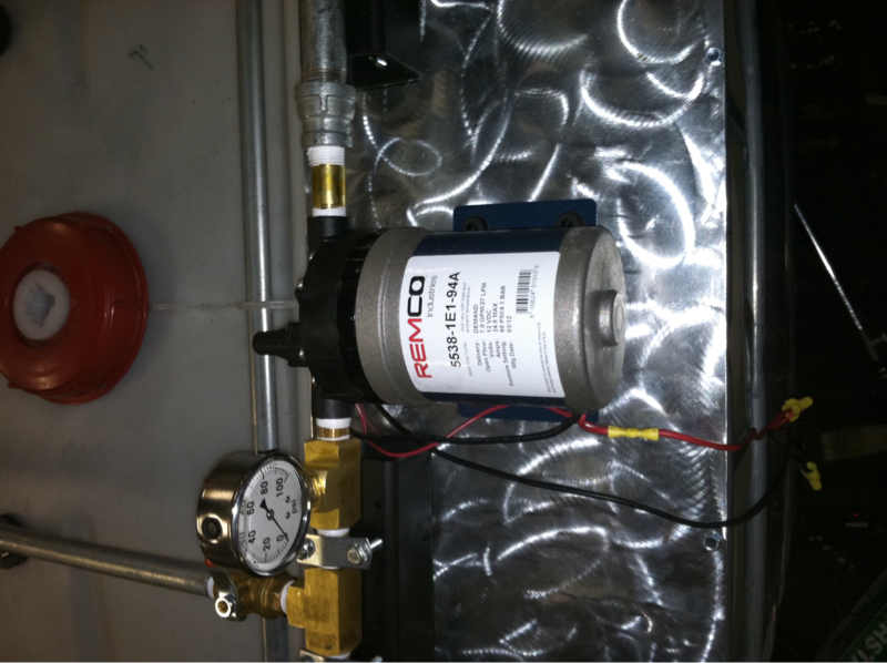

Thanks. Nice looking system. What kind of flow does that pump provide? Is yours powered by the tractor battery?

The pump was the most powerful i could find, don't remember the specs. It will empty the 250 gallon tote pretty fast, in about an hour or so (I'm guessing). The spray head is from tractor supply and cost around $100, but works great . I occasionally use a regular wand from Northern. I planned to hardwire it to one of my truck remote switches, but never did. So I just use a deep cycle battery in my truck bed and connect it with alligator clips.

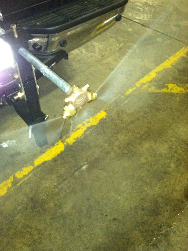

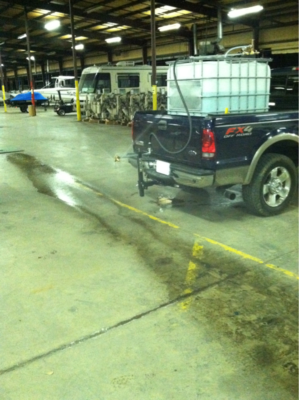

That last picture with nozzles working is spraying 1/2 of the product into the air and concentrating on the overlap due to the angle and losing product to the air at 45 degrees. Round up and most applications needs direct contact with the plant.
You need a boom with nozzle spacing and height for proper overlap/coverage. The triangle sprays need to slightly overlap without converging (slight left to right from center, my nozzle holders have this angle built in) when contacting the surface. My Honda gas home built sprayer needs 18 inch high and 18 inch spacing about 45 psi with Teejet 11008 VS nozzles. TeeJet's website should have a calculator for nozzles. This can be attached to your wand.
I was just given a older boom sprayer that fits in JD Gator it uses 10 inch spacing and 10 or 12 inch height. I have not looked at the motor or started. It has Wilger Combo Jet DR80-06 and Fr80-02 nozzles.
I do not use electric pump motors. Use the width of the trailer and see if the pump can support the nozzles needed for full width pass or more, you really don't want to drive on your spray. The new commercial sprayers even a foam marking system to set up your next pass overlap. I am old school and use my previous tire depressions and gauge the distance to overlap the previous pass. This should work for you. You want the edges of the outside triangle spray to overlap about two inches. Test on a dry surface like a parking area.

This shows heavy product in the overlap and casting to the distance, heavy in the middle. Those nozzles look great! separate on a boom and you are good to go. You look to need one truck width for overlap currently for proper spray pattern and not efficient.
