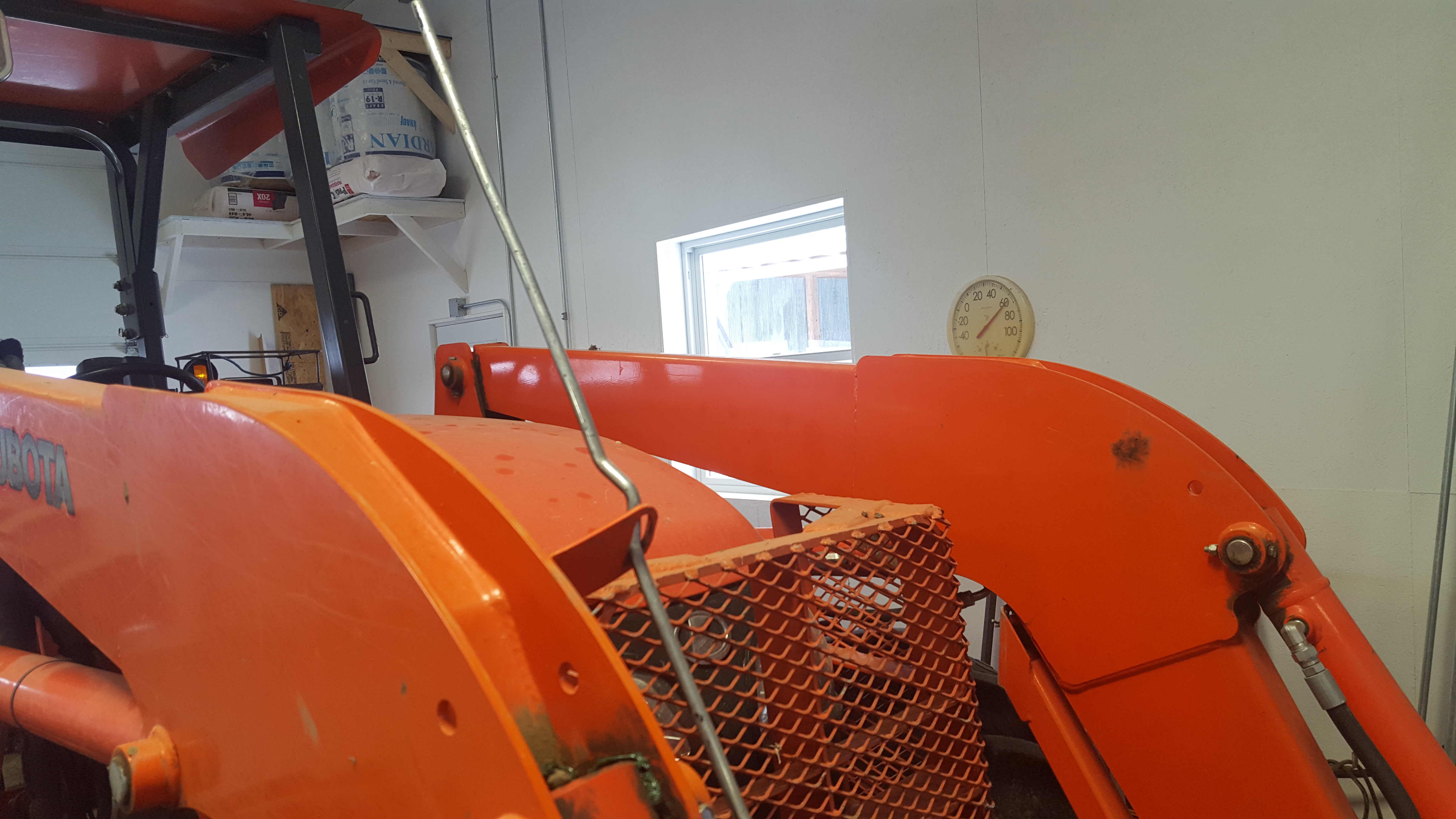

My Kubota uses a notched rod with an upside down V. The rod slides thru a slotted tab. Notch in tab equals level bucket.

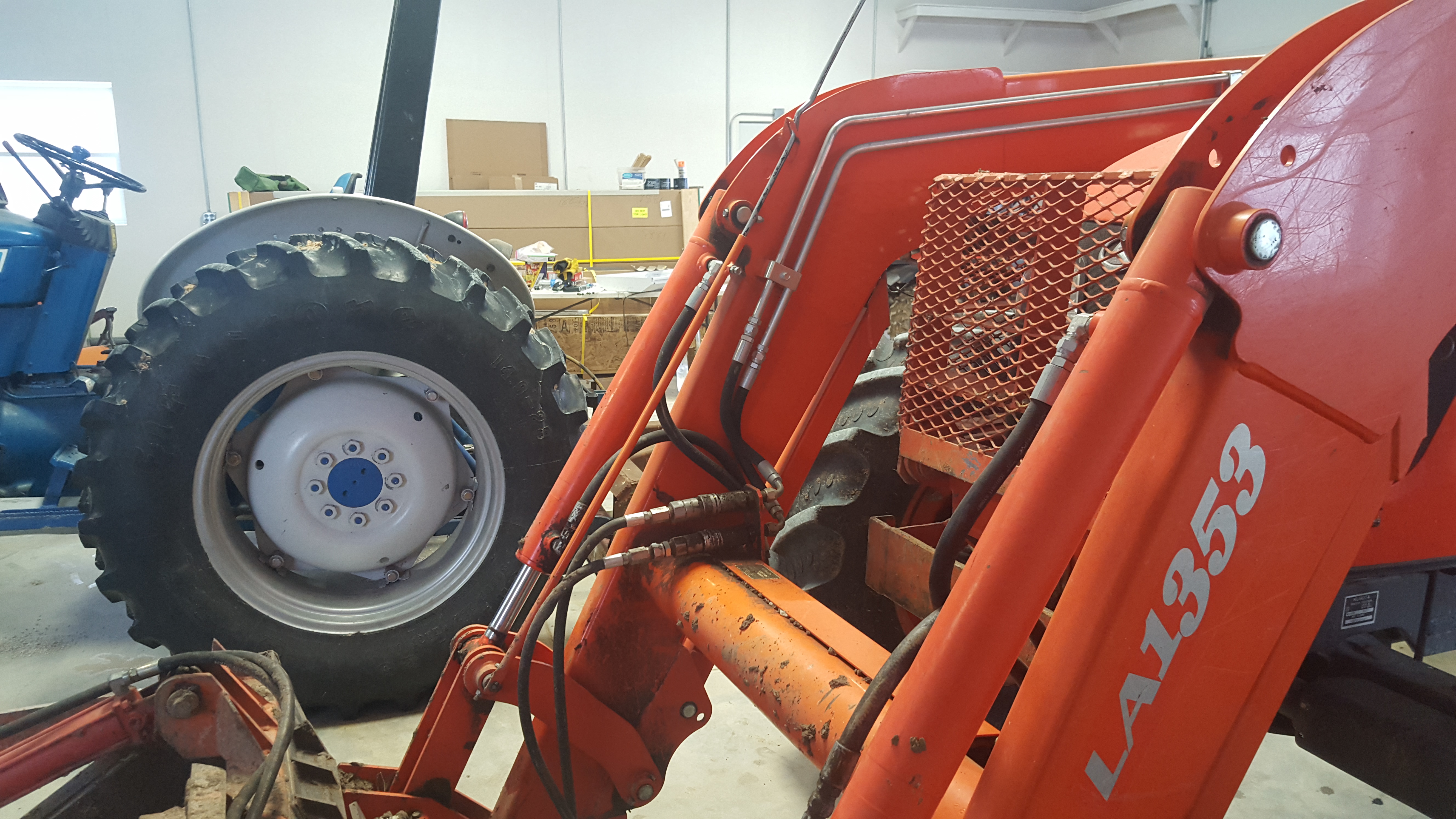

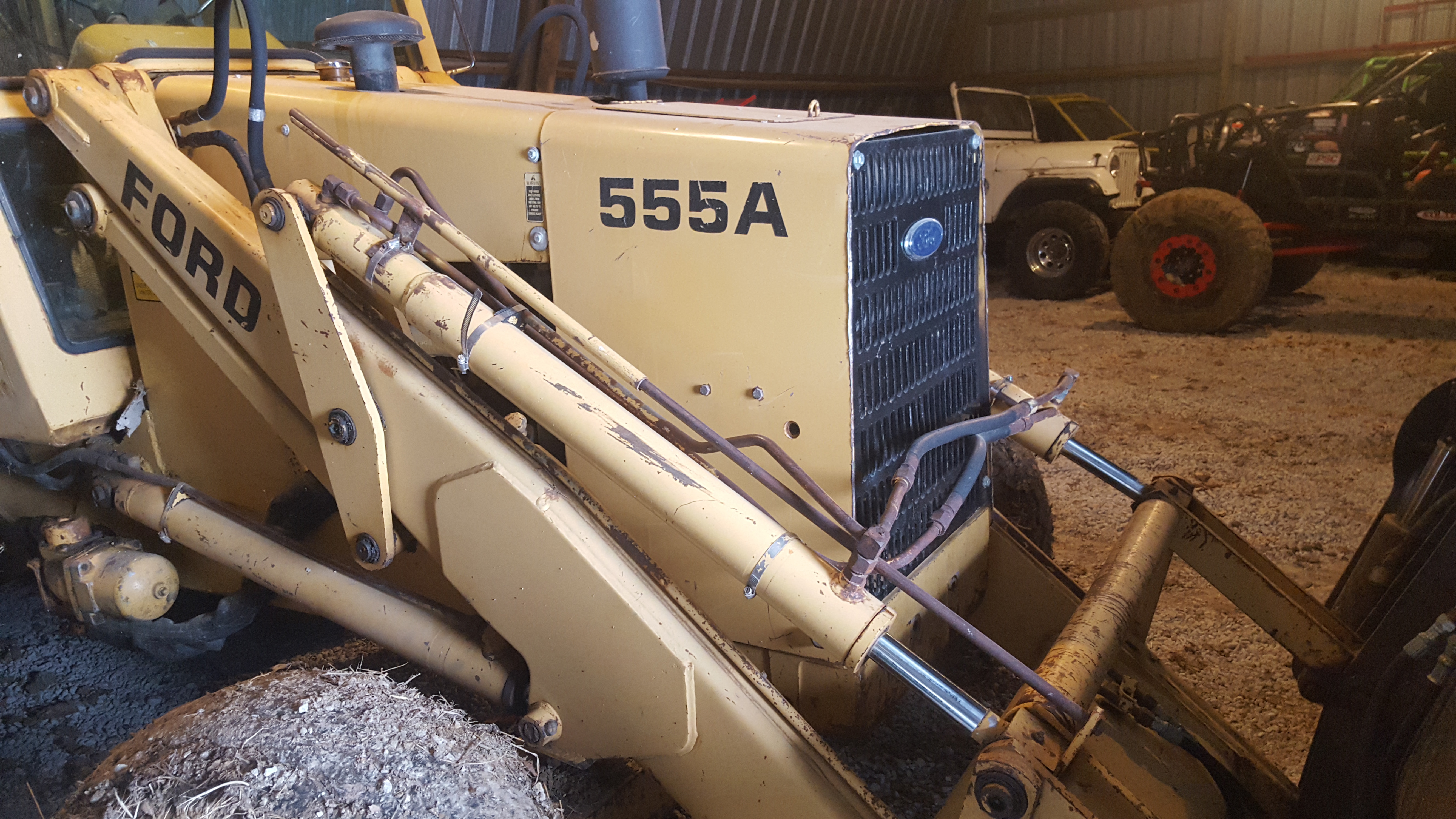

My Ford uses a rod sliding thru a tube. End of rod at tube end equals level.
With rod inside tube you sometimes lose track when bucket tipped forward. Rod disappears. I cut off the top half of my tube 3-4" down so I can see the rod coming and know how much forward tip I have.
I prefer the notched rod sliding thru the tab style.

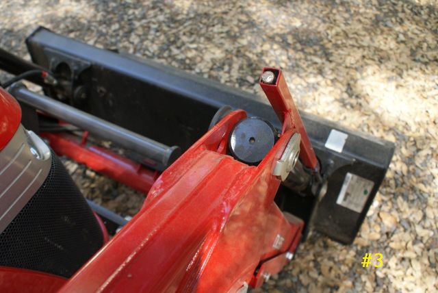

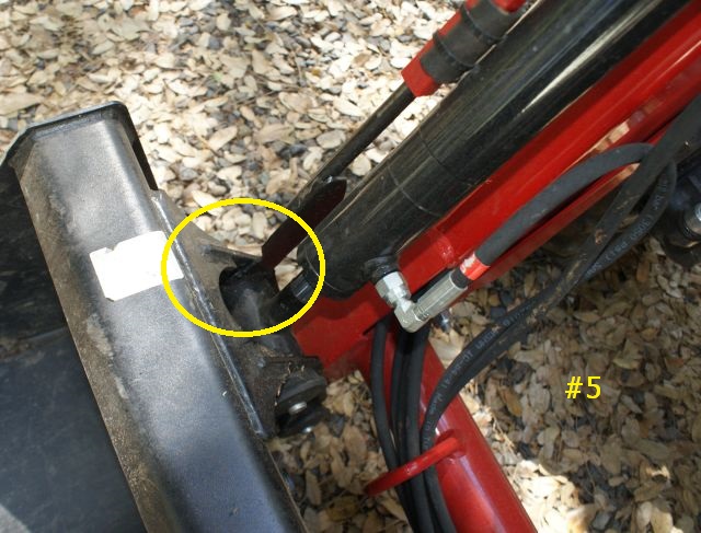

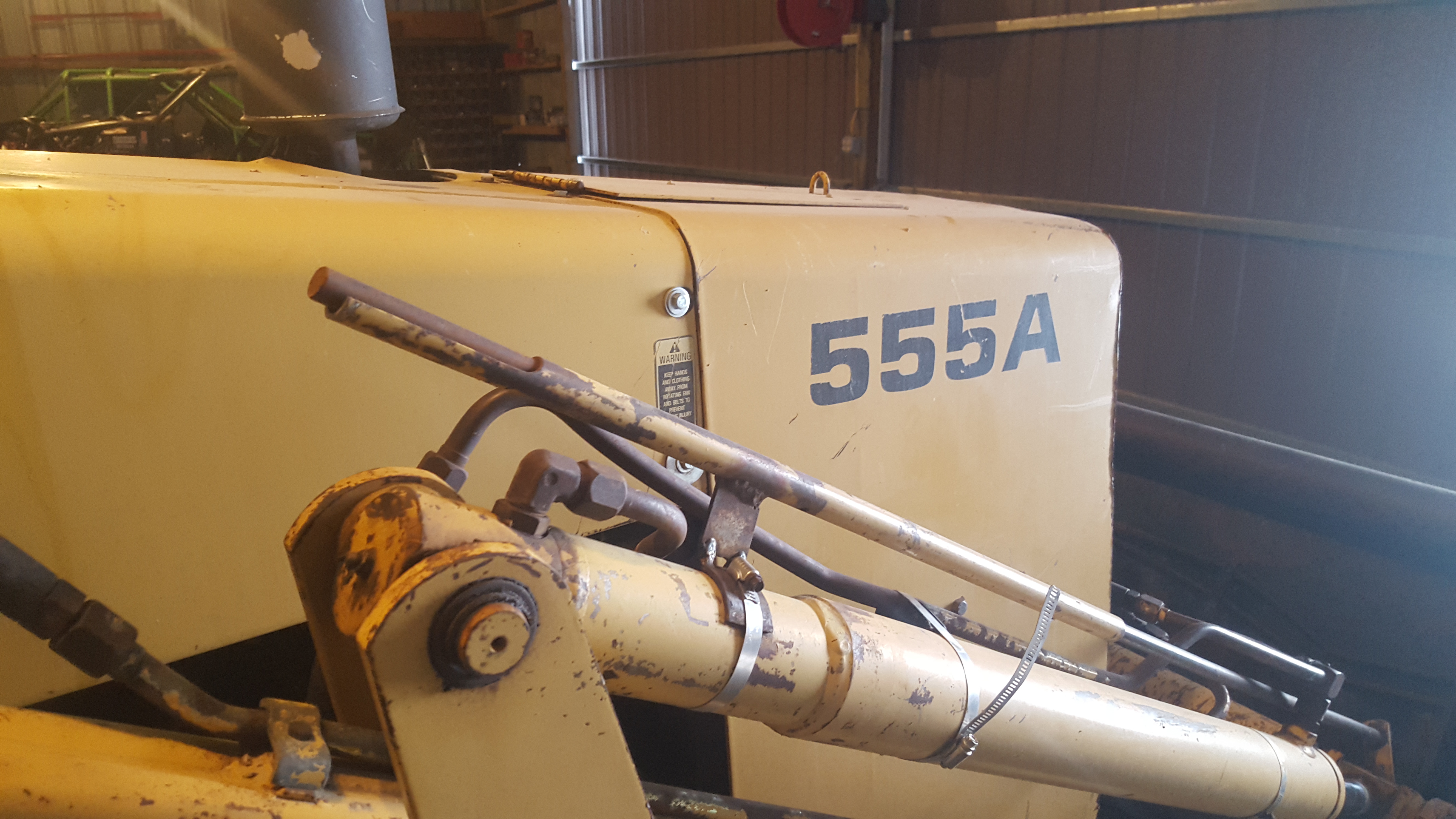

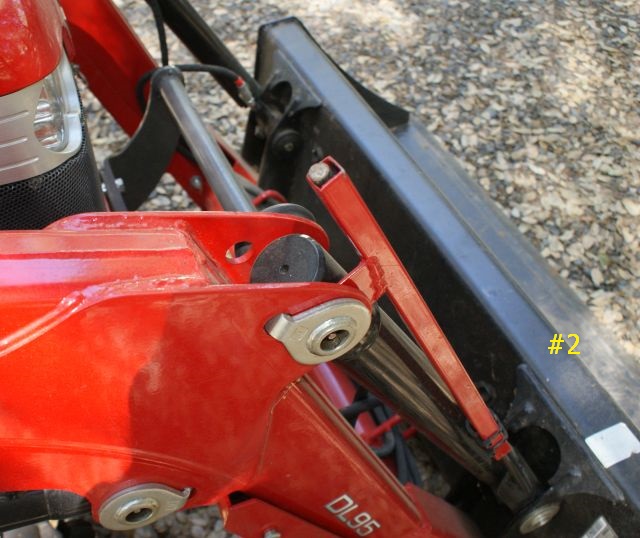

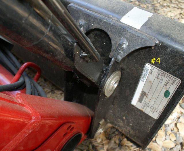

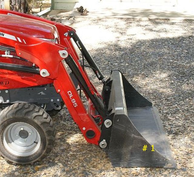

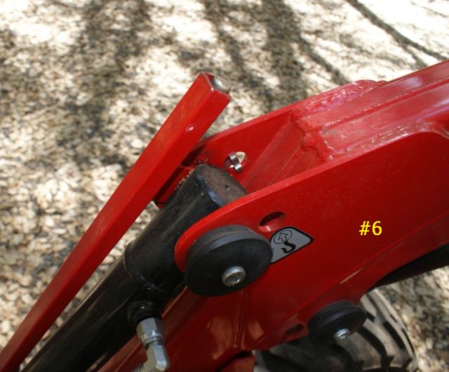

   / Home Brew Bucket Level? #4
This is want I did...
Saw another post where person replaced short bolts to hold pin end cap with long bolts and used lock nut too hold retainer/cover in place and remainder of bolt sticking out to put sleeves on for pivot points instead of doing the large hole thing that goes on pin... Its may or may not be valid depending on how loader pins are retained...
On mine when rod is even with end of tube, bucket is "level" also be sure rod sleeve combination is long enough so rod does not pull out of sleeve in "full dump"
Also might try search string "Loader Level Indicator" seems to have several good responses...

I prefer the open style. Create a "notch" of some kind in the rod. Don't depend on a painted mark for level, it disappears to quickly.
So...…
At the lower end the rod is usually attached to the curl cylinder pin. That could be substituted by fastening it to the FEL frame as near as possible to said pin. Remember it has to swivel to allow for bucket curl.
At the upper end you can build whatever style of indicator you choose. It can also be fastened to the FEL frame as close to the curl cylinder barrel pin as possible. On my Ford the upper end is clamped to the cylinder barrel using a large hose clamp.
Don't forget Dale's comment about making the rod long enough that it can't escape the indicator you choose.
Also, whatever you design, it has to be adjustable. On my Kubota that's done by lengthening/shortening the rod with a set bolt. On my Ford that's done by sliding the tube up/down the cylinder barrel.
With the comments already offered, and studying the pics, it'll come to you. Don't overthink this. It's very, very simple.

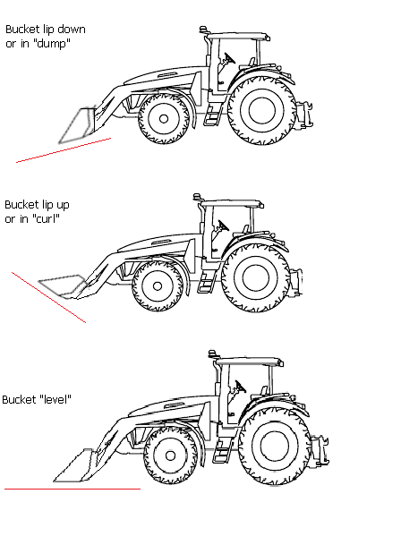

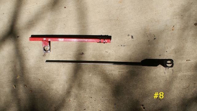

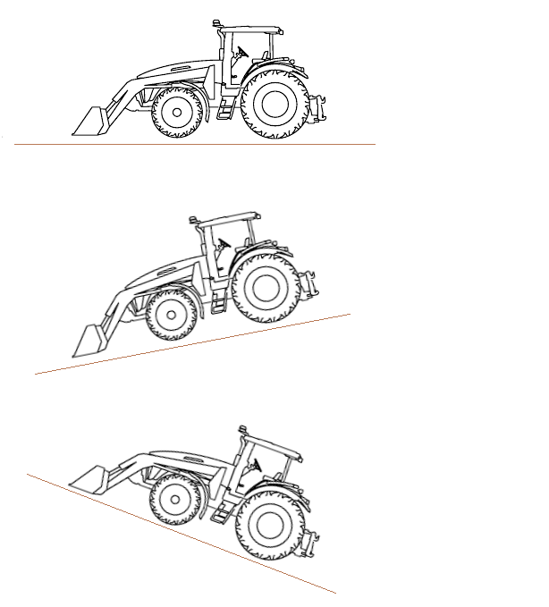

Take a piece of PVC tubing... Slide a broom handle into it..... Move end of broom handle in/out as if it were connected to a rotating journal of a crank..... Sort of like piston + connecting rod / cylinder / crankshaft... The curl/dump hydraulic ram pin (at bucket) is the "crank journal"
On mine after initial assembly, I put bucket flat on concrete apron so on same plane as tractor (level) and cut rod at end of tube when rod is even with end of tube bucket is level no matter what angle tractor is at (second pic)....
Last and most critical, make it so it can be easily seen (at a glance) above FEL frame or tractor hood....If you can't see it, its worthless....
