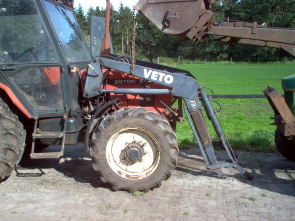

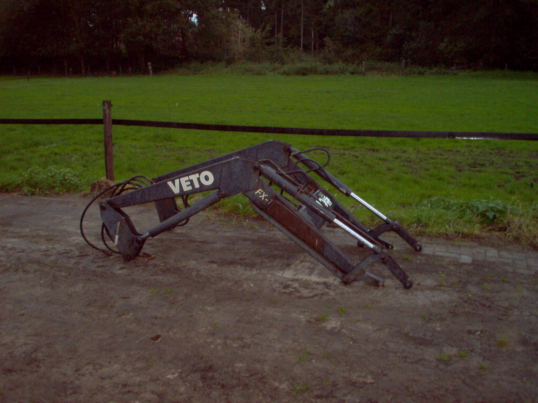

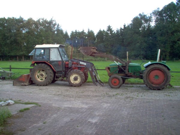

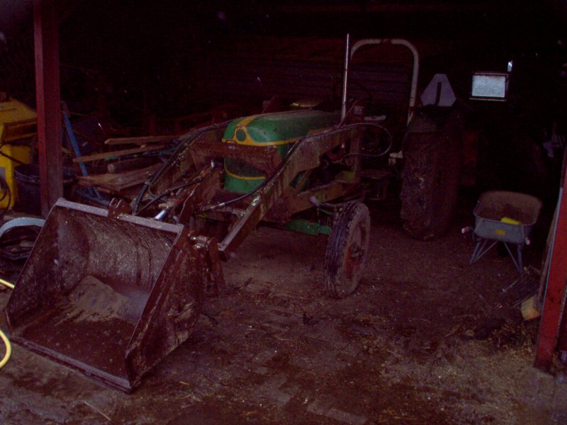

I think it's my turn to share some project photos:
My brother had an old Deutz, a D50 built in 1964 somewhere, no powersteering, no 4wd, with a classic front loader that once started its life on a Ford Major.
After having rebuilt a manure spreader 3 years ago, and using the old Deutz to load her up, i realised that this hard work was not a hobby anymore, it was serious physical labor to turn that Deutz without hydro assist.
My fathers Zetor 5245 did have the MFWD, power assisted steering and the guts to work with a loader.
I went searching on the internet and found a used Veto FX 12 frontloader, it was cracked but the cylinders were o.k. It didnt have an implement carrier frame, tractor mounting frame nor hydraulics.
I bought it for 425 Euro and picked it on a saturday morning, with a friend of mine and my Volvo.
Following photos show the loader right after we took it off the trailer, the loader hung in front of the 5245 just for looks, and a picture showing the old Deutz with loader, just to compare.

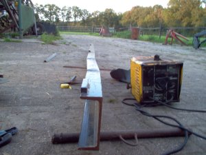

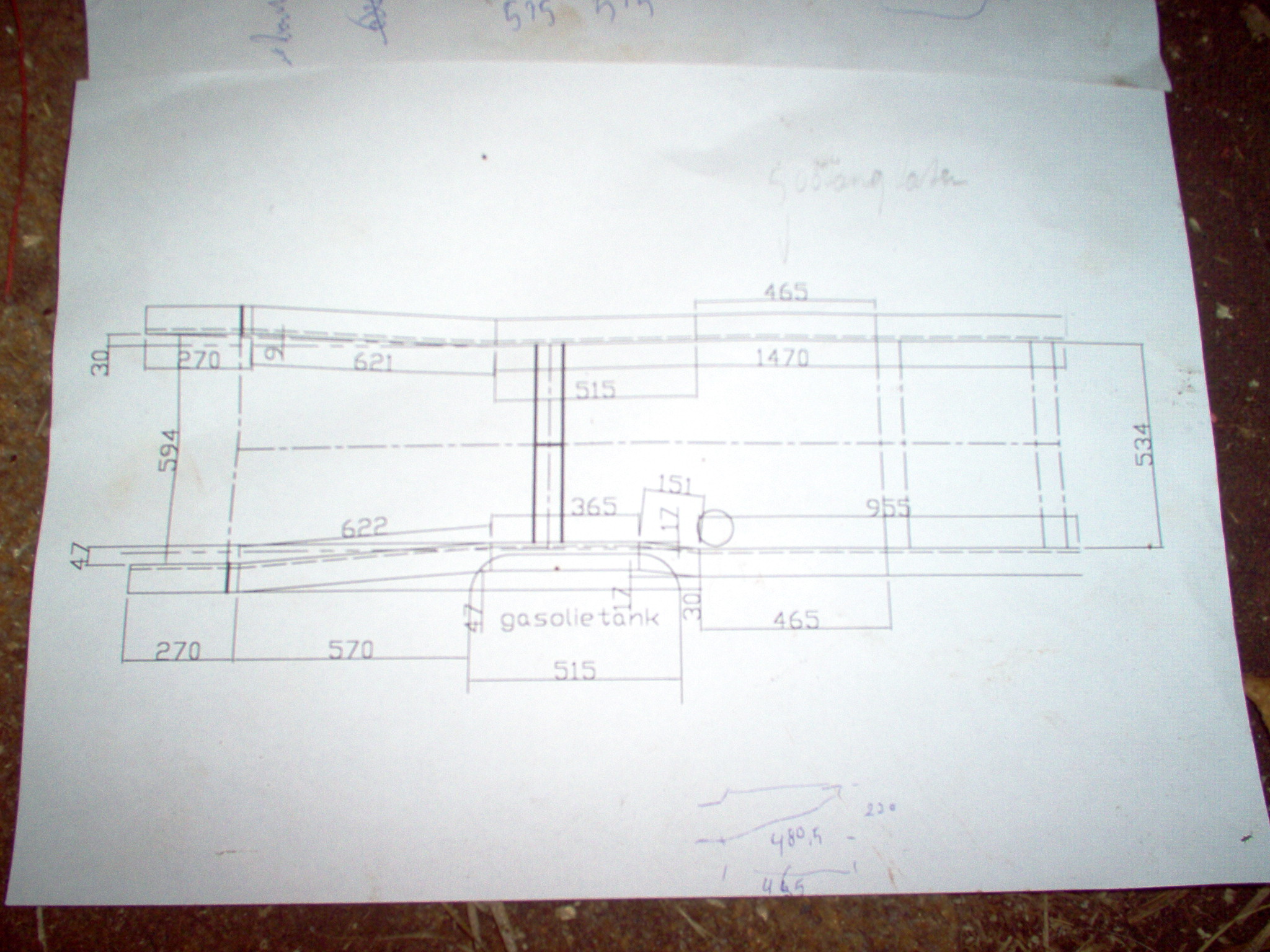

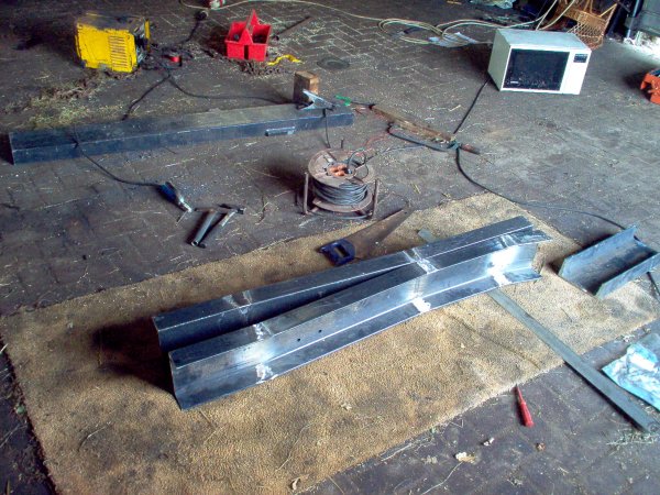

I had about 10 meters of UNP 180 beams around, i scavenged those from a scrapbin of the company i worked and had them in the barn for a year, just in case i might need them... well, i needed them when i started the front loader..
I started thinking and measuring, making an autocad drawing of the rear axle trumpets, fuel tank, cab support bar, and the mounting bolts on the front end. I also checked if it would clear the hydro assist steerign cylinder and front wheels.
Then i started bending the beams, i needed 30 mm offset because the rear axle housing is wider than the front end. It also needed an extra bend to clear the fuel tank which is mounted under the cab.
I decided to bend it Redneck style, by just driving over it with a tractor...
Photos show the drawing, and the axle bars for lateral stability

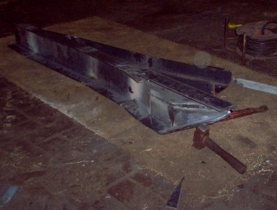

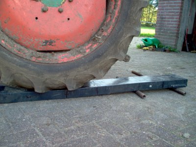

Next photos show the axle bars near completion, they rise 4 centimeter to clear thecab suppoort bar, which is a 78 mm round bar. I welded cups underneath them and put a clamp over them, tightened with 2 M14 bolts on each side.
Then the main consoles, torched out of 25 mm (1 inch) steel sheet, this was done on the cutting table of the same former employer who donated the steel beams.

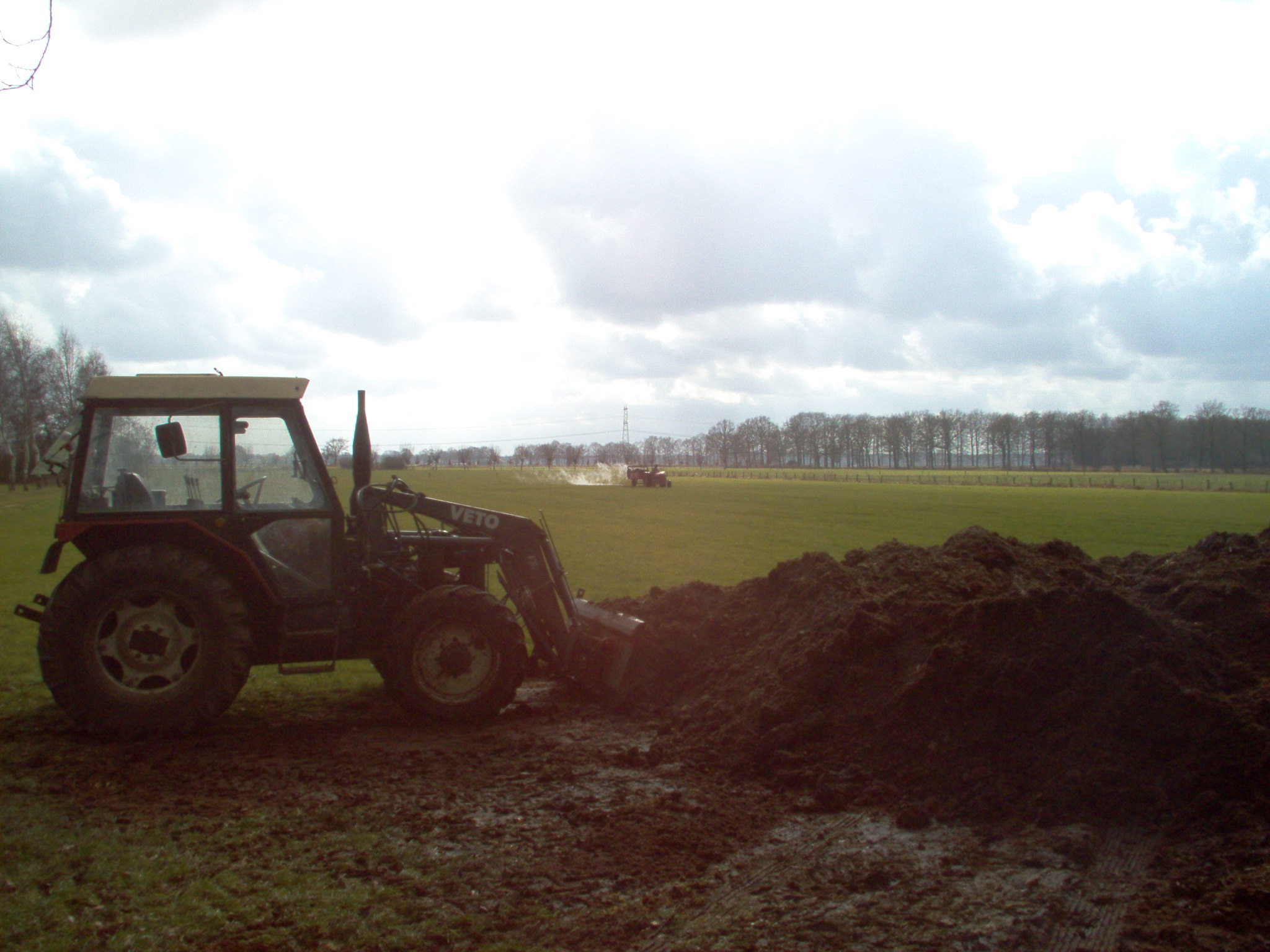

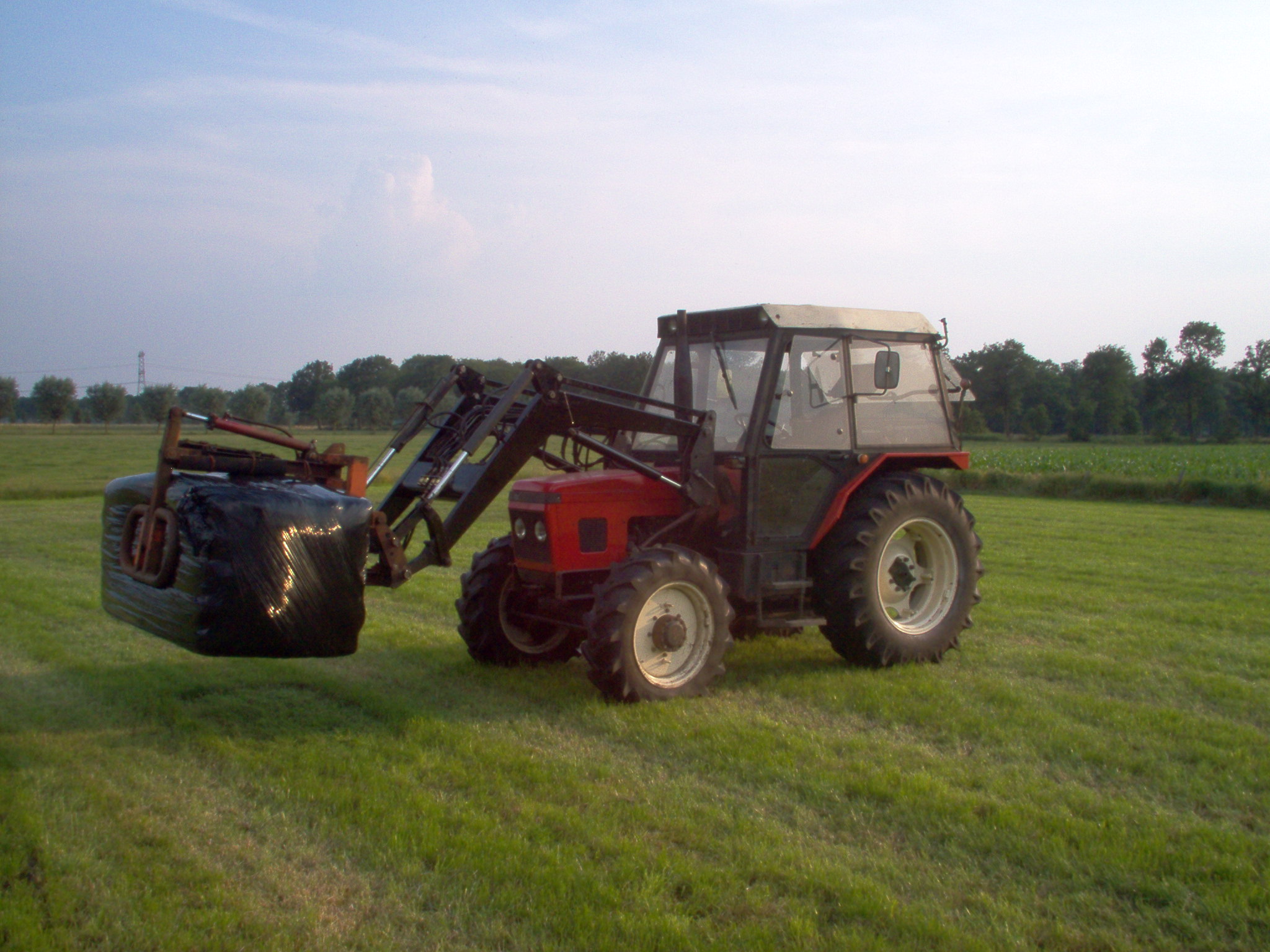

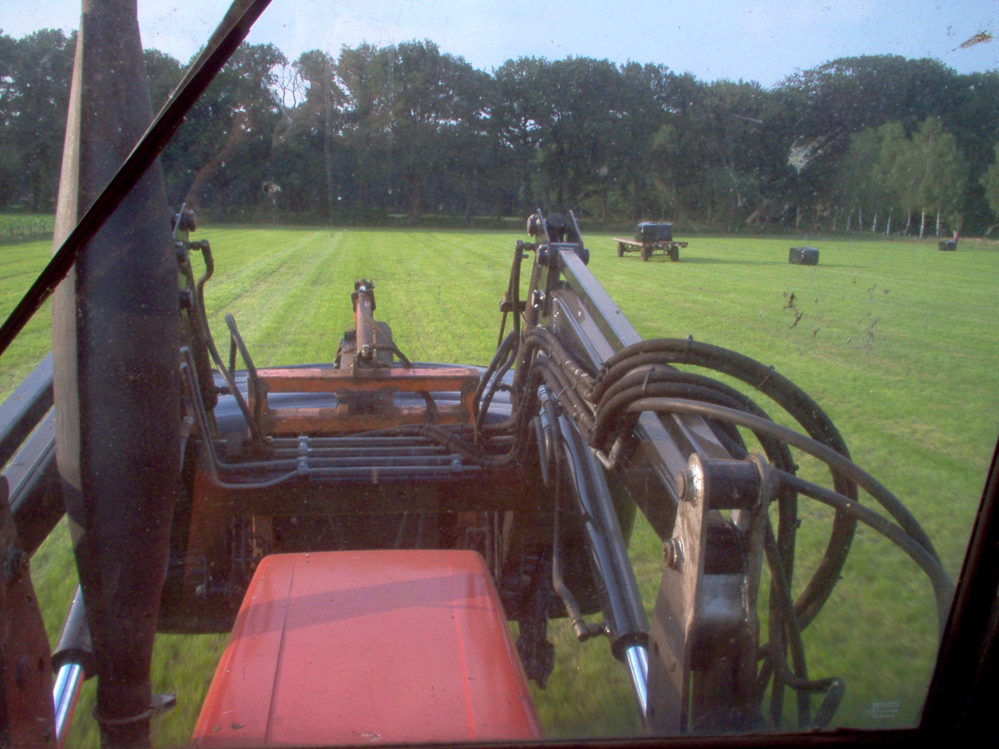

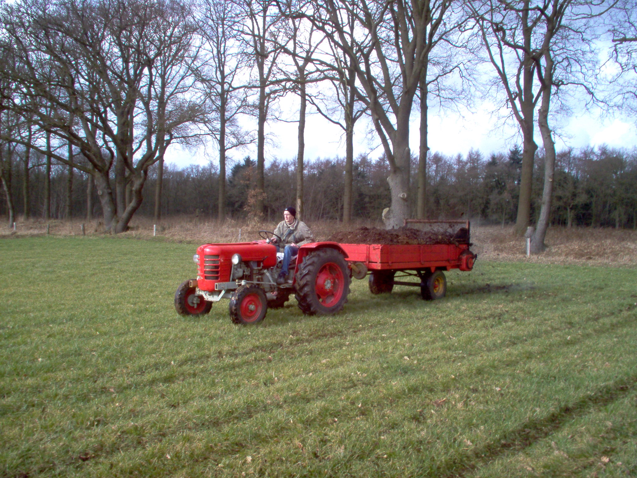

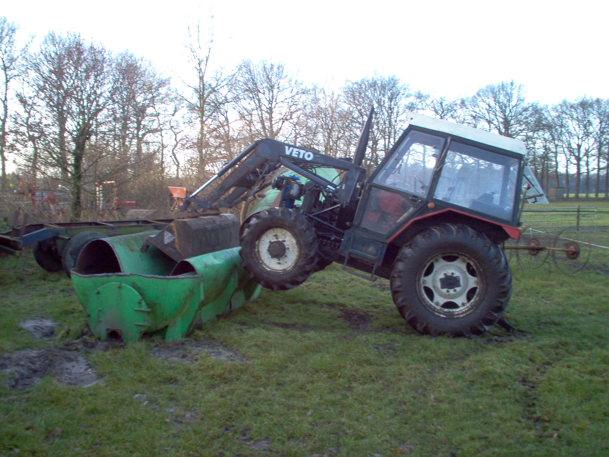

The next photos show the half finished result: I didnt allways have time to work on it, but i did need the loader to take wrapped haylage bales off the stack with the spikes.
First photo is the loader mounted on the 5245, the tractor has no sheetmetal on, i overhauled the cylinder heads that winter and didnt want to put the sheetmetal back on untill it had a lick of fresh paint..
The downforce of it was tested here, wrapping up an old rotten manure tanker we've cut to pieces.
second photo shows it spreading manure, i have added an extra bracket on top of the console here, for the future parallel linkage.
Second photo shows partly finished loader, you can see i added an axtra bracket on top of the loader consoles, to mount the future parallel linkage.
third photo shows it with the parallel linkage finished, and the loader painted black. The home built bale clamp is attached, to stack wrapped haylage on the wagon.
4th picture is a side view of the repainted tractor and partly painted front loader, holding a bale in the clamp.
5th picture is another photo of my brother on the 1965 Zetor 2011 pulling my 3 ton Schuitemaker spreader, also from the late 60's, which i rebuilt 3 years ago and put new oak wood floor and sides on.
