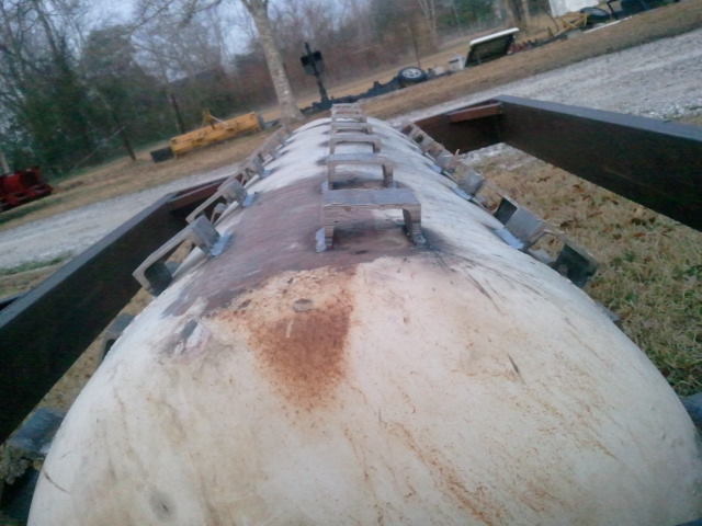

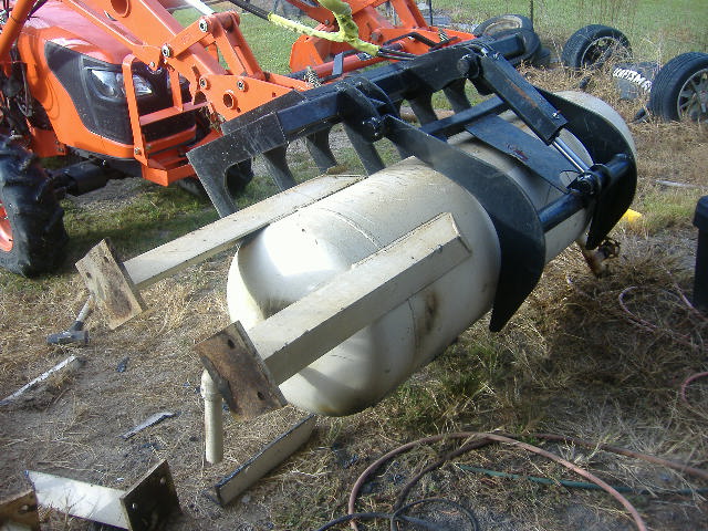

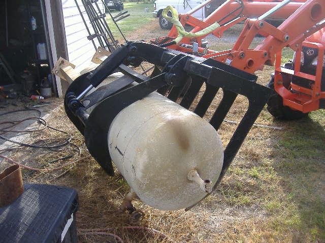

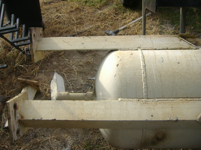

I just finished a sheepsfoot, haven't used it yet but will next month and can tell you how it worked.
I started with this.

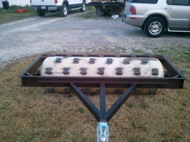

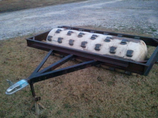

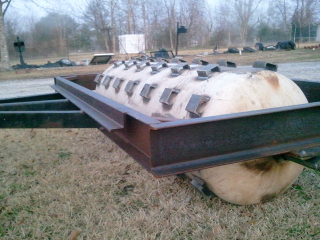

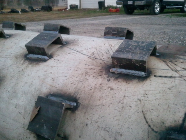

And finished with this. The tank is about 7ft wide,and 5/8" thick. Its about 2 1/2ft in dia. I used 3" channel for the feet. 2" round bar for the axle. And 6" channel for the frame.
If you have any questions feel free to ask

Thanks Brian,
Looks good and should do the job.
Question: Do you plan on filling the tank? Water / sand or ??

Yes i put a 1" thread plug in the tank and plan to fill it with water when i get it to my lot. I didn't use sand because i will have to trailer it back and forth from the lot to the house and this way i can take some weight out of it. I think sand would be a better choice as it would weigh a lot more.
Brian

There is no way my tractor would lift it. Exp. If it was filled with water. The fel had a time lifting the tank off the trailer.
