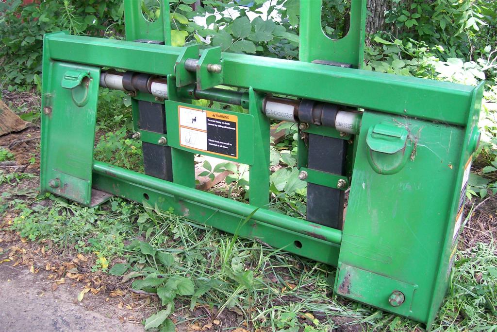

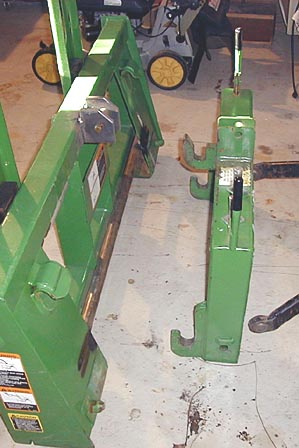

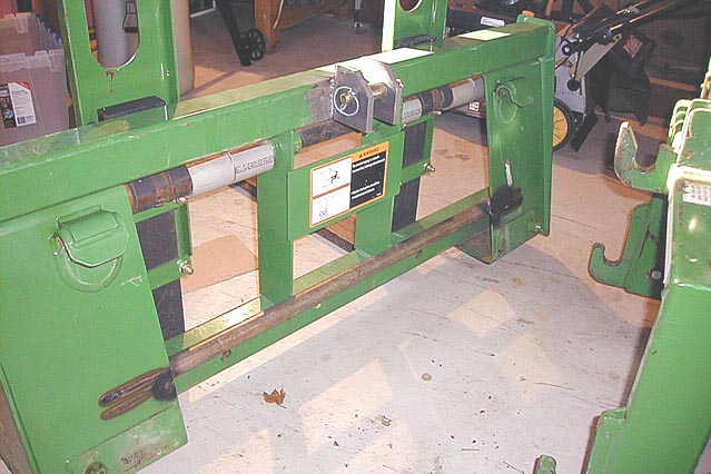

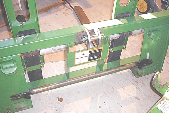

These pics show the solid steel bar (1 1/4" I am sure) welded across the fork frame for the lower hooks of the iMatch and the two steel plates at the top to sandwich the top pin for the upper hook of the iMatch.

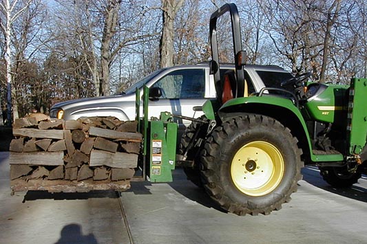

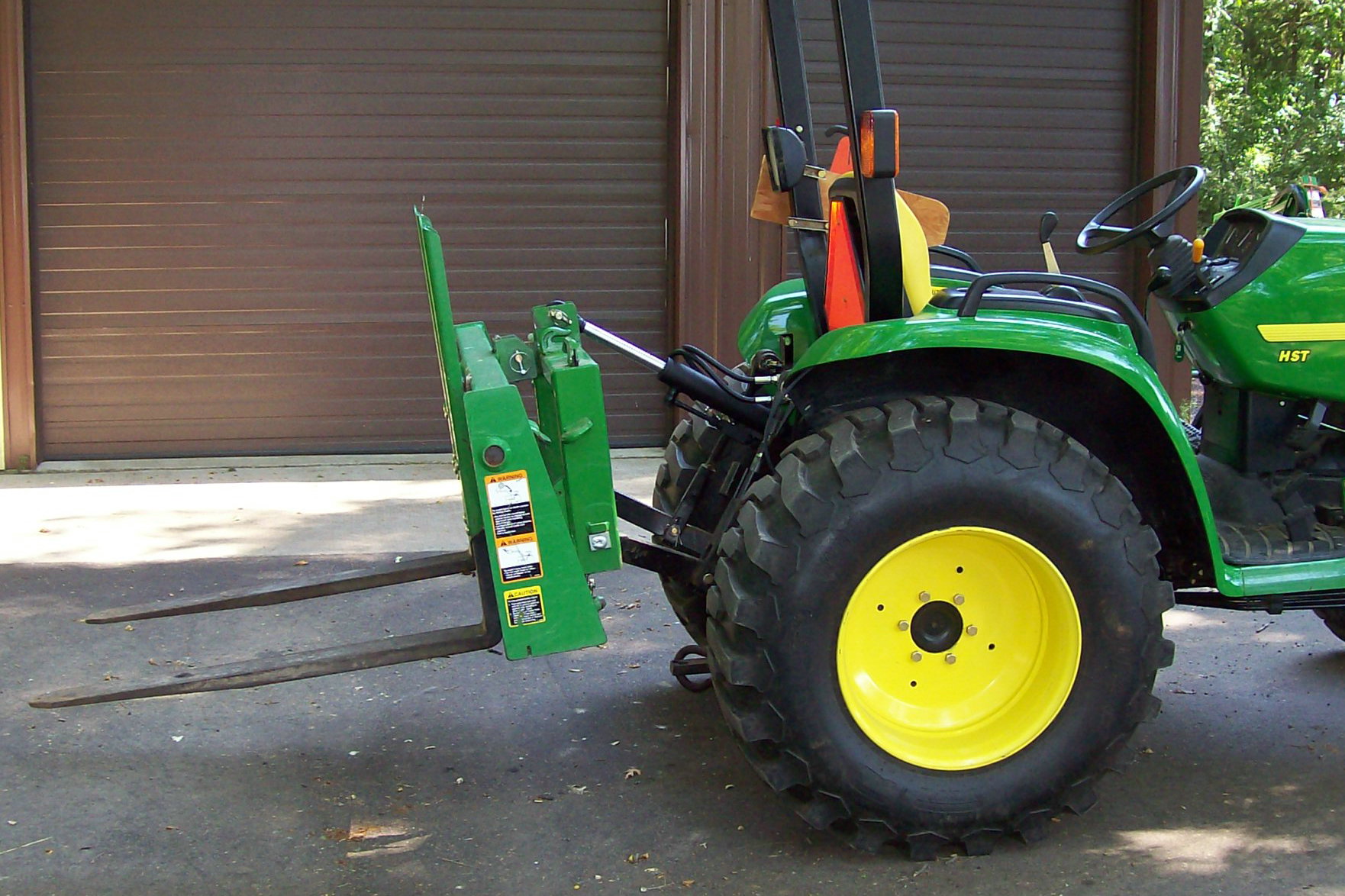

Then with the hyd. top arm, the fork tips can be tilted up/down easily for sliding under a pallet.

Thanks again for all the pics. I see it also hooks up in the front of your tractor.
nutman
   / Home made Forklift #5
Yes, nutman.
It comes from Deere set up to quicktach to the FEL.
