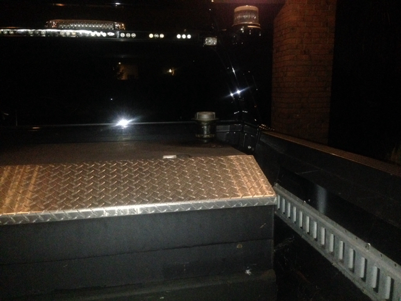

I made one out of 10 gauge steel for my 2008 F150 stepside short box when it was new. Did exactly the way you described. Kept the overall height just below the rear window.
A side view would show the tank itself being 'L' shaped with an integrated short tool box with aluminum checker plate lid.

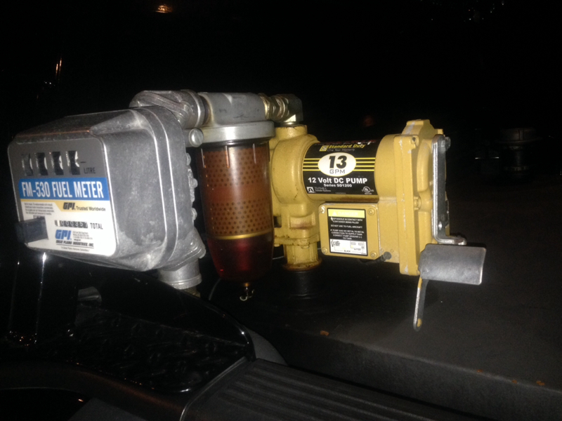

The fuel transfer pump is plugged into a waterproof receptacle with a hidden switch in the bottom corner of the box. It is permanently wired with a relay to the engine compartment.
The tank is flat on top except for the sloped tool box lid.
2x6 fir acts as a 'bumper' on the bottom rearward portion of the toolbox. It can be slipped out easily if another 2" is needed in order to close tailgate for certain loads.
Fuel capacity is about 80 imperial gallons.

Was your transfer system controlled in the cab, or did you have to reach into the truck bed to activate the pump? How did you connect to the main tank, in the filler hose? Would also like to know about filler cap hardware, etc.

Handirifle, the switch is right on the pump. I think it is a one inch hose 20 ft long with auto shut off nozzle. The pump is metered. Th hidden switch is just in case I leave truck unattended for a long period of time. (I never use it). It's just easier than locking it.
The filler cap was an aluminum vented one. I welded a pipe nipple to the tank and used a short coupling to extend the height.

   / Home made in-bed fuel tank #7
Here's a few pics I just took in the dark. If you need better angles or?? I can take for you tomorrow.
Terry
