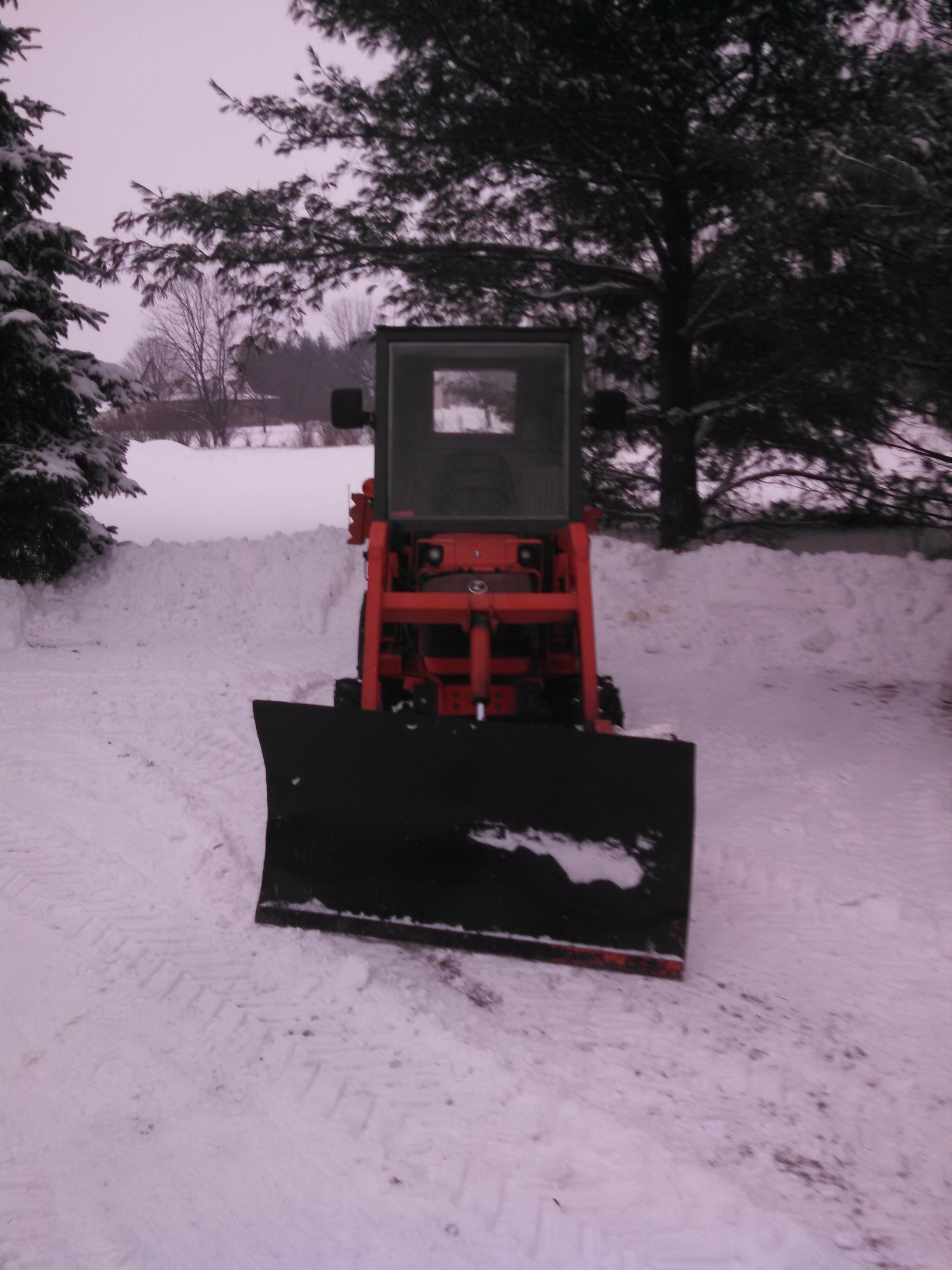

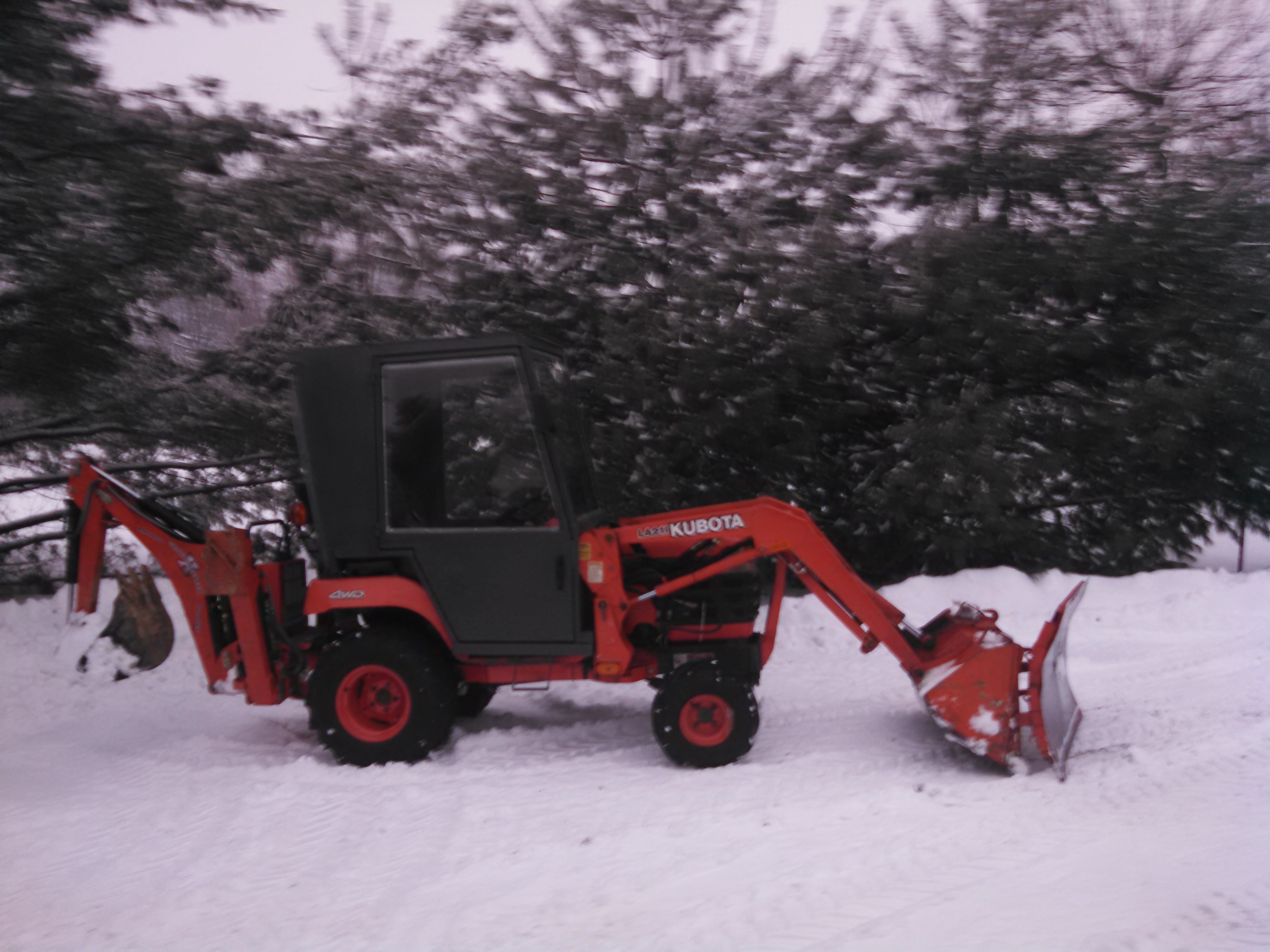

Built this about 3 years ago before i built the cab.

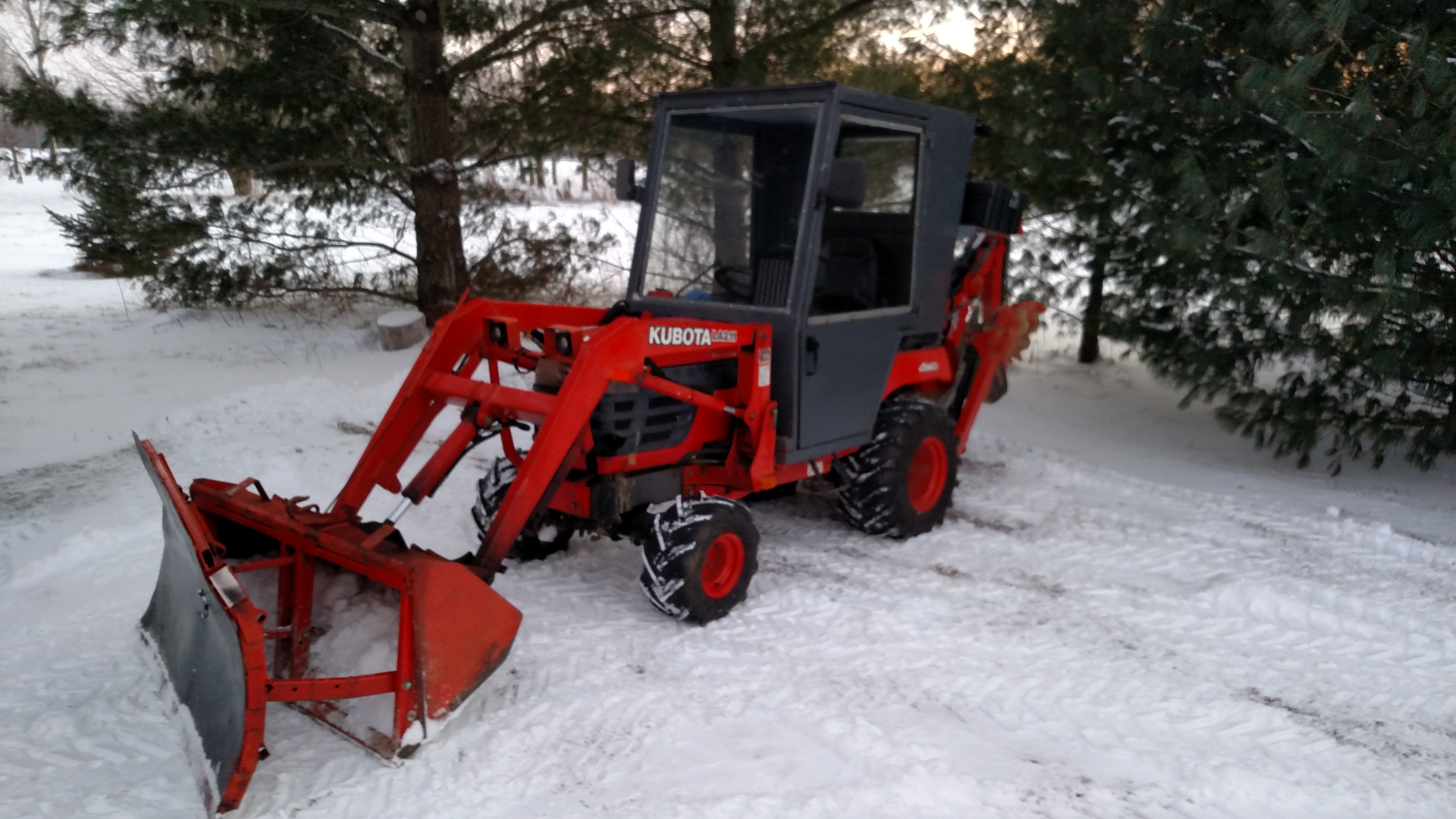

Make sure you have a plan for when it hits an immovable object. Most have some kind of spring loaded trip mechanism. Otherwise you can bend a loader arm.
   / Home made Snow plow blade #3

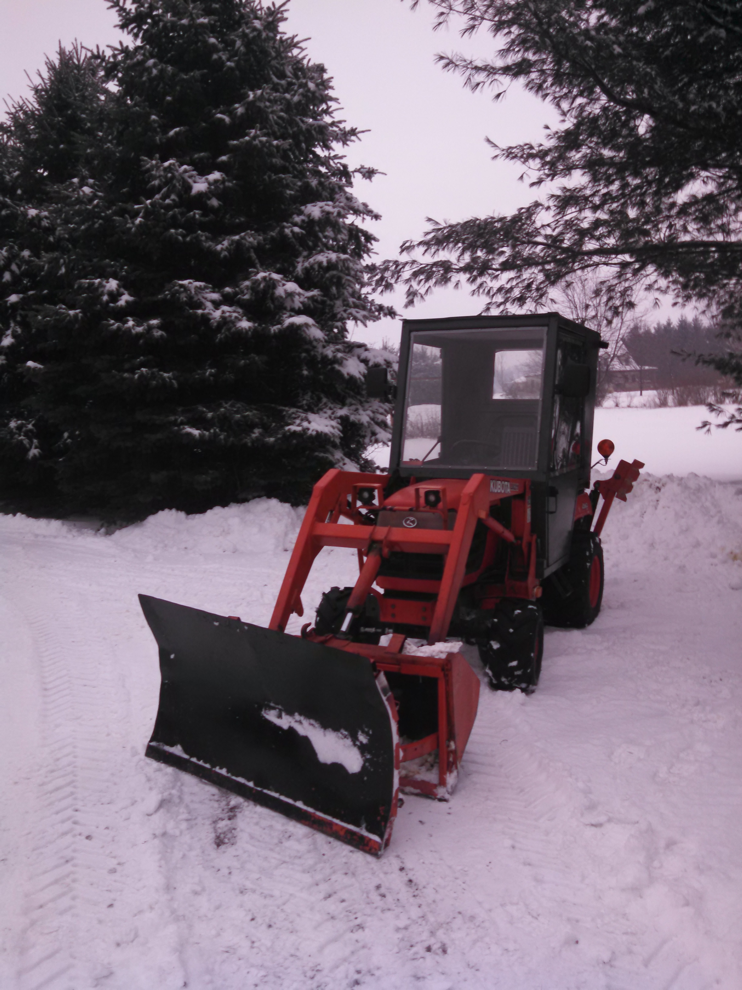

Do you pics how attach to bucket?
Travelover, I do , i used rubber bushings and two aluminum sheer pints that are mounted to the attachment into the bucket. Thomas I believe I do have some pics that i can upload of how it attaches to the bucket/blade if not I will snap a few for you , i designed the bucket fram out of 1x2 1/8 wall with some flat stock to rest against the front top, leading edge and it is bolted to the top and sides of the bucket
I just looked and found a few on my phone
