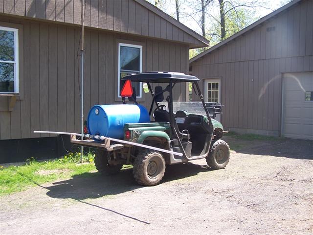

   / home made sprayer??? #9
If you are just going to water,why do you need a pump.I use a 55 gal.drum and a gravity system on the rhino.$20.00 worth of plastic pipe and a free drum.I am going to build a similar set-up for round-up with a pump.
