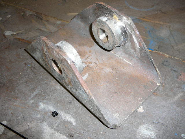

   / Home made thumb for mini excavator
OK,
Some pics as promised.
These first two pics show the mounting brackets. The main pivot bracket needs to resist torsional forces as well, so I incorporated these bracing blocks into the walls. They're only tacked in place at the moment for positioning.
The other bracket is only for pining the unit in closed position, so only a bushing for it.
When I have them pinned in place, I run the hole arbor down through them to ream out evenly. Works a treat.
