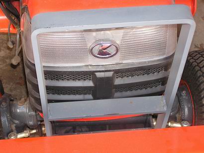

Hi all,
I recently broke out the grill on my BX2230 with a log that fell from the FEL. I have ordered the replacement parts for the grill, and have decided that a grill guard is in order. I would buy one, but they're expensive and I'd rather weld up my own.
Does anyone have any thoughts/experiences/pictures of what they've done or seen done with grill guards?

Here's one I made from what I had on hand.

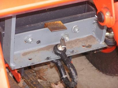

   / Homebrew Grill Guard #4
Second pic of lower part.
Don't pay no attention to the impromptu spacer. I'll correct the close tolerances later.

Ron,
Thanks for the pics. I had planned on using flat plate for the bottom, but I like your use of the angle with the shackle. What are the dimensions of your parts? I have some 1/4"x2 1/2" bar for the uprights and some 1/4" wall 1 1/2" diameter tubing for the crossbars.
   / Homebrew Grill Guard #6
I think the bar is 1/2 x 2 and the angle at the bottom is 3x3x3/8"
It's what I had on hand. I haven't tested it yet, but hope it is strong enough to protect the grill.

   / Homebrew Grill Guard #9
Ron,
How did you manage to get those nice bends on that ½" steel? Did you have to heat it? Use a press or a brake?
   / Homebrew Grill Guard #10
Ok I wish I had a press brake. I drool over those, but at $5K for a cheapy one, I use the old stand by oxy acetelene rosebud with the iron in a vise.
I've done enough iron stuff to try to learn to control the runout. I made the bends, checking with a square to get them close, and let the runout show up on the legs.
Then I cut the legs to length so it would look nice and square.
Still pondering whether to fab a big "R" to put on the cross piece to personalize my tractor......................
HAve fun,
ron
