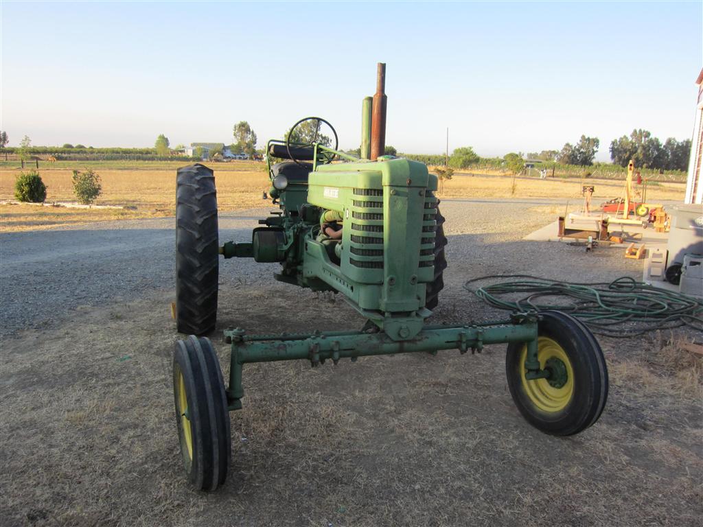

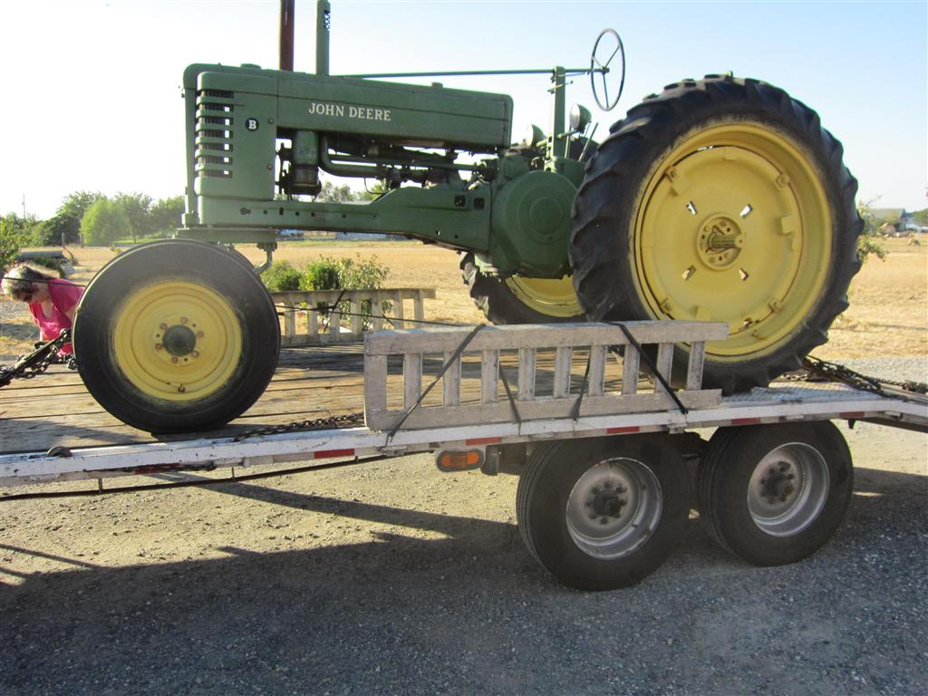

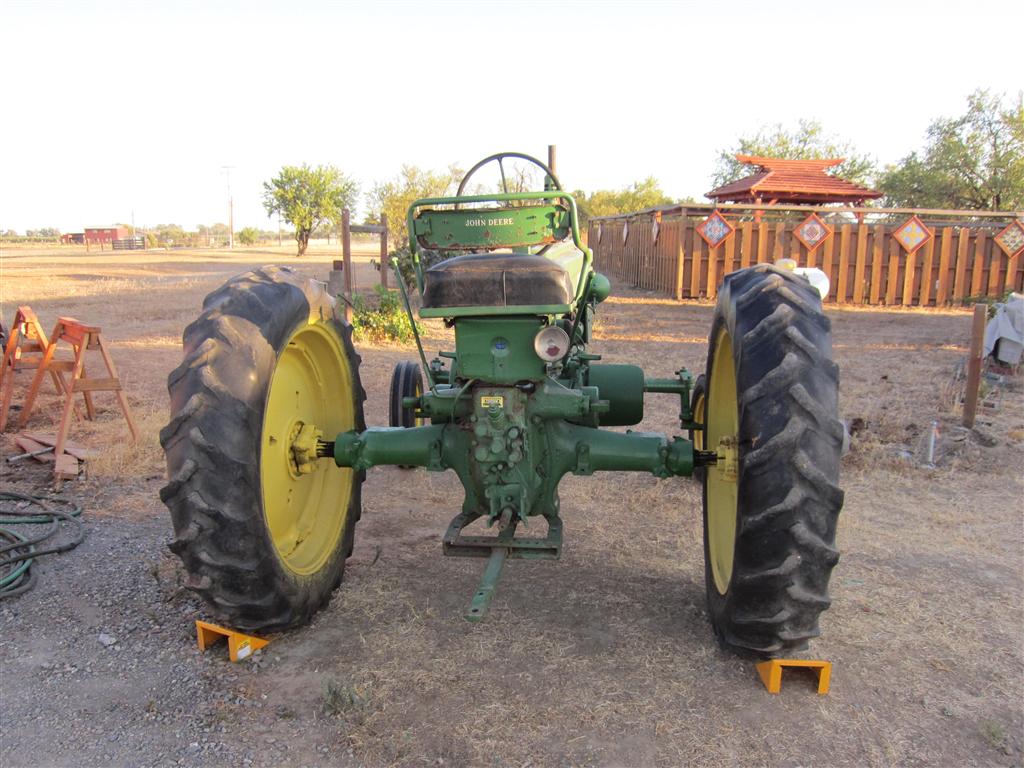

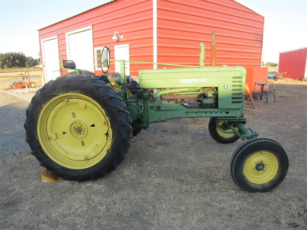

One of my "old" tractors was a 1948 JD B wide front--2 cylinder Johnny Popper.
You sat so high on the B you'd get a nosebleed.
