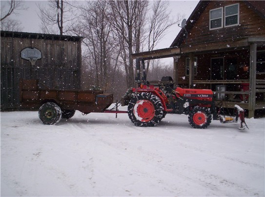

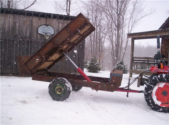

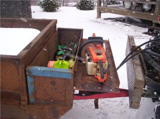

here are some pictures of a dump trailer i built this winter. the axle is from a horse trailer and all the steel is from a buddy who gets it as scrap for me. the bed is 4'x 8' and 12"h the cylinder is 4"bore double acting. i figure i can haul 2 ton on it . hinged the gate at 24" high so firewood wouldnt get hung up. it works great for firewood. also made a toolbox on the front and the lid when open makes a good table to work on chain saws. gate uses pin to keep closed but i am going to put a double latch system like on a dump truck & hook it up to open & close by hydraulic cylinder. need to put steel sheet in floor yet and paint when it warms up.

Not bad at all, i like the toolbox it has. Good work.
   / homemade dump trailer #5
Well done and looks good too.
   / homemade dump trailer #6
Nice set up. Tool box is a good idea. Sure like to have one for this spring but I'm just in the scrounging stage of that project.

Nice, how large is that cylinder ? LOOKS huge /forums/images/graemlins/grin.gif Thanks Steven

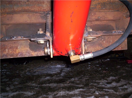

Let's have a look at the lift mechanism and how you mounted the dump cylinder.

Very nice and that is a large looking cylinder!

here are some more pictures of the trailer.
this is where the bottom of cylinder is attached the cylinder is 4" bore 30" stroke 2" rod 1.25" pins 80+lbs.
