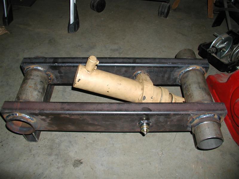

Got a great start on the rake this weekend. I had decided to go with the swing-arm type design. After "sketching it up", and obtaining the trunion-mount cylinder ( the heart of the offset scheme), I made a trip to the junkyard and found a bunch of 2x4, 2x5, 2x6 tubing with 0.188" wall thickness, all for 20 cents a pound. 35 bucks bought all this metal, wow! I milled giant 4 inch holes thru these tubes, and a 1.5 inch hole clear thru for a bushing stock section. After pressing it all together, and tacking it up, it looked like this photo. Also shown is the trunion-mount 3x9 cylinder from Surplus Center, swinging on specially prepped pins in those bushings welded into the tubes. So this important assembly is about complete.

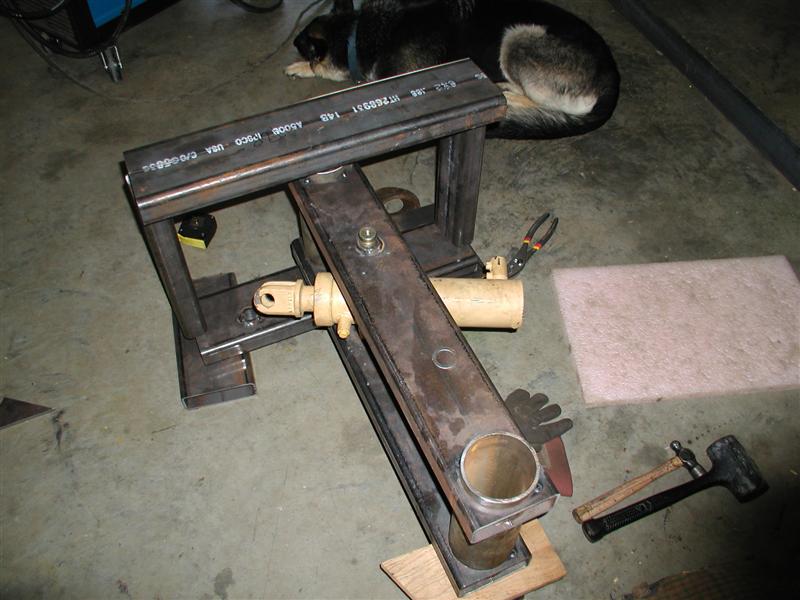

The main frame is shown here, parts are cut to length but nothing is welded yet. Not shown are the plates that the three-point hitch attachment pins stick through. I should maybe explain the "bearing assemblies" that allow the offset and swivel functions. The "axle" part is 3.5 inch pipe, and the "bearing" outer part is 4 inch tubing. There is about 90 thousandths difference between the two diameters, which I feel is too much play in the assembly, so I then add as much galvanized tin flashing material as I can get in there. I was able to get about 60 thousandths worth of tin in there by wrapping it really tight and somehow sliding it together. Once final welding is done, I have a lot of difficulty moving it by hand. I am sure the cylinder will not have any trouble, it has a bit more push than I do. And I added grease zerks so eventually, after paint, there can be some lube added. I have used this method before and it works very well.

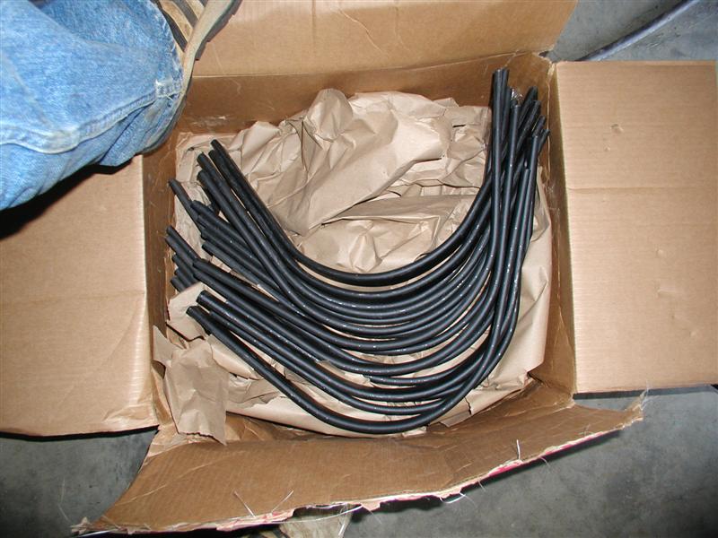

Well, that photo attach didnt work, so here is another attempt. Also, the boxes of tines came from Agri-supply. I opted for the heavy duty ones. 31 tines, for a 78 inch tinebar.

1.25 inches per tine, plus a 1.25 inch spacing between tines, 31 tines total, and then minus one space (31 tines, but only 30 spaces). The tines have 7/16" holes (two holes per tine) so I purchased grade 8, 7/16" x 1.25" x 20 (fine thread) bolts and nylock nuts. The big drill-athon begins tonight.
