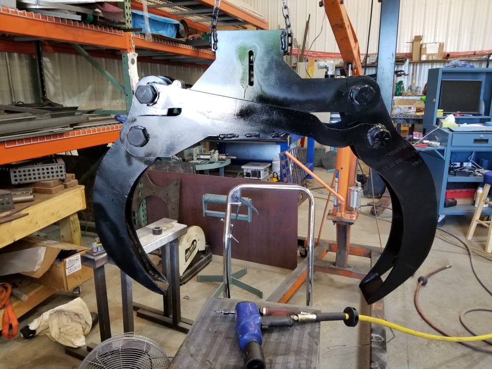

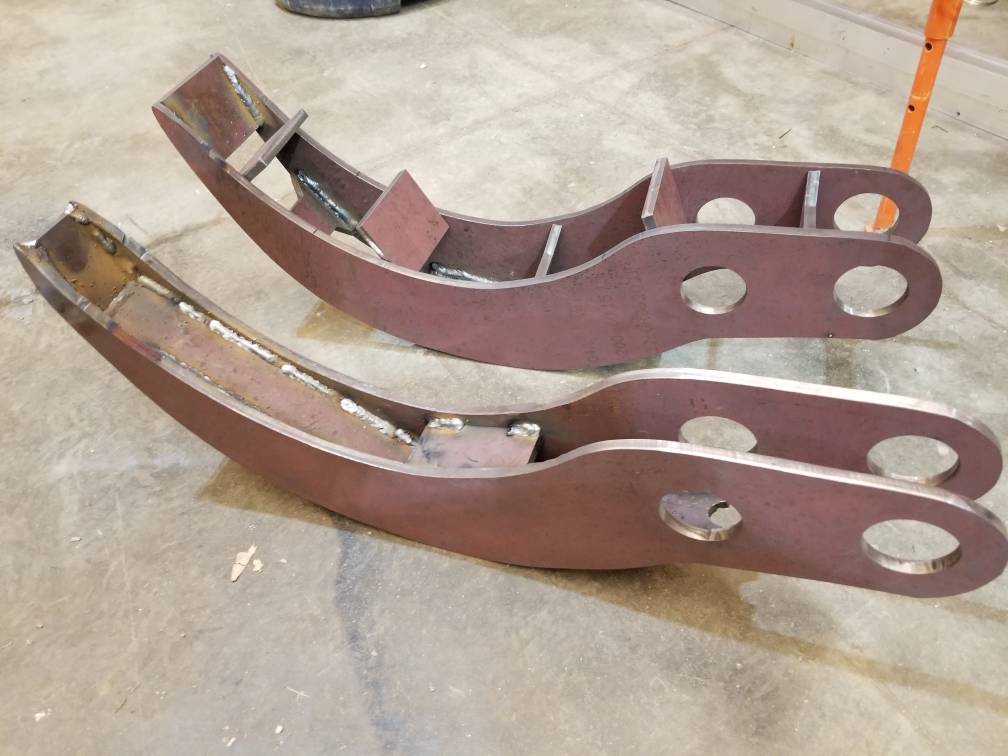

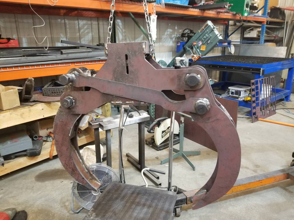

Made this grapple a few weeks ago. Did the drawing in inkscape then used sheet cam to make the machine code for the cutting. Made it out of 3/8 AR steel scrap. Wanting to make a bigger version with longer arms to grab 48 inch and bigger logs.20180707_123219.jpeg20180707_165553.jpeg20180702_094925.jpeg

Might tip the PT425 on its nose! :laughing:
Nice grapple. :thumbsup:
