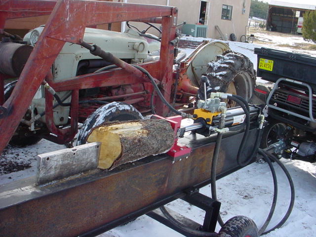

If it's Horizontal only then push the wood into the wedge.
Also excellent advice from above.
Attached are a couple of pictures of my home made splitter if you would like some design ideas. Most all the steel used is 1" thick. The I beam I used is actually 2 I beams from a mobile home trailer tongue welded together side by site to get me the 6" width I wanted. The hydraulic cylinder is 4-1/2" bore x 24" stroke x 1-1/2" rod (25 ton). The valve is from northern tool and is a detent return (auto return). I use the tractor hydraulics to run it with some quick connects. Not shown in the picture because I added later are some log catchers that catch the split wood off the wedge so I don’t have to bend over to pick it up.

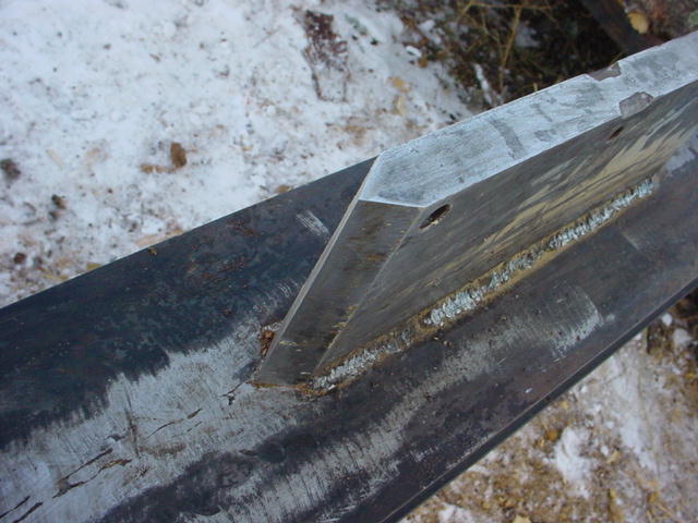

The wedge is made from 1" x 16" cold rolled steel.
The knife edge was made by cutting two 45* on the band saw.
