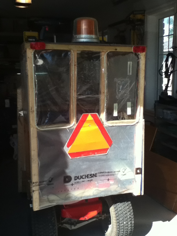

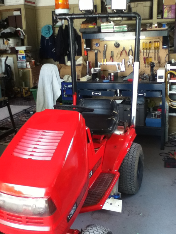

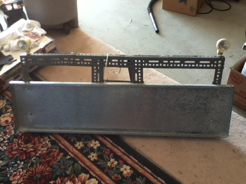

This was my project for the year i originally had a light bar but i decided plowing the driveway would be a lot more comfortable with a cab :p

Looks good but I do not see the HEATER CONTROLS or HEAT VENTS yet?:thumbsup:
   / Homemade snow cab and light bar
Ive been thinking about bring hot air from the motor into the cab or buying a small heater

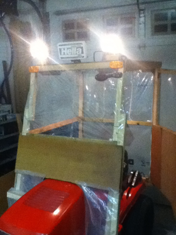

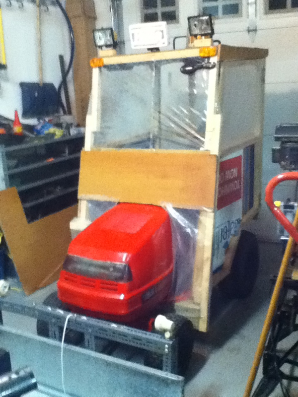

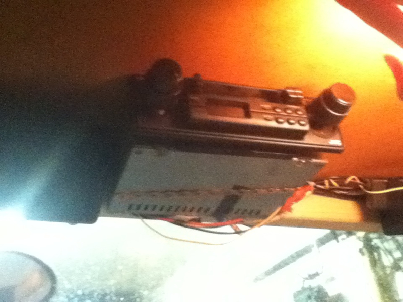

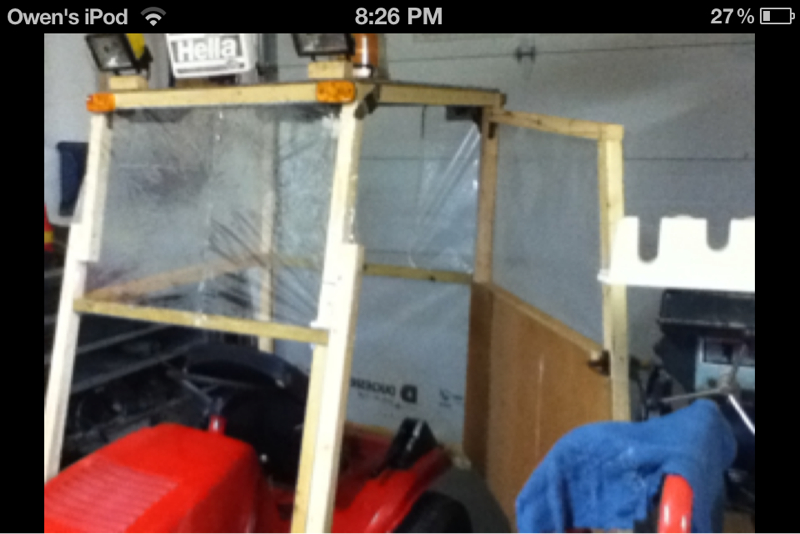

All done and ready for the snow. Thinking about putting on a rear snow blower

Will keep the wind/snow off of you!
You will drain your battery in no time with those lights.
I have an extra battery that can run the lights for 3 + hours
   / Homemade snow cab and light bar #7
Still, that's probably close to 30 amps worth of lights, depending on the bulbs, plus the radio... a second battery is great, as long as you take it out and charge it up when you're done.
Since you're not using a snowblower, you could make a bracket to mount a 60 amp one-wire alternator (cheapie from autozone) on the deck brackets, and run it off the deck PTO.
Im usually using about 7 to 9 amps and I have thought about mounting an alternator before but for now the second battery works great :)

What is that on the front of the tractor in the 3rd picture? Some sort of plow? If you are going to push snow with that it will probably bend up on the first push. That metal is no where near strong enough to push snow. It would never work where I live.
