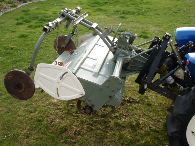

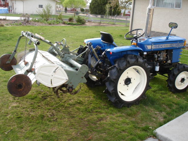

Here's a photo of my Kubota B7510HST (21 hp engine, 17 hp pto) with a used Yanmar RS-1200 rototiller (48" wide, $300 from my local grey market tractor guy).
The pto shaft that came with the tiller was shot so I bought a $75 replacement from Tractor Supply and cut it down to fit.
I also spent another $80 on a slip clutch since the tiller didn't come with one and didn't have shear pins.
Needed a $15 pto extender from TSC so the slip clutch wouldn't interfere with the sheet metal on the top of the tiller.
The lower 3pt arms on the Kubota are only about 26" long. To get the tiller/pto/slip clutch to fit, I had to use the 35" long arms from my MF-135 tractor.
So for under $500 I got a good working tiller at about 1/3 the cost of a new one.

There are a lot of good used Japanese tillers out there (gray market) for $250 to $550. The 3-pt type should be practically a bolt-on for you, maybe some clearance issues you should be able to easily deal with. The lower cost ones are usually 2-pt and you have to fabricate an adapter like I did (2-pt to 3-pt) or modify the tiller like bjr did. My Yanmar 1200 2-pt tiller cost about $350 incl. shipping and the steel for the adapter about $125.

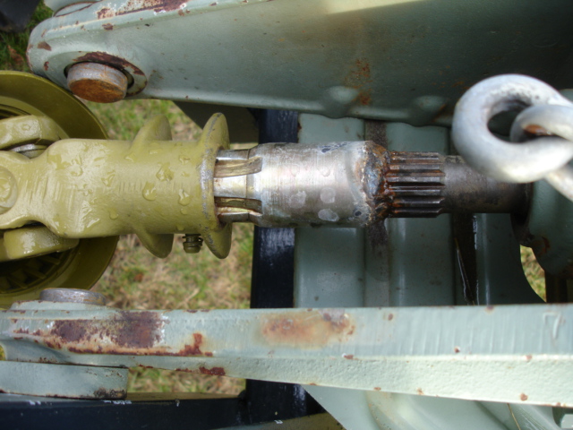

Almos tall the grey market Japanese tillers are CW rotation. I understand there are a few out there for CCW for use on some smaller and older models of (I think) Mitsubishi tractors, but are pretty rare. The main thing to take into consideration on many of the 2-PT tillers (like mine) is that they generally have a 16 or 18 spline metric type PTO shaft (about 30mm) and you have to adapt a std. 1-3/8" 6-spline PTO shaft to it. I used a 1-3/8"M 6-spline X 1"F PTO adapter and had it reamed out to fit the 30mm tiller shaft, and simply welded it to the shaft. Now it's a permanent std 1-3/8" tiller. But you can eliminate all of those adapter problems by just getting a 3-pt grey market tiller, much less hassle. As for where to buy, I found mine on e-Bay and it was located in OK at some equipment company there, can't remember the name.
