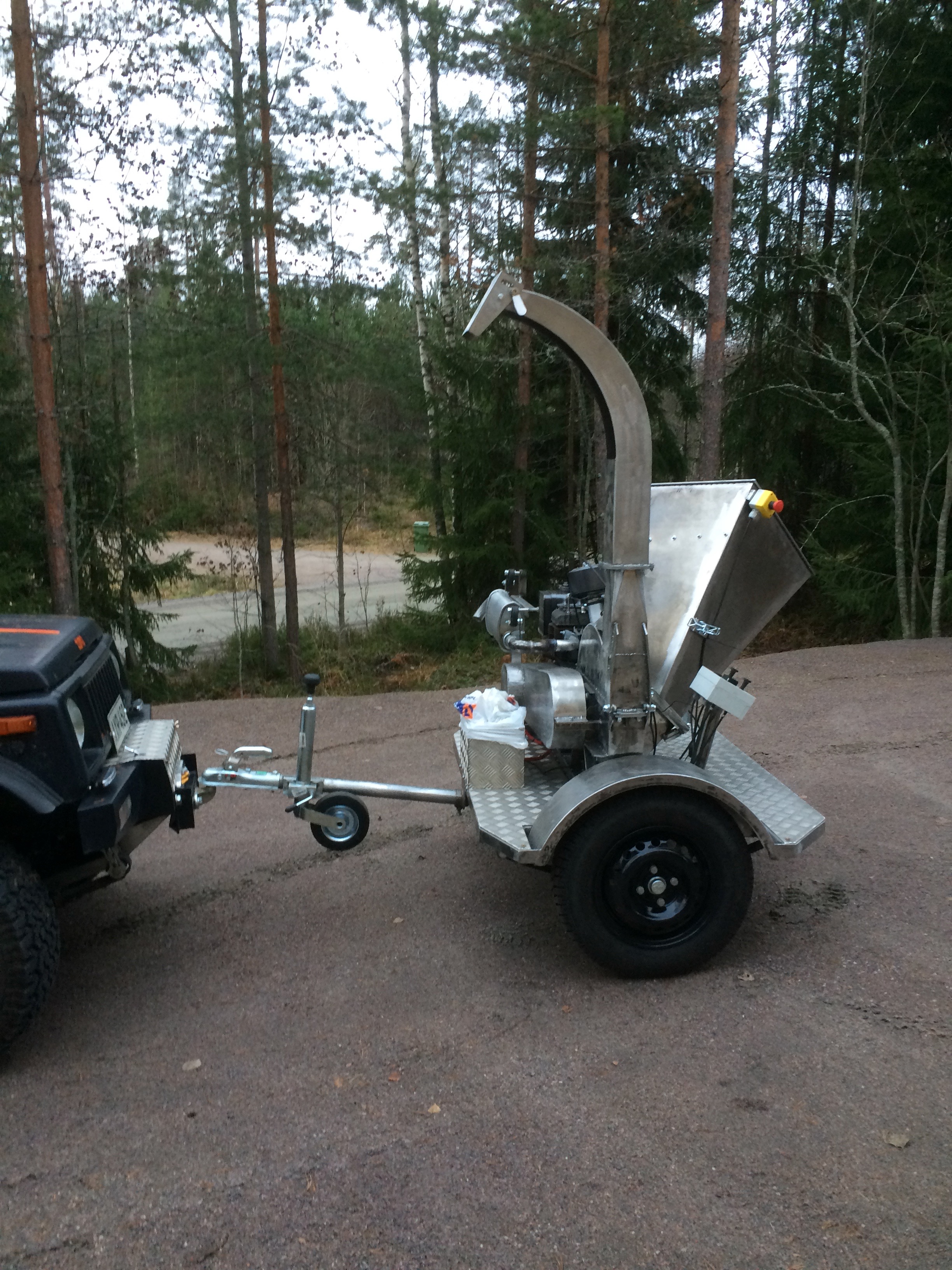

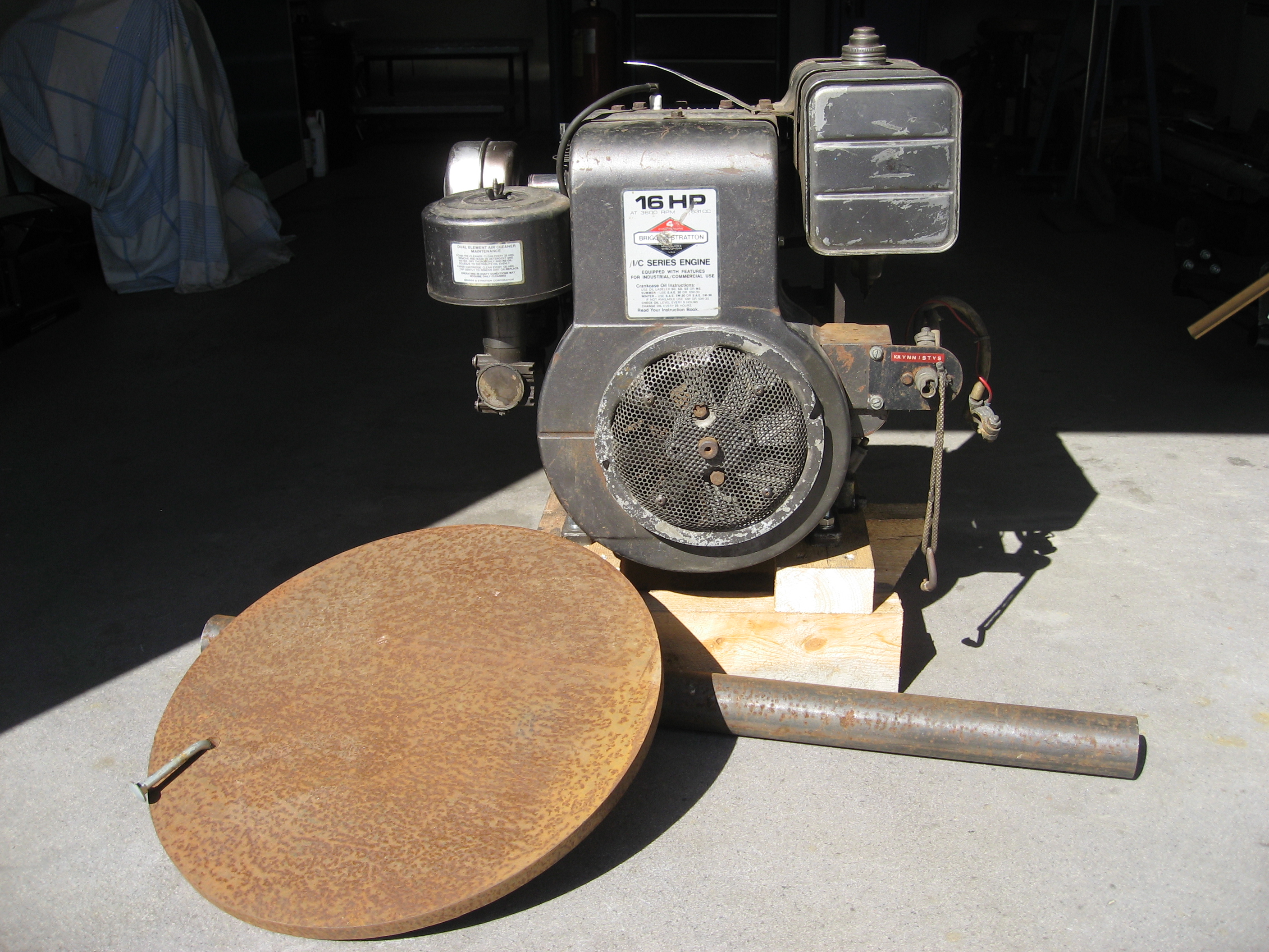

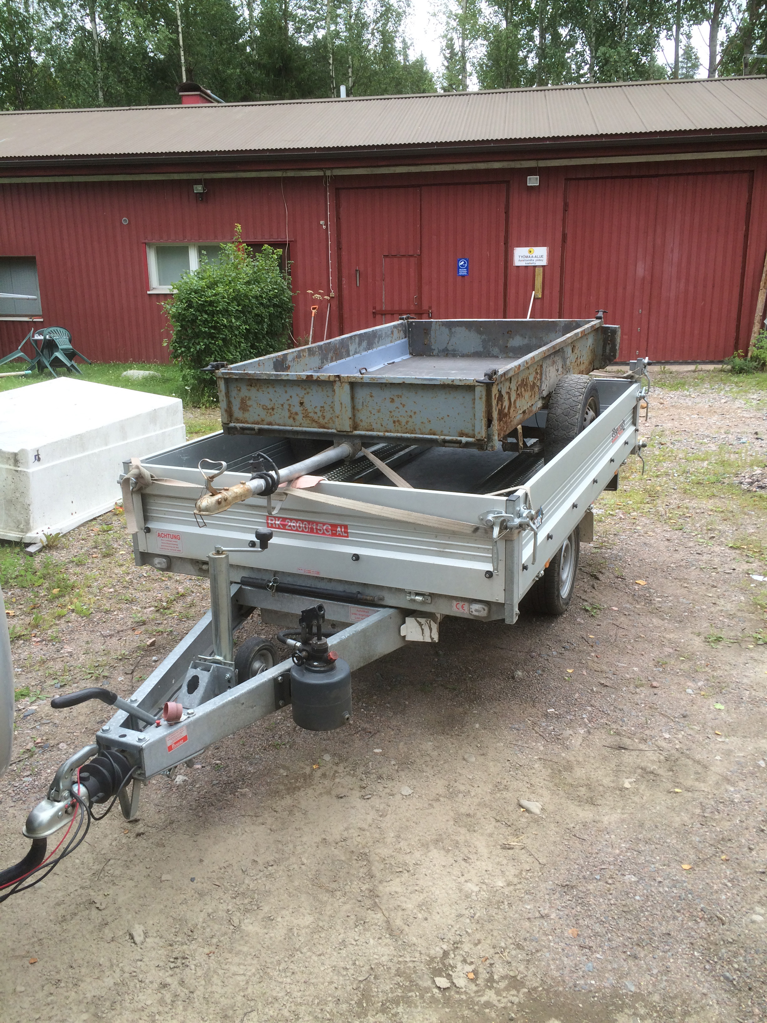

As I every year cut down trees to make about 12 cubic meters of firewood I also get a lot of tree branches laying around on the premises.
That is why I started to build a towable chipper from a old trailer, a 16HP cast iron Briggs & Stratton and a lot of scrap metal.

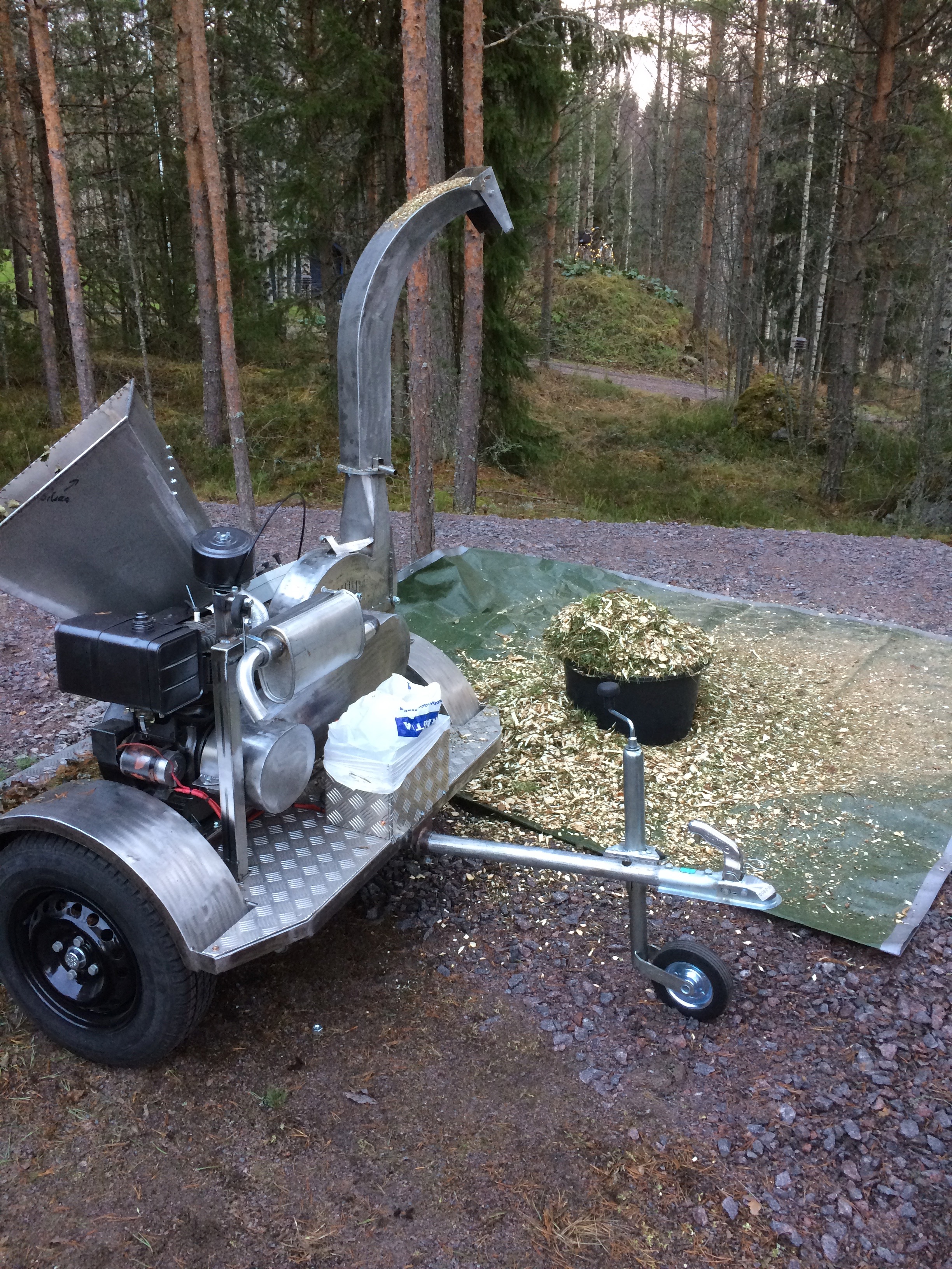

After many months I ended up with this "Wallenstein influenced" construction. I have just tested it and it chips fine up to 4" but there is one problem - the self-feed is almost non-existent!
I guess that the only way to get it feeding is to remake the feed chute to one with hydraulic feed. Basically I know the construction of a hydraulic feeder but the dimensioning of the hydraulic components is not my strong area - here I would appreciate some advice and help. I have not been able to find any viable information from smaller commercial chippers with hydraulic feeder.
