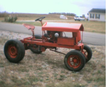

Almost got her done! Gotta add another coat of <font color="red"> </font> RED paint and BRAKES!!

Good job! I was following it at machine builders and it looks orange here too. Not stopping gets you into more trouble than not starting so don't leave it too long for brakes.

Lessee if Photoshop and my very limited experience can save my pride.Dad always warned me about tractor colors.He said to go ask my sister what would happen if I came home with an orange tractor.Told him I didn't have a sister.He said "The girlie that sleeps on the top bunk in your room and captains the football team...Allis".
/forums/images/graemlins/blush.gifIf he starts calling me Kubota....guess I'd have to start listening to rap instead of country....

GOOD JOB!!! although i can tell you from personal experience that type seat is not comfortable /forums/images/graemlins/grin.gif
/ Homemade tractor nearly finished... #5
Frank's statment could'nt be truer. At least put a pad on the seat.
Sure looks good.
Egon /forums/images/graemlins/grin.gif
