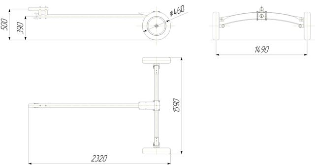

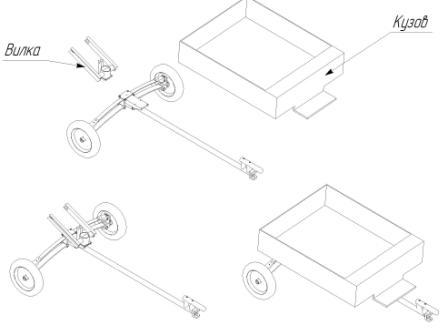

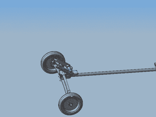

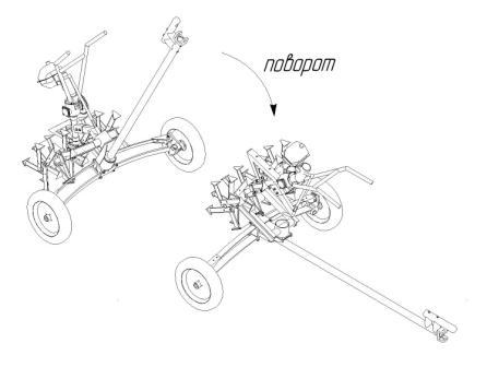

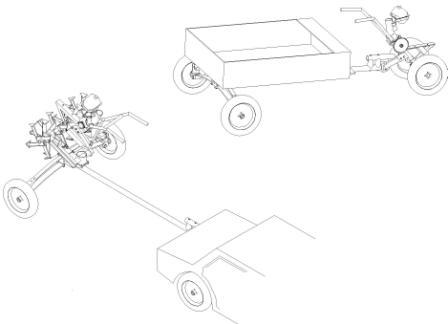

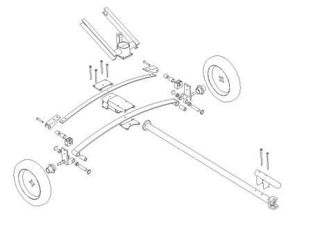

I'm from Russia speak english is bad. What is not clear ask. I will try to show photos and videos.
I do not shop. I am a lover to do a good homemade equipment.
I want to show you my trailer. I did it myself for transporting the cultivator and cargo weighing up to 400 kg. Speed up to 100 km / h. Ammartizator serves two springs. Shaxi trailer weight of 40 kg.
