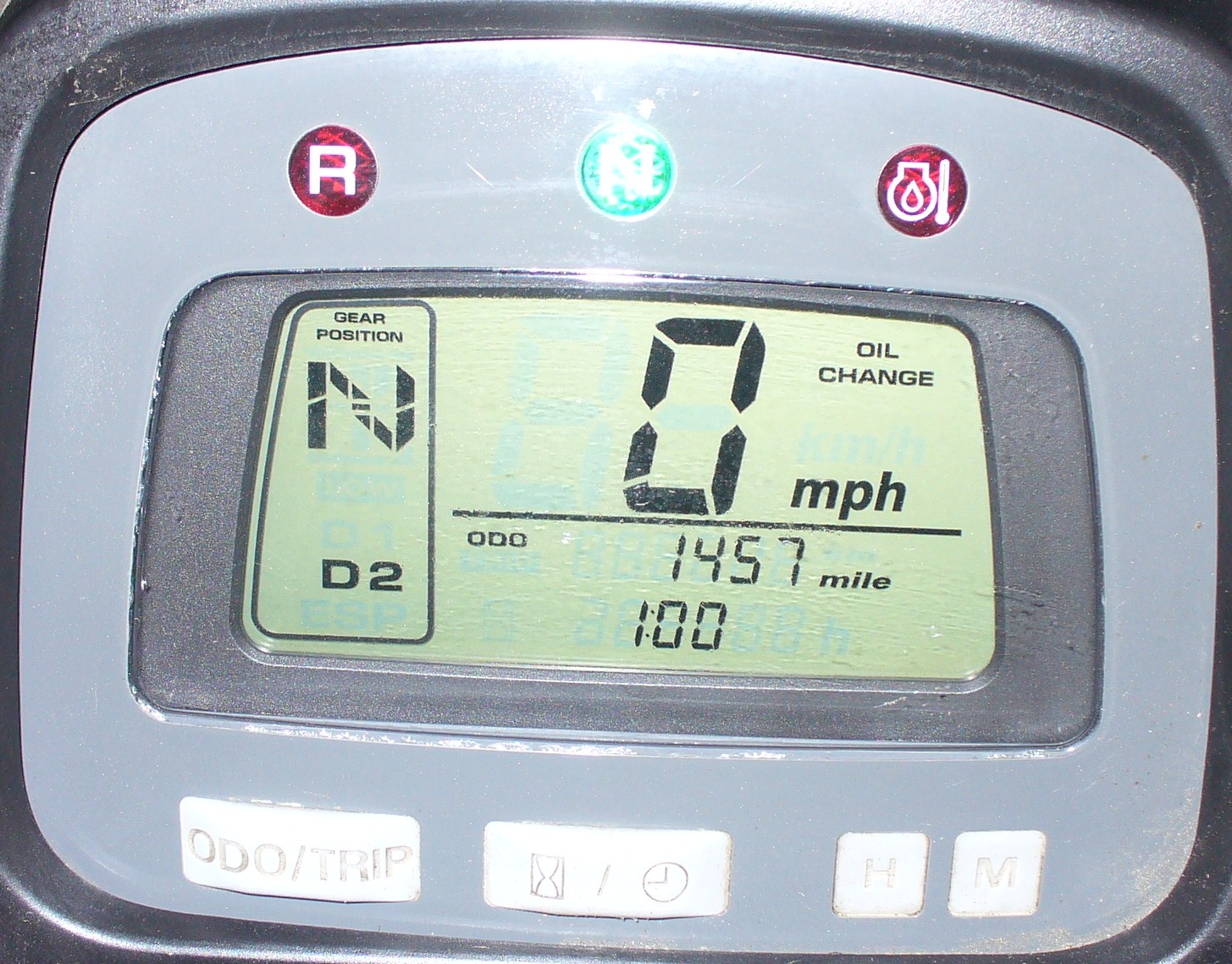

My knowledge of ATVs is limited so I need some help..
I have just gone to work for a new client who owns a large lake front vacation home. They have a Honda 4 wheeler, (model ?) They want me to use it and a small trailer for moving all the furniture, beach toys etc. up to the garage for the winter and then of course back down to the beach in the spring.
The LCD dash shows the ATV as having 103 miles on it. Near the bottom of the screen (center) it is flashing 100 in small numbers. I suspect that this flashing 100 indicates the machine is due for service. Can anybody verify this for me ?

Is it the clock?
   / Honda 4 wheel service question
Is it the clock?
Possibly, although I don't think so. It is clearly flashing 100 and not 1:00 and it never changed in the hour plus that I was using the ATV. It constantly stayed a flashing 100.
   / Honda 4 wheel service question #4
Most likely it's a Rubicon and that flashing number is the clock. If you think it's a check engine code then here is the procedure to check it:

Does it look like this? The clock in the lower left corner does not have the : that a clock usually has.

MARK,
Trust me, IT'S THE CLOCK >>>>>
I just walked out to my shop on one of my Honda Rubicons.
YEP, It is the Clock !!!
Either it has not ever been set up, or at one time or another, the battery run down or got replaced, and nobody ever took time to replace it.
Mine also, is FLASHING 1:00
It is not flashing the number 100
To set up, look in the Owners Manual, or should be able to go online and it will walk you threw setting the time on the machine ....
Hope this helps ....

   / Honda 4 wheel service question #6
HONDA RUBICON CLOCK
Yep, that is water going across the screen >>
I wiped the dust off and didn't dry >>>>
Click on picture to enlarge where you can see !!!!

I should have mentioned i have a Honda too, thats how i knew it was the clock:D
Any errors with the ESP appear in the gearchange indicator window
   / Honda 4 wheel service question #8
I have a Honda Rubicon, and it's the clock.
   / Honda 4 wheel service question #9
Setting the clock is easy... The two buttons (H-Hour) and (M-minute) sets the clock.
Just hold either one down to set it.

Well the general consensus tells me that the flashing 100 I see is the clock. I now believe you are all correct. The dash on this particular honda does not look like the picture that Dmace posted but is sure does look like the picture that TWO GUNS posted, although I think the gear indicator lights may be layed out a little different. It could simply be a different year or model. I don't remember seeing the : in the 100 but I probably just didn't pay close enough attention.
