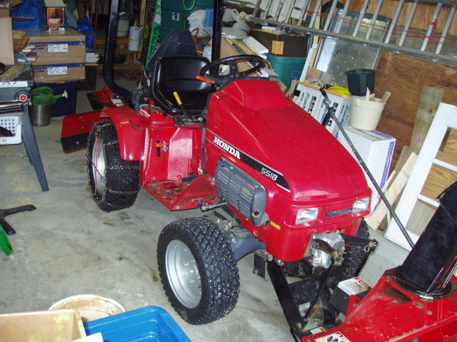

Apologies for the mess around the tractor- we were in the middle of a seasonal move.
Here it is set up for snowblowing. The 3ph blade on the back is a 4 footer, which is easily handled.
The lift points on the front are the same ones used for the MMM (only one is used), so you can see how much effort it takes to get that lifting capacity back under the tractor!!
