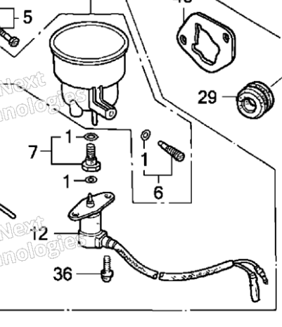

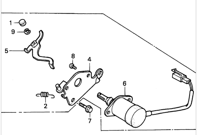

A few questions.
- Do you have the throttle control connected and does it work ?
Throttle control
And I see that there is a fuel shut-off solenoid. Is this connected and does it work ?
Shut-off solenoid is #12.

A few questions.
Throttle controlView attachment 764223
Thanks again Richard! It does have a fuel shutoff and it is new. I'll try testing it. Relatively simple test.

A few questions.
For the throttle control, which it does have, is there a way to test it? I was thinking this may be suspect. Thanks again.
