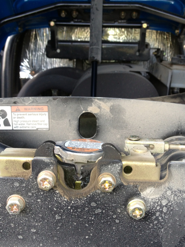

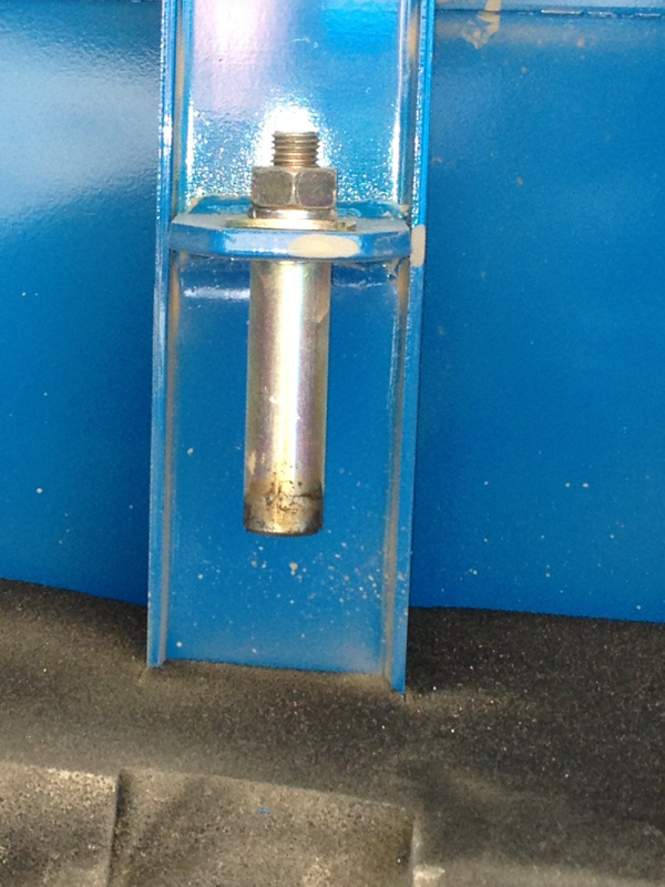

Post some pics if you can of the hook and attachment on the bottom of the hood, the latch and attachment inside the motor compartment, and where the 2 meet - if you can get the camera in there close enough. Make sure the entire motor surround is all the way seated - down and back, if removable, as if it's mounted to high or forward the hood will never line up.

Took some pictures today. I think the pin is set way to back and is only catching the front of the pin on latch. Going to buy some washers to move forward.

By the grease mark on the pin it almost looks like you may need to remove one washer to push it more forward to catch more pin in the latch. Try to keep the lock washer and lose the bigger fender washer if there's enough shoulder on the pin to hold it in the mount. Can you maybe take another pic of the pin down close to the latch, ie the hood almost closed to show how the two should mate (just enough room to fit your camera)?

Another thing you might try is the latch. It may be stuck in the closed position so it will never close around the pin.
By your picture try to push the 2 ears(above the bracket) opposite of eachother until they click and stay - this may take a little force.

I sent a PM to Mike and will post here also. I took a look at mine yesterday and it looks like I just removed some washers from the back side where the nut is and put them on the other side of the pin to make it extend out further. I looks like mine engages about an inch now and holds with no problems. Prior to adjustment it would spring open when I put force on the FEL. It somehow torques the latch when the tractor loads up and if it is barely catching like in Mikes photo it is enough for it to slip out of the catch.

Put in 2 washers and it looks like problem is resolved.
