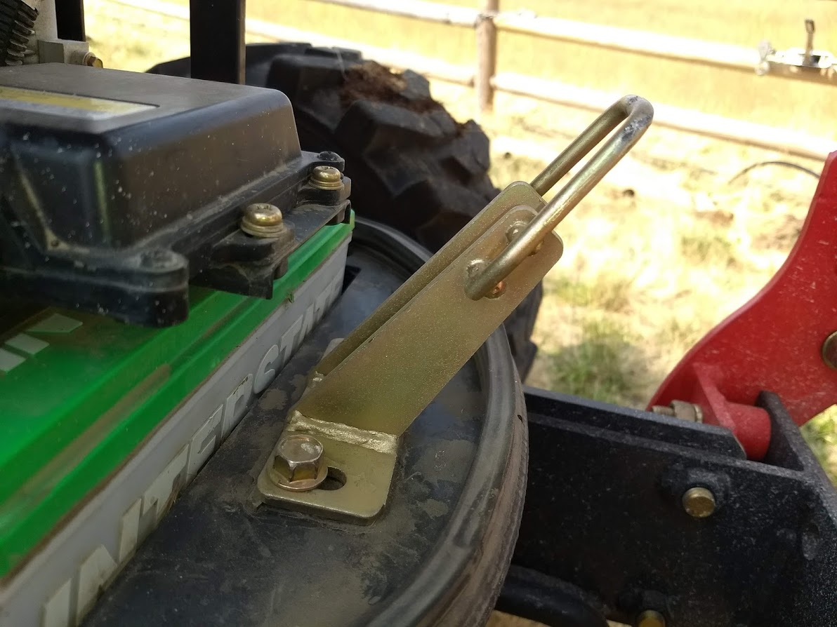

I am experiencing a weird problem with my 4720ch. The hood would no longer latch. It has always been a little hard to latch, requiring a bit if a "slam" but it finally wouldn't latch at all. Neither the hood and the chassis have damage, no evidence of anything being bent. Upon checking and measuring thing closely it became apparent that the latch mechanism that is mounted to the hood was coming to rest in front of the latch pin that is mounted to the chassis. The latch pin on the chassis is adjustable while the latch mechanism on the hood is fixed. With the latch pin adjusted all the way forward is was still just under 1/2" of being far enough forward to clear the hood's latch mounting hardware and mate up with the latch(???) Like I say, every thing looks good, nothing appears to be damaged or bent. If it were bent that severely the damage should be obvious! I fabricated a wedge to place under the back of the latch pin so when it is tightened down it throws the latch pin is far enough forward to now latch. So I can at least close and latch my hood. There is about a half inch gap between the back of my hood and the body cowling. I think it has always been like that, but I am not sure. I checked to see if the hood hinges were adjustable and perhaps the hood has slid forward (I found that they are not adjustable). Even though it now latches with my jury rig, it still has me baffled as to what happened and what is wrong. I could re fabricate a latch pin or modify mine, and I may, but I would rather find the real problem. Anyone have any insight?

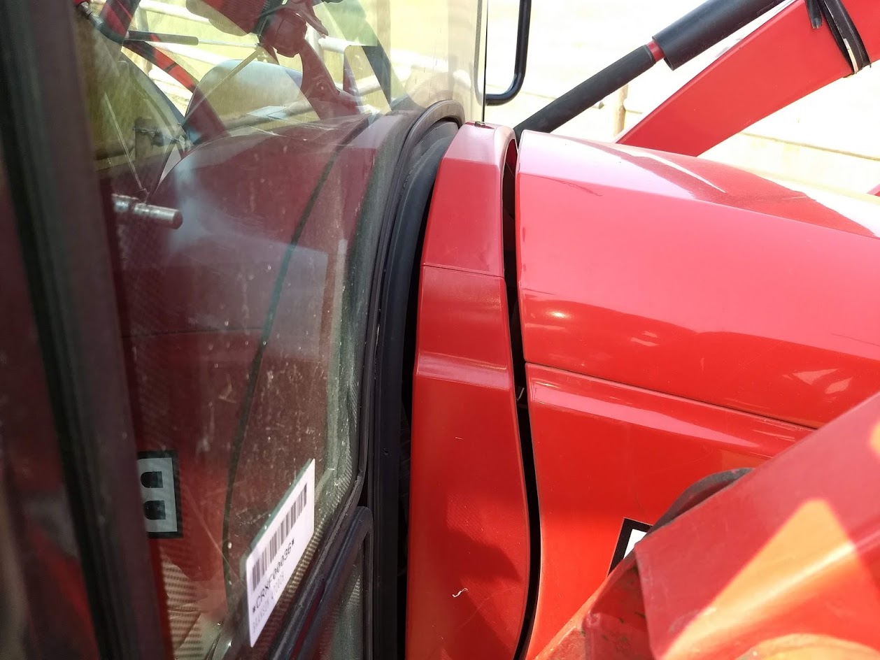

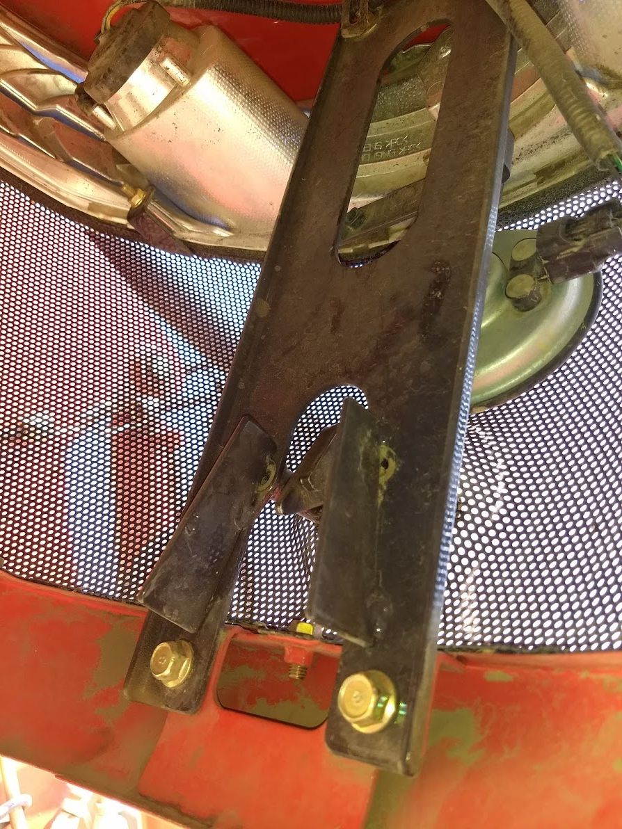

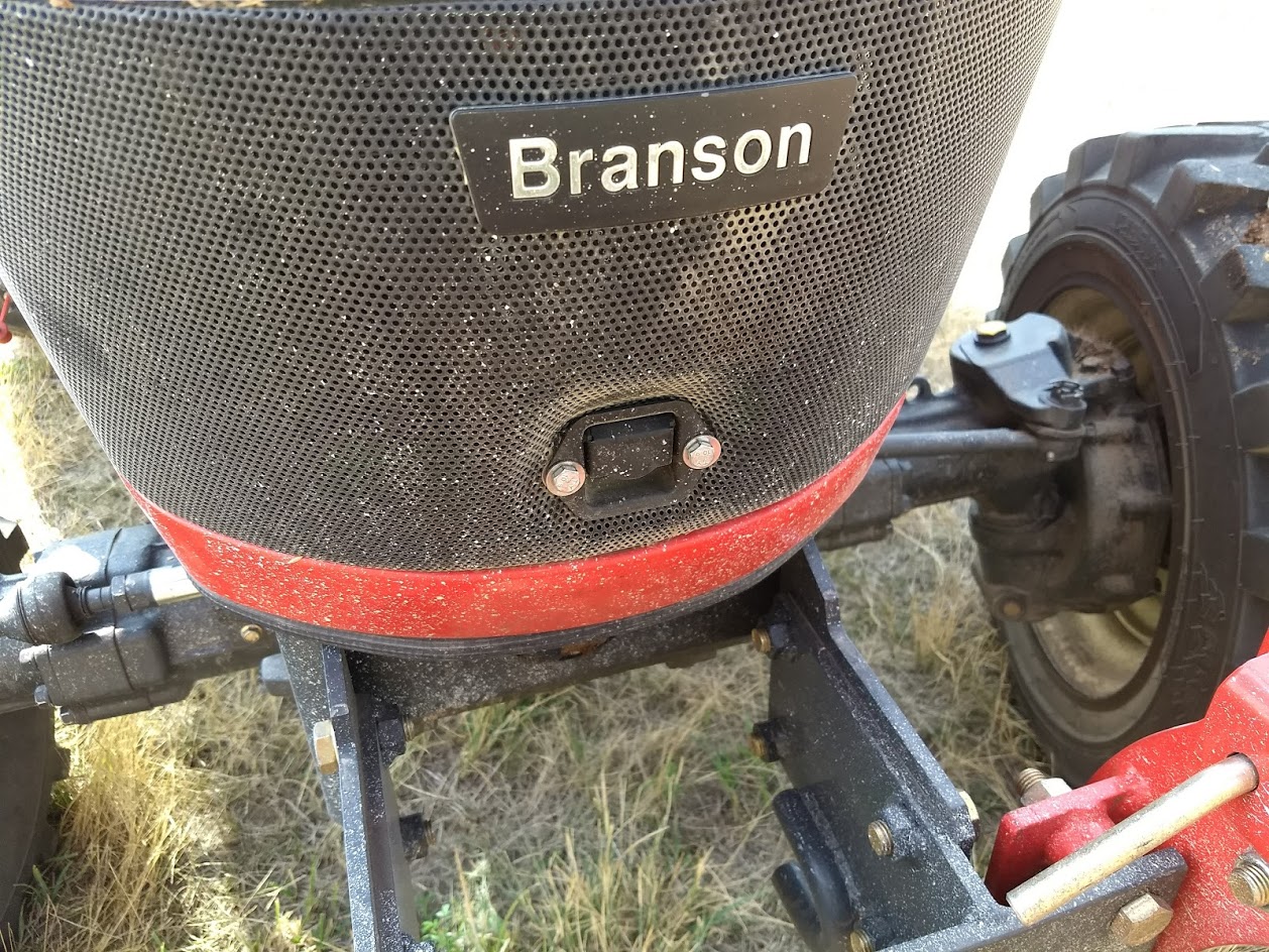

I took some pictures. Picture 1 is the latch mechanism. I replaced the Allen head screws on the latch mechanism with hex head bolts (easier to take off a dozen times:)). Picture 2 is the latch pin. You can see it is adjusted all the way forward, and if you look close, you can see the metal strip I put under the bottom trailing edge to lean the top forward even further to make it to where the hood will latch. Picture 3 is the latch mechanism mounting bracket looking from inside the hood. Picture 4 shows the gap at the rear of the hood. I am wondering if other 4720's have that same gap?

The gap between the back of the hood and the body cowling looks normal. Even mine has about 1/2" gap between the hood and the dashboard and it is a completely different series.
Here is a video of a 4720 where the gap is visible. Branson 4720CH minute: 0:47
What I'm wondering is that gap between the body cowling and the cab? Looks like your problem may come behind the the cowling. In the 4th picture, the rubber strip between the cab and body cowling seems to have a bit more open space than it should.
I'm not familiar with cabbed tractors. Any chance the something came loose and shifted the whole thing forward? Causing all of your problems.
