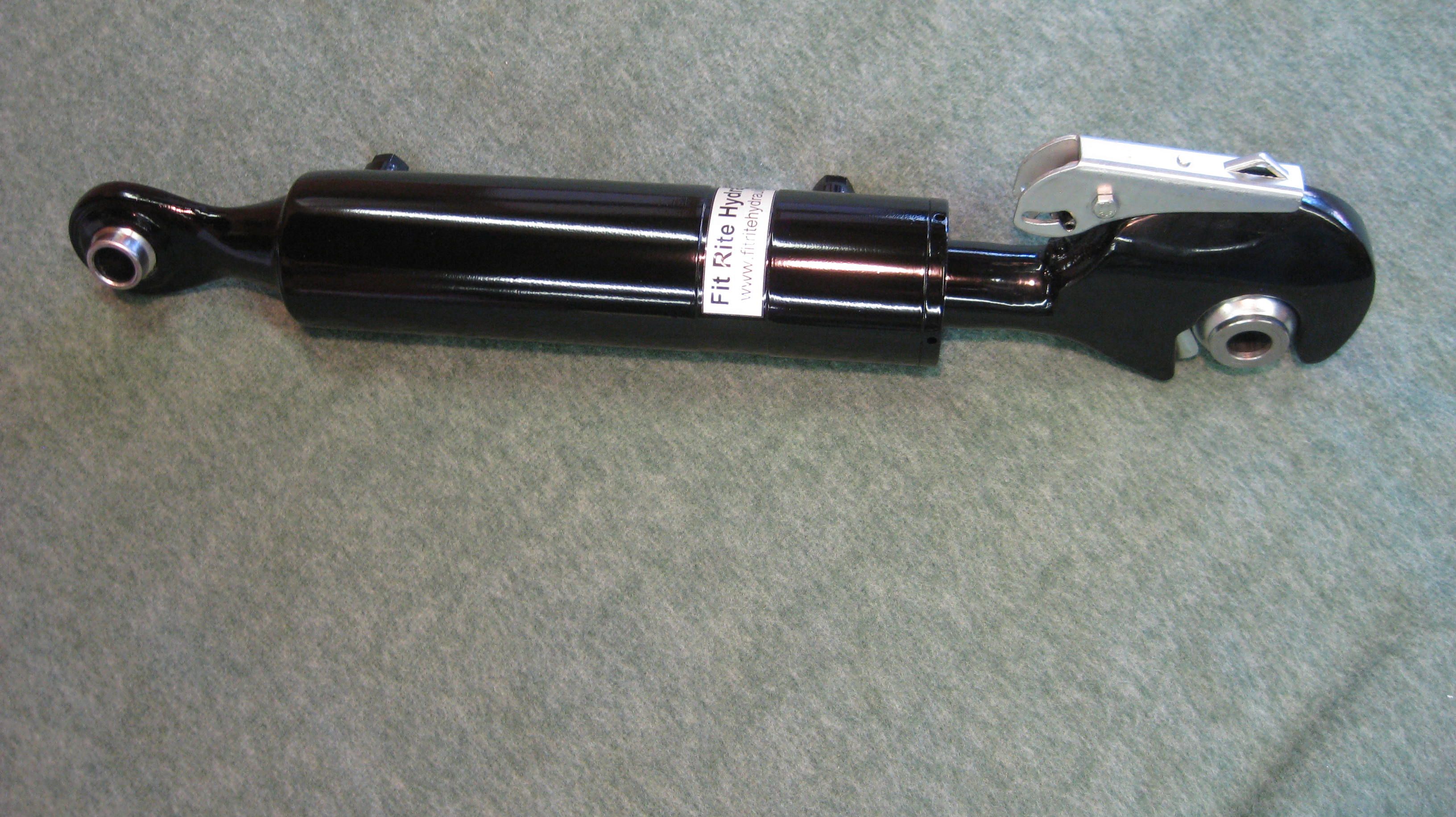

I should have them, but if I'm out, I have more on the way. :thumbsup: Suppose to be here anytime now.
Of course, if you get the Euro ends for your draft links, then you"need" a Euro end with a hydraulic link in front of it. :cool:
