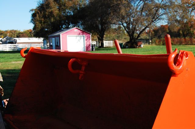

I have a extra beat up bucket for my tractor and would like some advice on the placement of 2 hooks . I was planning on welding them on the top were the " Level " bracket is one on each outside edge , but a friend suggest welding them to the inside of the bucket .
Opinions ?

Why just two? Philip.

/ Hook placement on bucket . #3
Three on the top of my JD's bucket; one in the center and two on the edges. I'm not going out to the barn to take a picture though.
None on my Kubota yet, it's still under warranty and I don't want to give Kubota any excuse if the FEL has any problems.

I have two of the "clip on" hooks along the top edge from BXpanded.
I also attached a hook on the bottom, back edge of the bucket. Having it closer to the tractor increases its lifting capacity. I drilled a hole through the thick bracket that the bucket's hydraulic cylinder attaches to, and then used 3 or 4 links of logging chain, and a 1/2 inch grade 8 bolt to mount the hook. (Shamelessly copied another TBN'er.)
I don't think that you have that large bracket, as I believe you've got two bucket cylinders. If you can figure out a way to mount a single hook somewhere, do it, even if it's not as far back as mine. It makes lifting things much easier, and more centrally balanced. Having two further apart is good when you need to balance something, but it takes more messing around trying to get the lift squared up.

Thanks for the input . I think I will add a third to the middle and keep them up top .

I frenched in a 2" hitch receiver on the top of my bucket, allowing me to use more than just a hook.

Here is what I did and I am quite happy with the arrangement. Most of the time I loop the chain over the large slip hook in the center and attach it to one of the grab hooks.:thumbsup:
BTW I reinforced the top edge of the bucket with 2" X 3/8" angle.

Thanks for the replies . I have decided to weld to hooks on either end and a 3/4 shackle in the center . I like the receiver hitch idea :thumbsup: .
I will post some photos when complete

Be extra careful lifting anything from those hooks on the outer edges. Anything the slightest bit heavy will lift the opposite rear wheel off of the ground.

Thanks for the tip . The out side hooks will only be used together not individually . I added the shackle in the center for single picks .

Reinforcing the bucket for hooks when mounting them to the top edge of the bucket is important

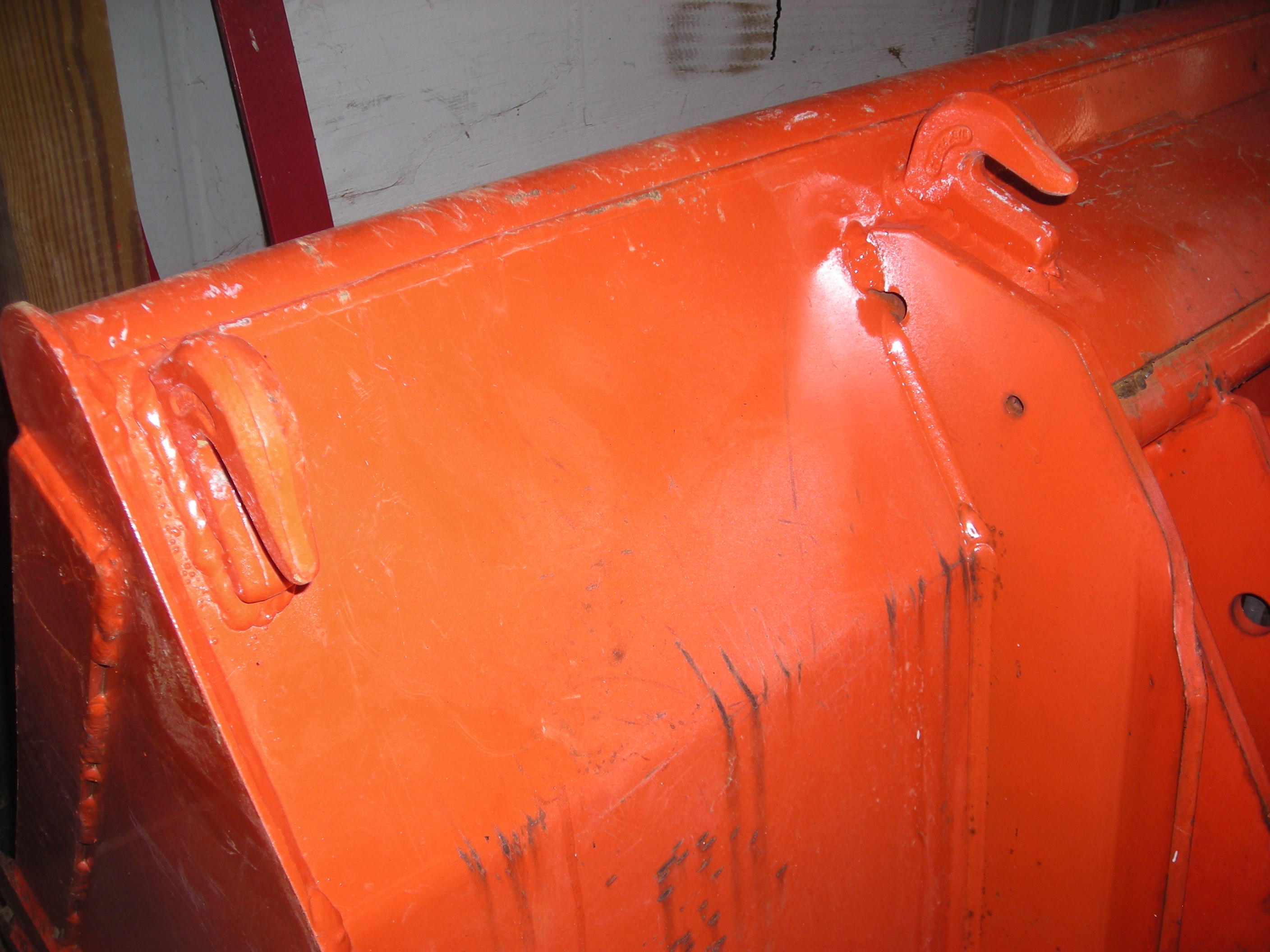

Here's a pic of bucket reinforcement and weld-on hooks on B3030.

Square tubing stock works well to reinforce the top lip of the bucket .. .just weld it into the channel. . . Also I have to agree with the earlier post that lifting off one side of the bucket isnt the best idea. Esp if you're not the only one who uses the tractor, IMO its safer to just put one in the middle. I welded a grab hook in the center and have managed to lift all kinds of bizarre things, never felt a need for one elsewhere. Better to spend the extra time and $ rigging a bumper to protect your lights and grille. . . .you'll need it!
