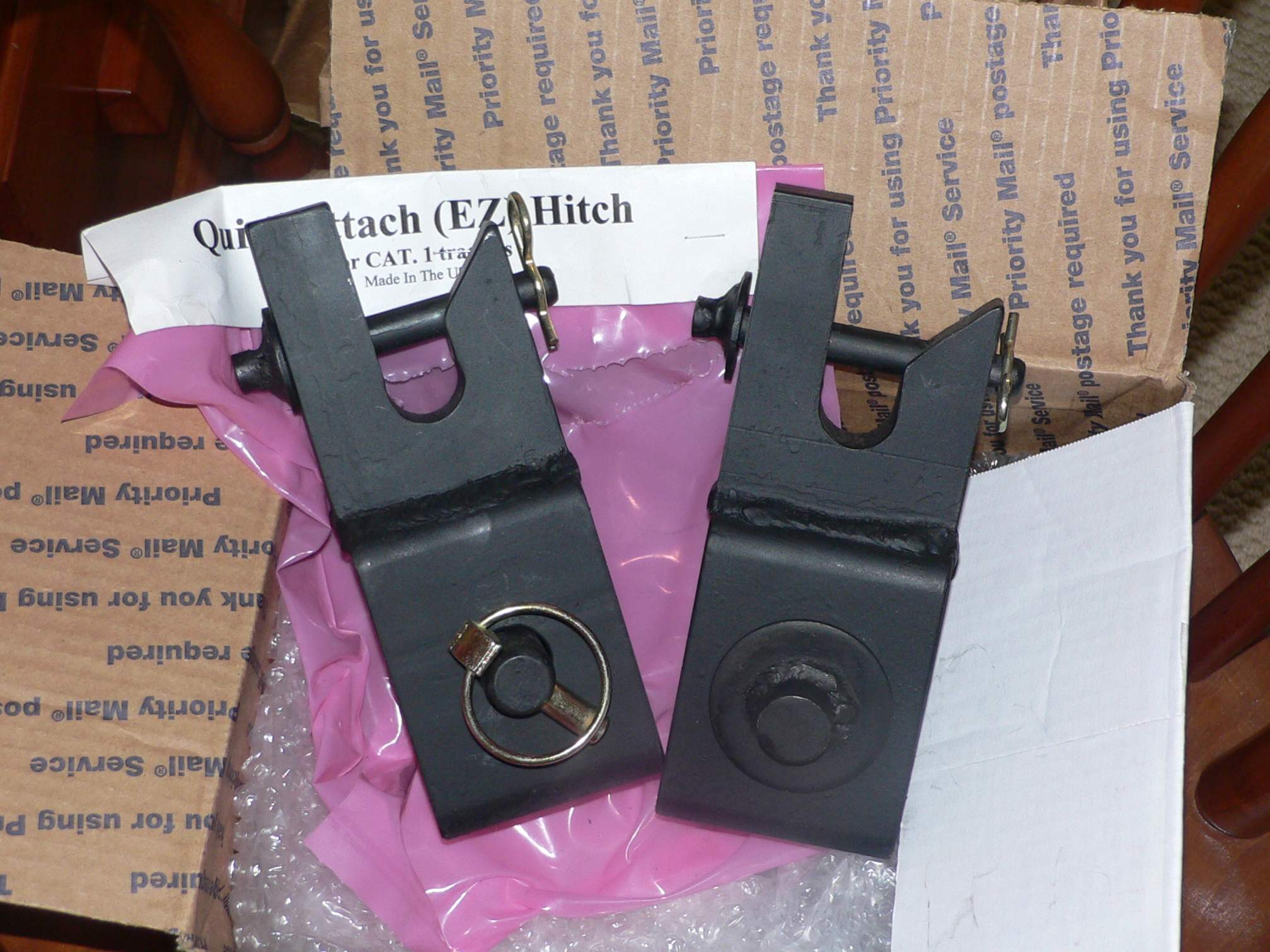

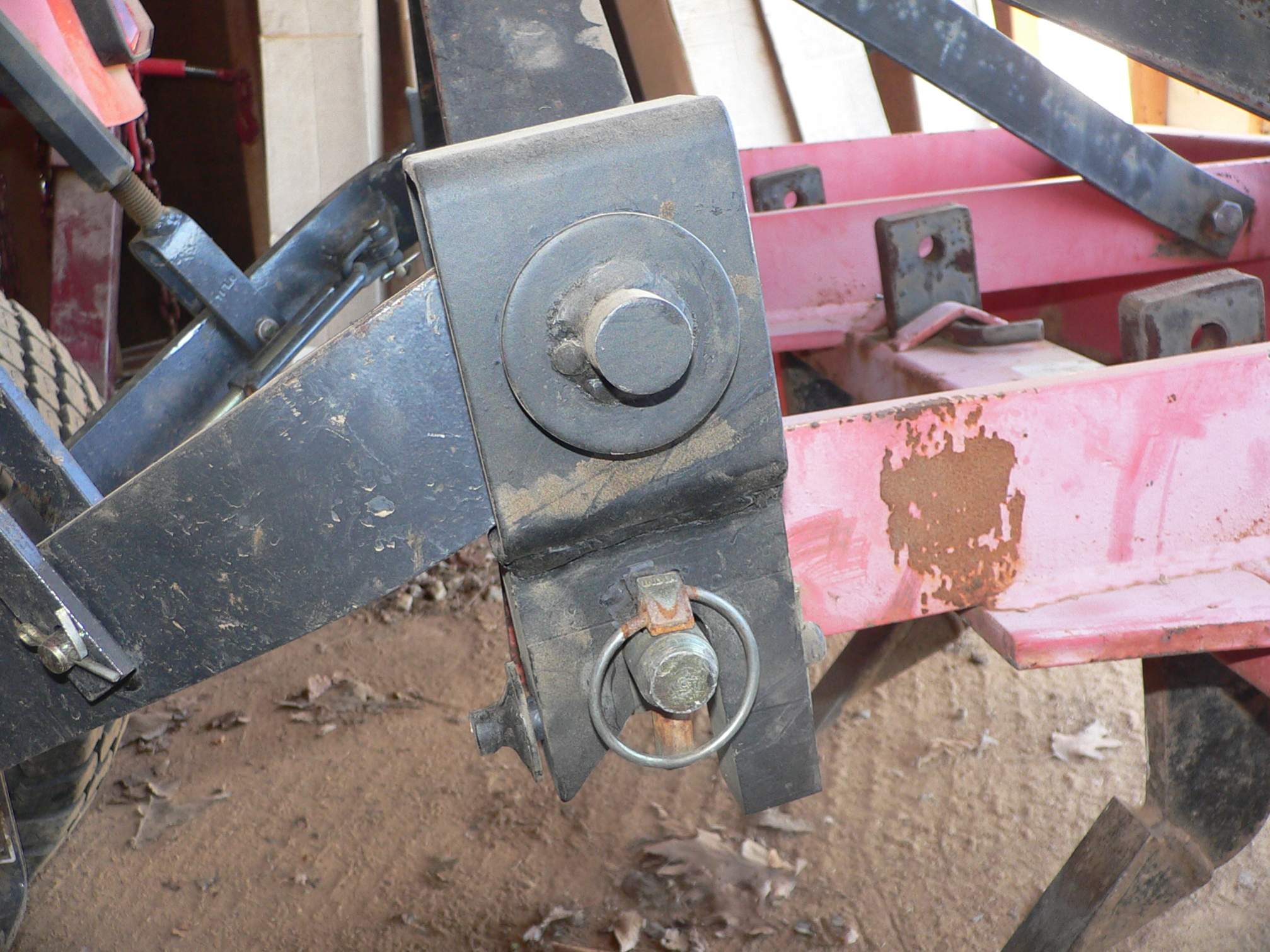

Next solution is Quick Hitches like in pictures. QH's bring their own problem of extending the implement which usually isn't a problem if the implement doesn't have a drive shaft. Even without a drive shaft some times there is still the problem of needing a longer upper arm which are fairly cheap at some place like Tractor Supply ($25).
If the implement has a drive shaft then the QH may make the drive shaft to short to work. I have three different type QHs. Pats was the strongest and most expensive and I've sold mine. The other two types I bought off ebay for under $100. One extends back like Pats and the other lets the implement sit on top of the QH or under it which brings it closer to the tractor. I prefer the QH that lets the implement sit on top of the arm or under the arm but.......I recently had a problem with my tiller breaking a retaining ring which of its self isn't that big of a problem but shows me that there is a lot of slack using my QH under the arm by letting the tiller do a lot of moving back and forth on the arm at the attachment point. Thinking I'm not going to use my lower/upper QHs for my tiller any more.
