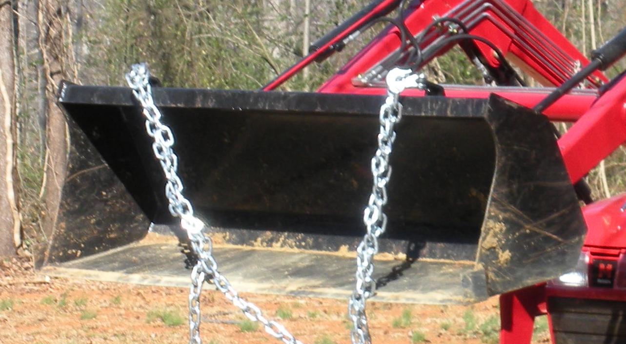

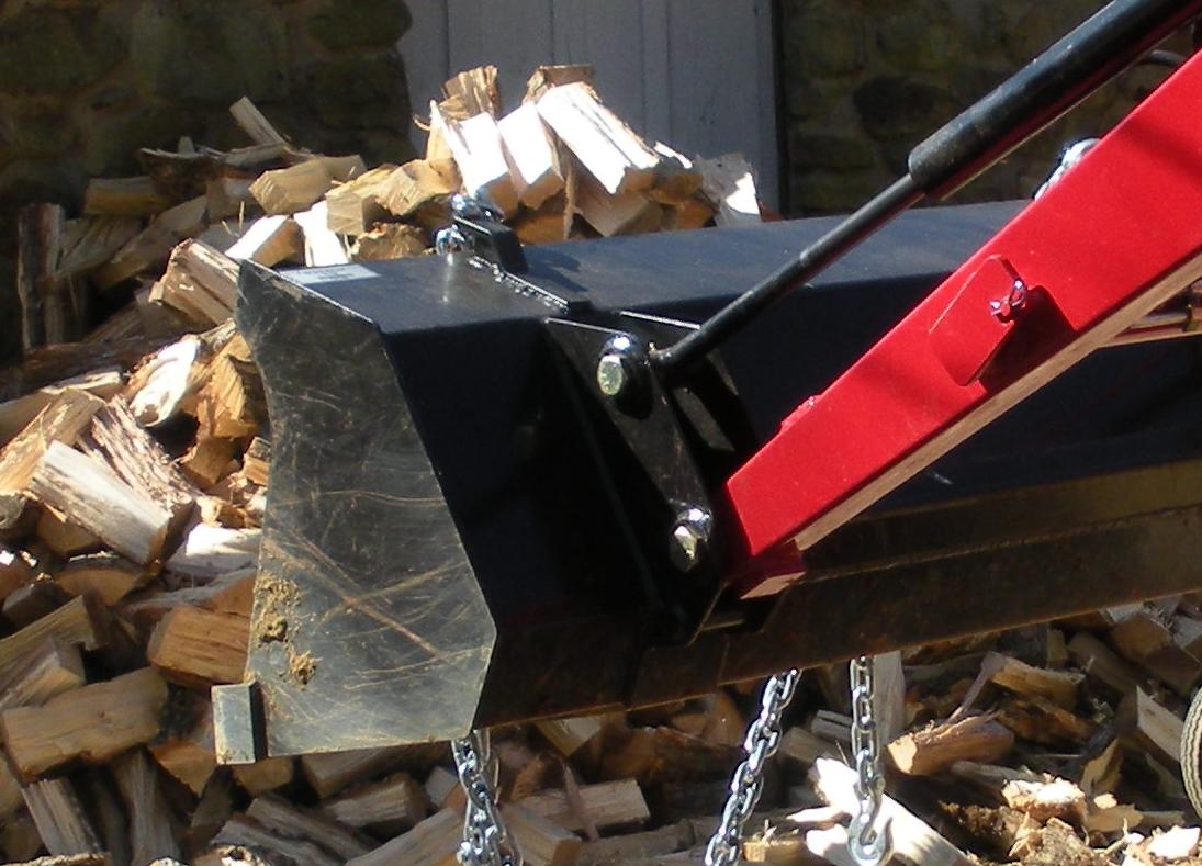

I welded 3 hooks on 1 in the middle and 2 on the ends. It would help to see a pic of the bucket to give advice on whether to reinforce it or not. I will say before you weld a hook onto the bucket wherever it is preheat the hook with a o/a torch or even a propane torch. This will help it to not to crack from thermal expansion/contraction. I have seen some hooks that looked good on one side and the other side was cracked(typically the first cold weld).
   / Hooks on FEL and Box Blade #7
I would highly recommend a 2"x2" angle 3/8" thick be placed on the top lip of the bucket. I put 5 hooks on my 78" bucket and 4 on my 60" bucket. I used chain hooks, and am happy with them. Some have used a slip hook in the center and that has worked well for them.

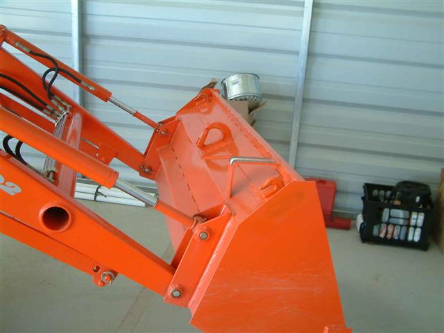

   / Hooks on FEL and Box Blade #8
This is how I welded hooks on my FEL. I really have no need for a middle hook.
