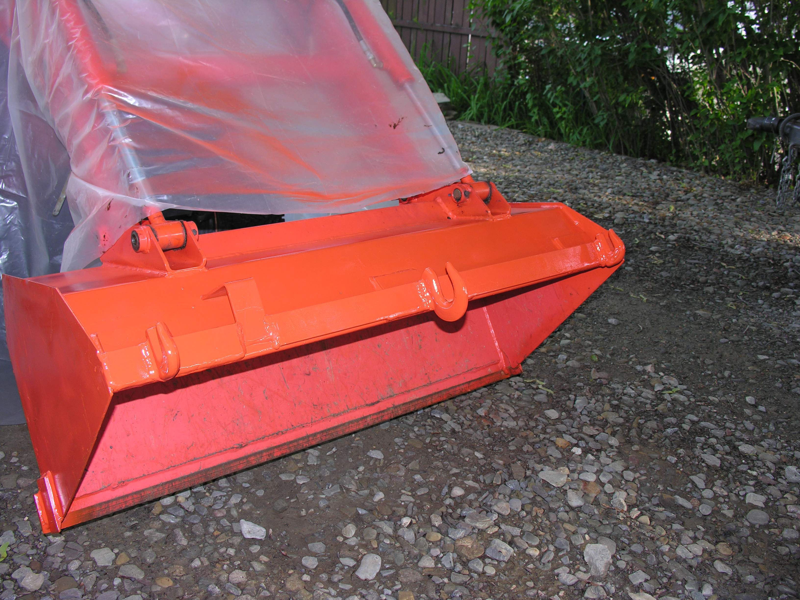

I would like to have kooks on my FEL so I can lift things that won't fit in the bucket. Is this taboo? I've seen some FELs with hooks. Second, where would I get the hooks to weld on the bucket? I've been looking all over the net and can not seem to find what I need.
   / Hooks on FEL #3

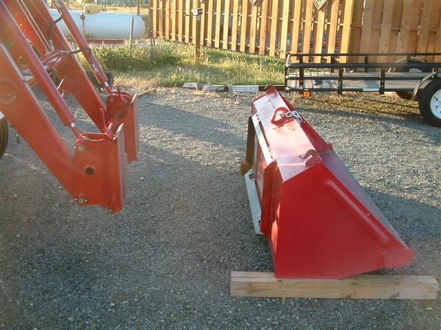

I had hooks welded on the top of the bucket before the dealer delivered the tractor. I had them weld a piece of iron beneath the hook and also had a bolt welded through the end of the hook.
Be careful how much you try to lift with it. The top of your bucket isn't the strongest part, but if treated carefully hooks are a very useful addition.

I would like to have kooks on my FEL so I can lift things that won't fit in the bucket. Is this taboo? I've seen some FELs with hooks. Second, where would I get the hooks to weld on the bucket? I've been looking all over the net and can not seem to find what I need.[/quote]
Try these, great product.

Bigger loader (big Cat loader, for exemple) has only one cylinder for lifting the bucket, it's stronger. Two cylinders might be nicer to look at, but they have to be working in pairs... No off balanced lifting, if one cylinder gets kink, most of the hydraulic flow will be shift to the other cylinder: disaster is close... If you lift a heavy object with the side of the bucket, no so good... Most experience tractor mechanic will advise you to install your hook right in the middle. 5/16 grade 70 (work load limit) will lift up to 4700lbs.

I want it for lifting things like my generator, snow plow for the truck and things like that. Nothing major, just a convenience thing that will allow me to get some things up off of the ground during non use.
   / Hooks on FEL #9
What kind of tractor & loader do you have ? I have a Kubota B7800 , it came with a chain loop/hook mount. But I added a 2x2 piece of tubing under the top edge of the bucket & added a hook made like the top hook on a 3pt qiuck hitch. This is in the middle of the bucket , I use it to move 3pt equipment with out having to use the 3pt hitch . This is also good for loading extra equip. on the trailer . But the hooks are a great idea . Just remember to use ballist / something to keep the rear wheels on the ground..Hooks at northern tool item # 127758-2201 , 3/8 weld-on grab hook $9.99 . You may find them at agri-supply, tractor supply, and maybe harbor freight. Good luck and injoy.:thumbsup:
