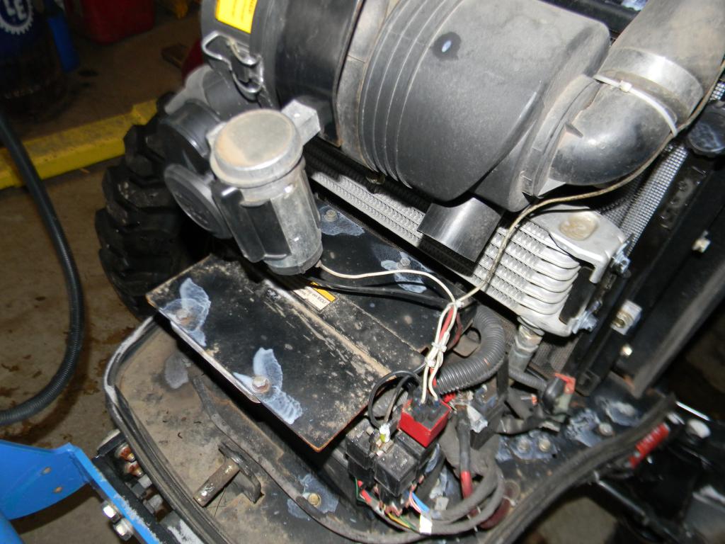

If I install a LS horn and switch on my XG3037, is a horn relay required? Thanks.

To the best of my knowledge any horn that I have seen installed either on a car or tractor has always used a relay so I'd suggest using one.
   / Horn Question #3
If amperage draw of the horn is less than the current rating of the switch, then No.
   / Horn Question #4
The stock LS horn on my XR4155HC is wired direct to the horn switch i.e., no relay. My XR4046HC was same.
I’m replacing the stock LS horn with a Stebel air horn that will be powered thru a relay.
Amazon.com: Stebel 116919 - Nautilus Compact Mini Air Horn Black: Automotive
This horn has current draw of about 18 amps @ 12 volts. It comes with a 40 amp relay.
I’ve installed one on my Polaris Ranger and it’s really loud.
