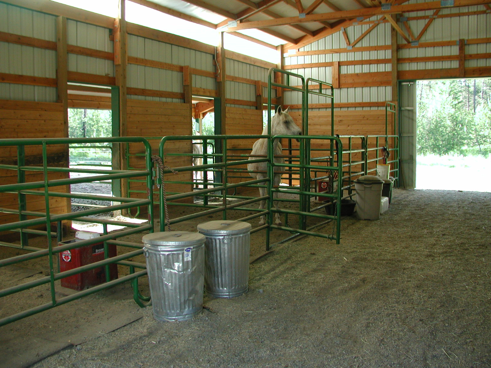

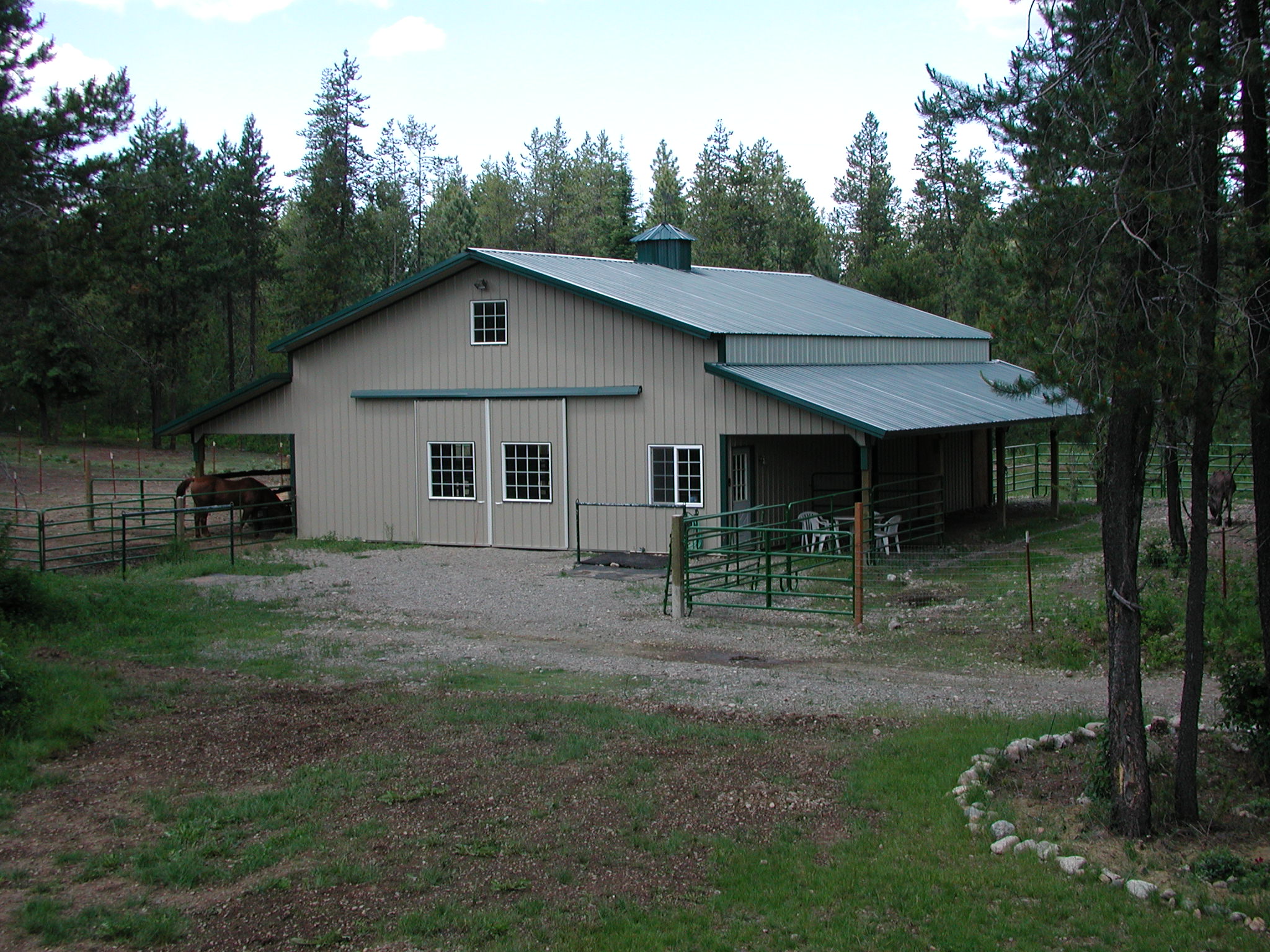

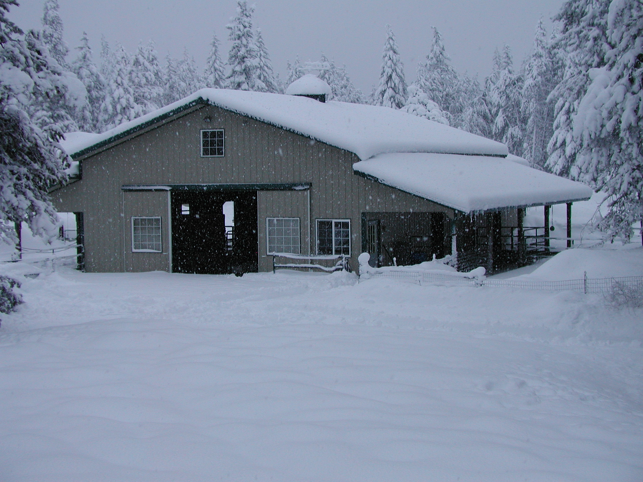

North Idaho here, we get lots of snow and lots of cold winters. I had to eliminate the idea of installing the side stall doors on my barn cause it would get too stuffy in the barn. Closed quarters with damp animals, manure and urine = ammonia smell big time.
The animals are alot healthier with a slight breeze in the barn, and not all closed in. I try to prevent snow from coming in, but a small amount does get in. It gets cozy ion the barn, but do the horses appreciate it.....nope. They go and stand out in the snow all day long.
Little spoiled brats is what they are.
