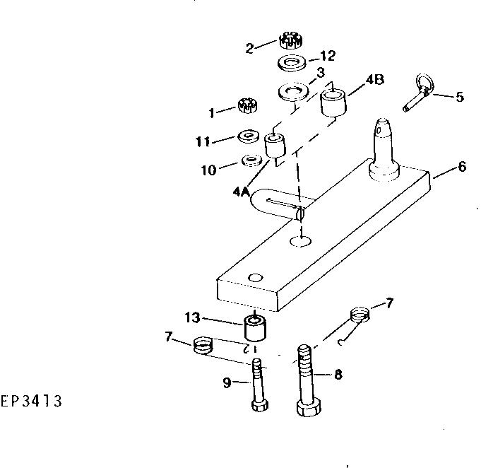

... What really put the strain on it was the extra leverage of the equal angle hitch needed to hook up the JD mo-co's. It extends the pivot point back another 8" or so. When setup right it sure does cut a beautiful square corner though....
Never heard of an equal angle hitch for moco's or haybines required for any brand. Not sure why JD would see it as a good idea to need it where no other manufacturers did. Guess I will have to do some research reading to see what their logic was....
As for cutting square corners: I have zero problems accomplishing that with my moco and I do not even use tractor brakes. Easy to do really and essential in my case as I do not use a hydraulic cylinder on my moco. I use manual ratchet since my old antique tractors lack decent hydraulics. Go round and round towards the center just as outlined in old sickle mower manuals. Lower the manual ratchet once when I enter the field and raise it once when I exit the field and that's it. Cutting square corners is essential for this mowing method.
Deere used them on all the previous mo-cos and still uses them on the square balers. Just gives the hitch a little extra 'swing' to really turn tight. Also it allows for a 90* turn with no driveline chatter. Both our 1219 moco and 337 square baler take the same hitch:
Thanks for posting some follow-up pics. I did some reading as well on my own last night. I now see what it is and what it does, just odd that Deere is the only one that needs it on their balers and moco's. Maybe it was a band aide for helping with less than stellar designs on their part.
All I know is I can put a narrow front tractor on my Hesston 1120 and turn it as sharp as I want to and the driveline will never chatter. I have no problems doing 90 degree turns. FWIW a NF will turn in place without brakes like a zero turn mower can. Maybe Hesston simply made their tongue longer from the start...I do not know. I do the Hesston does indeed have an immense amount of tongue weight.

Never heard of an equal angle hitch for moco's or haybines required for any brand. Not sure why JD would see it as a good idea to need it where no other manufacturers did. Guess I will have to do some research reading to se.
JD's patented Equal Angle hitch was designed to make the pivot point of drawn implements exactly 1/2 between end of tractor pto shaft and the drive line carrier brg so there would be ZERO vibration in u-joints when making sharp turns. I never really understood why the implement tongue couldn't have been shortened enough to accomplish this but there must have been a reason as it was never done.
