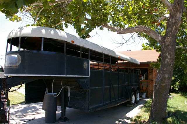

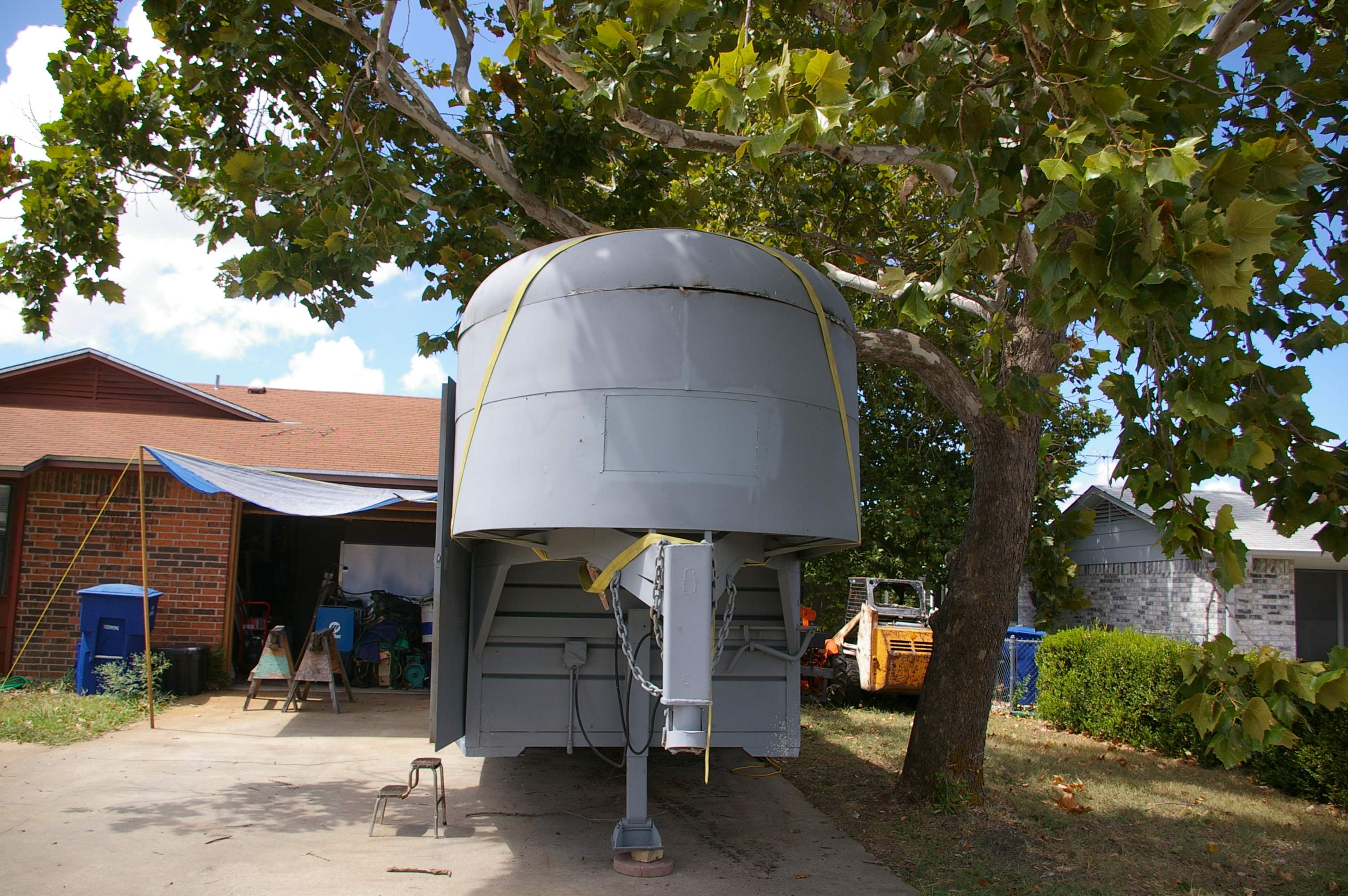

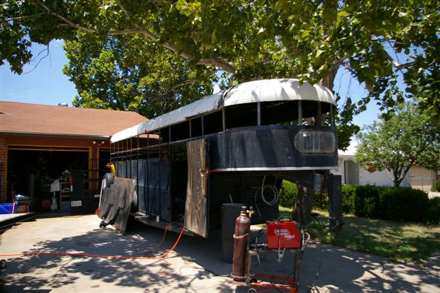

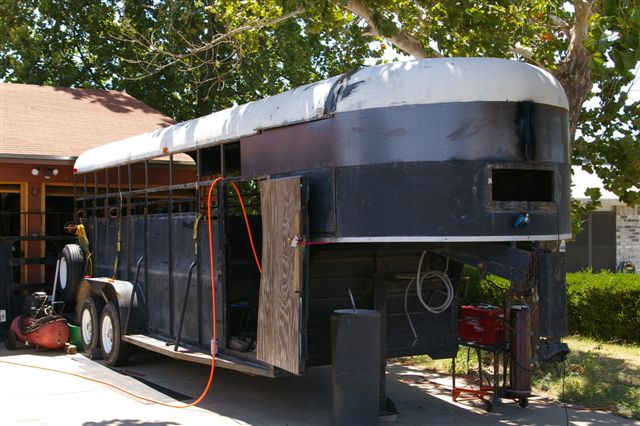

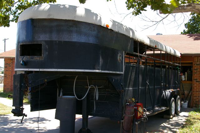

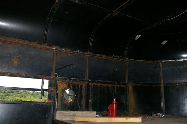

Over the last 6 years I have been working on a project with my horse trailer. It started out when I purchased a 70's series Hale GN stock trailer. The previous owner had created an LQ area in the front portion of the trailer. It was done fairly well however the exterior wasn't sealed well enough and mold developed behind the wooden paneling. So I stripped out all the interior and for about 2 years pretty much left it as a stock trailer. Always wanting to have the LQ back I started to think on how to redo the area and what I could do to improve the concept. Unfortunately i've been sporatic on the pictures but I've got some.
The first few are after raising the roof 12".

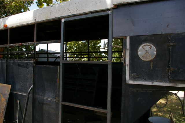

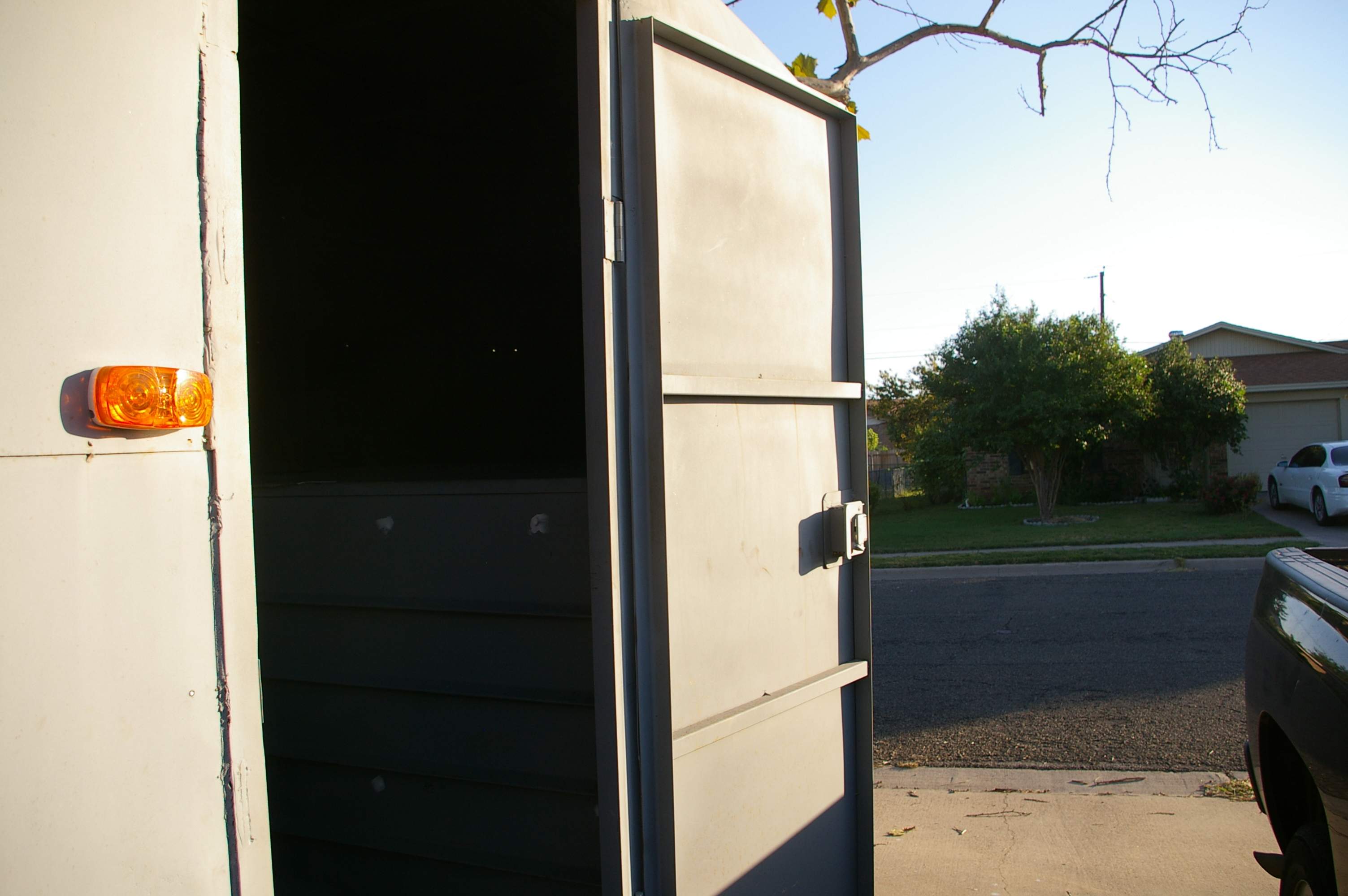

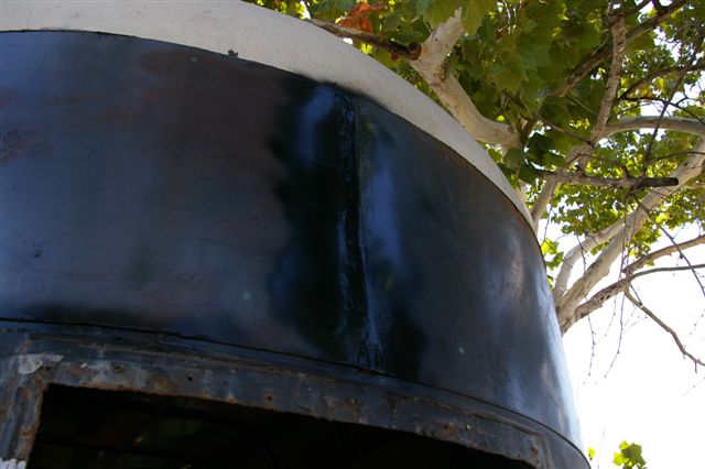

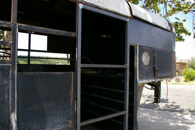

The next few pictures show skinning the front and replacing / creating a new access door.

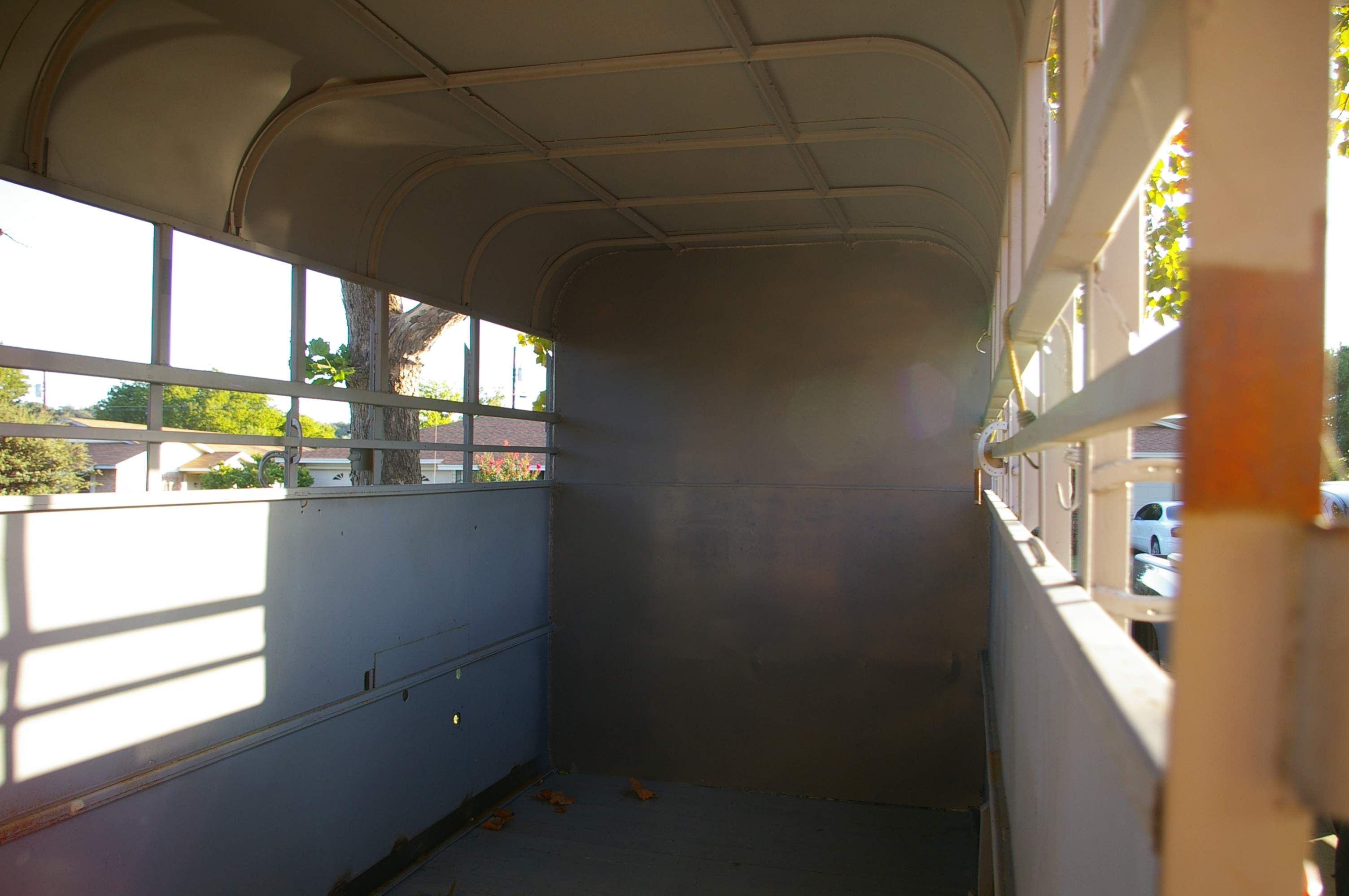

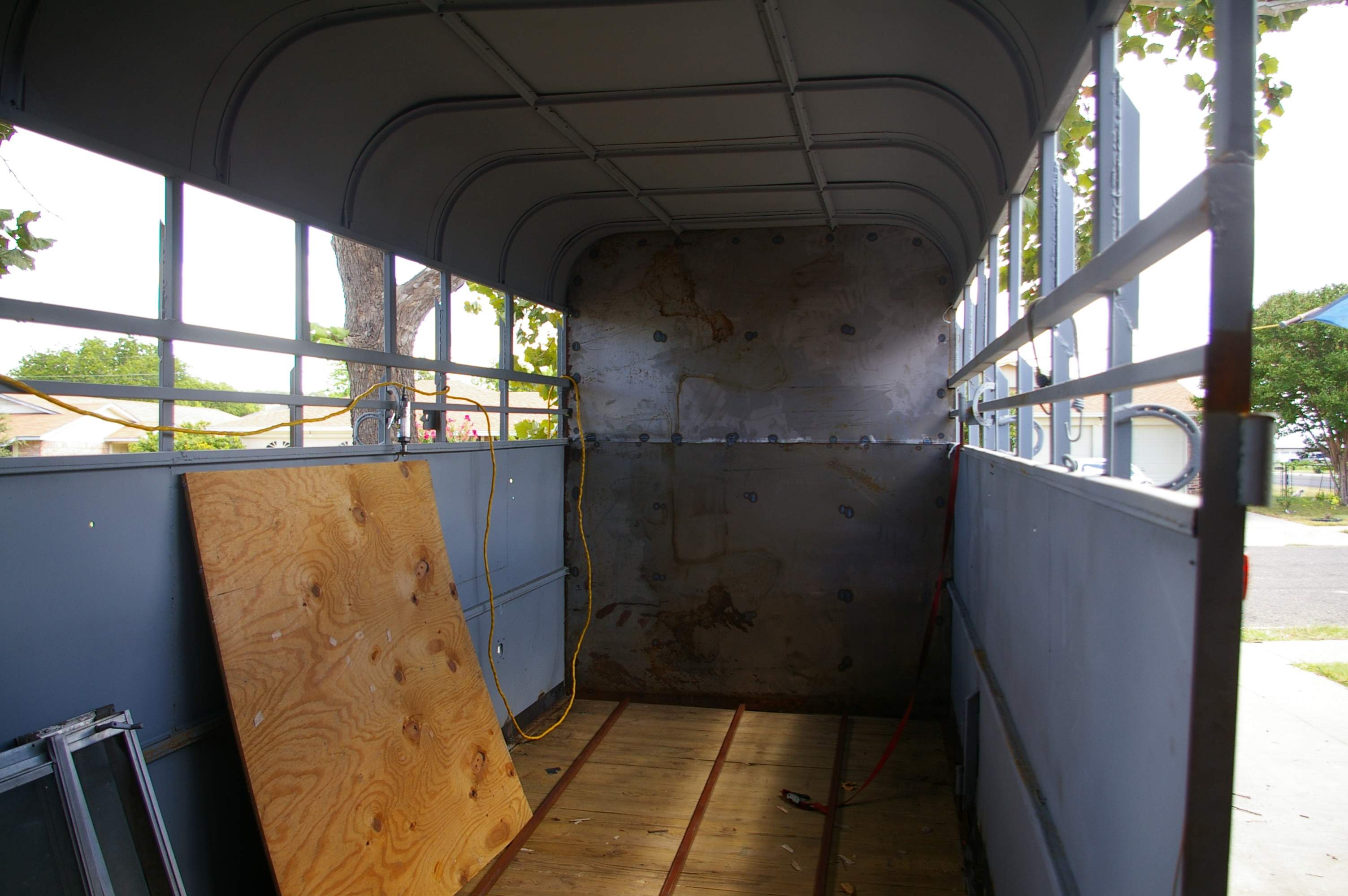

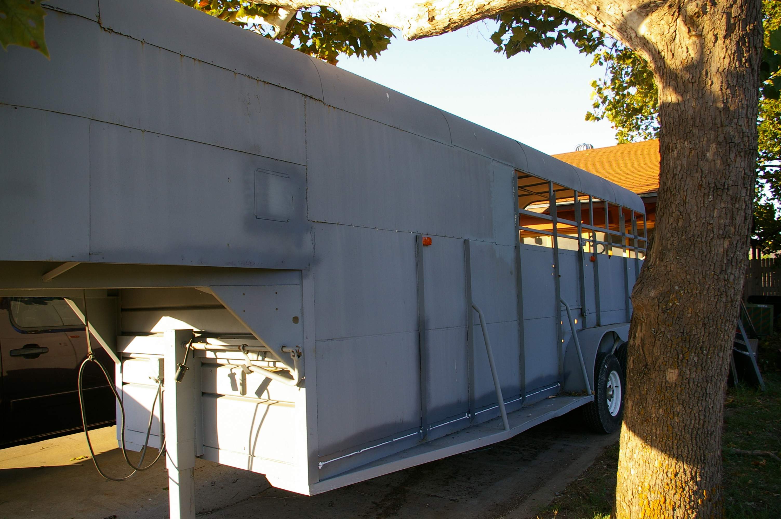

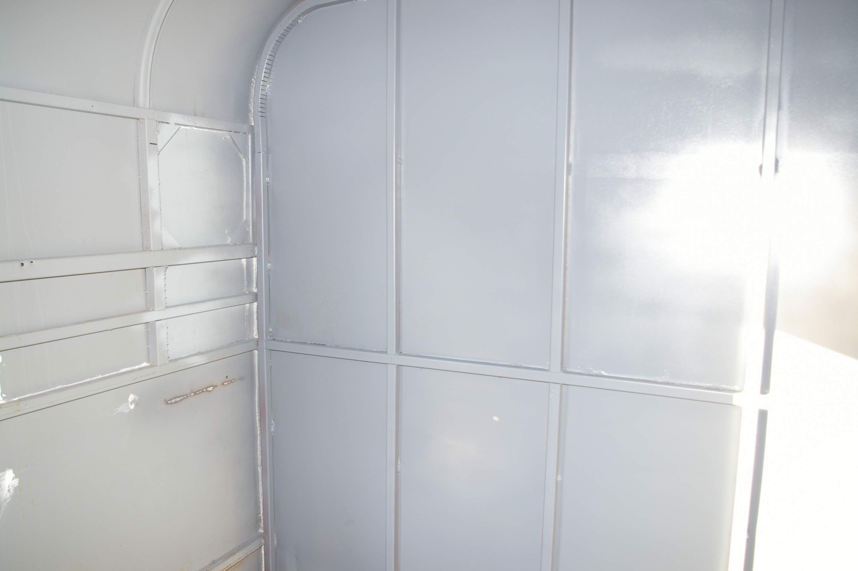

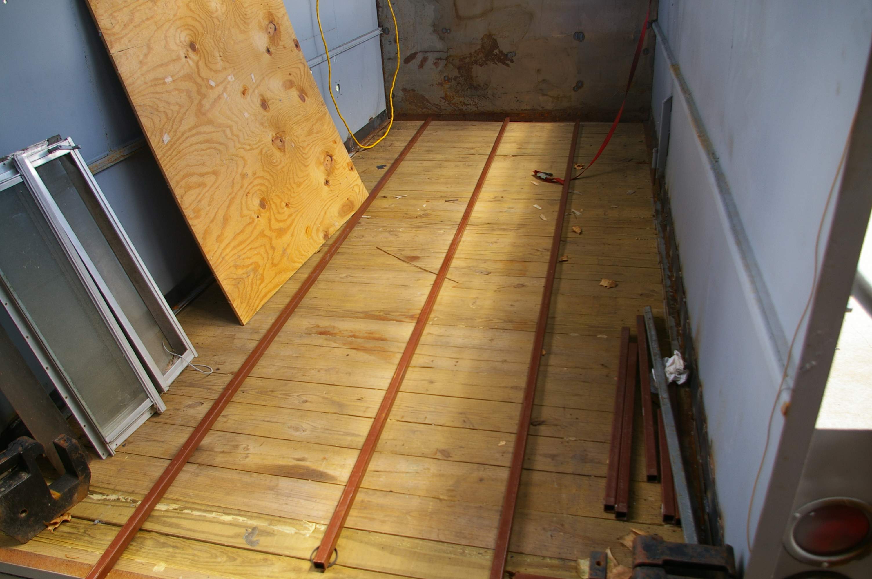

Ok, here it is at the current stage. I have had the trailer sand blasted and primed, tightened and painted floor in horse area, finished all sheet metal and am now in the stages of getting ready to insulate and install a couple of windows.

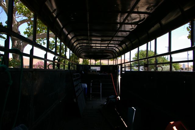

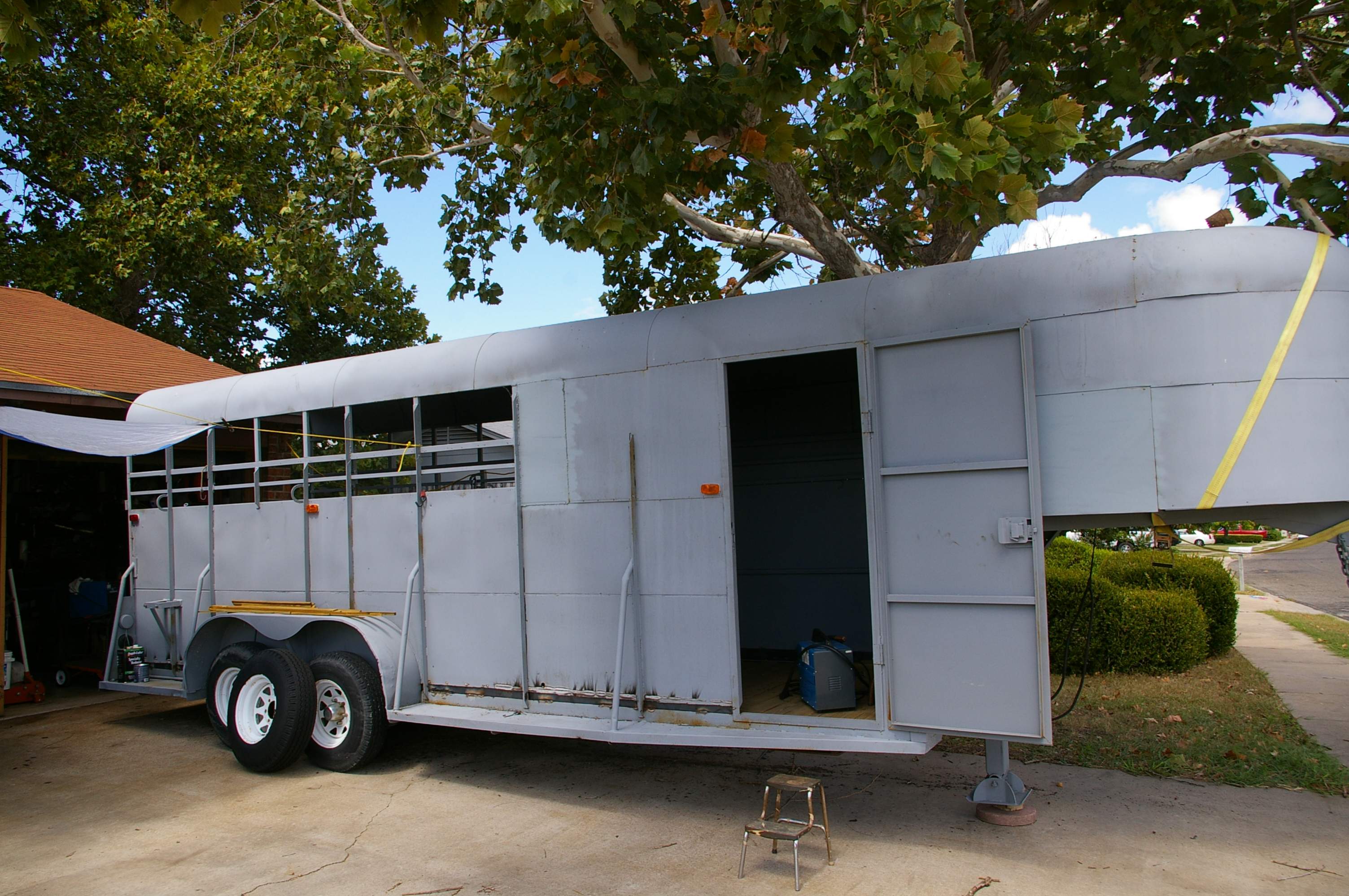

And some more.
After this and as the weather is turning cooler I'll be waiting to paint till next year. I've got a few more things to get done before I put it up for the winter and as soon as I get those items done I'll post pictures. Hopefully all will be done within a week or two.
