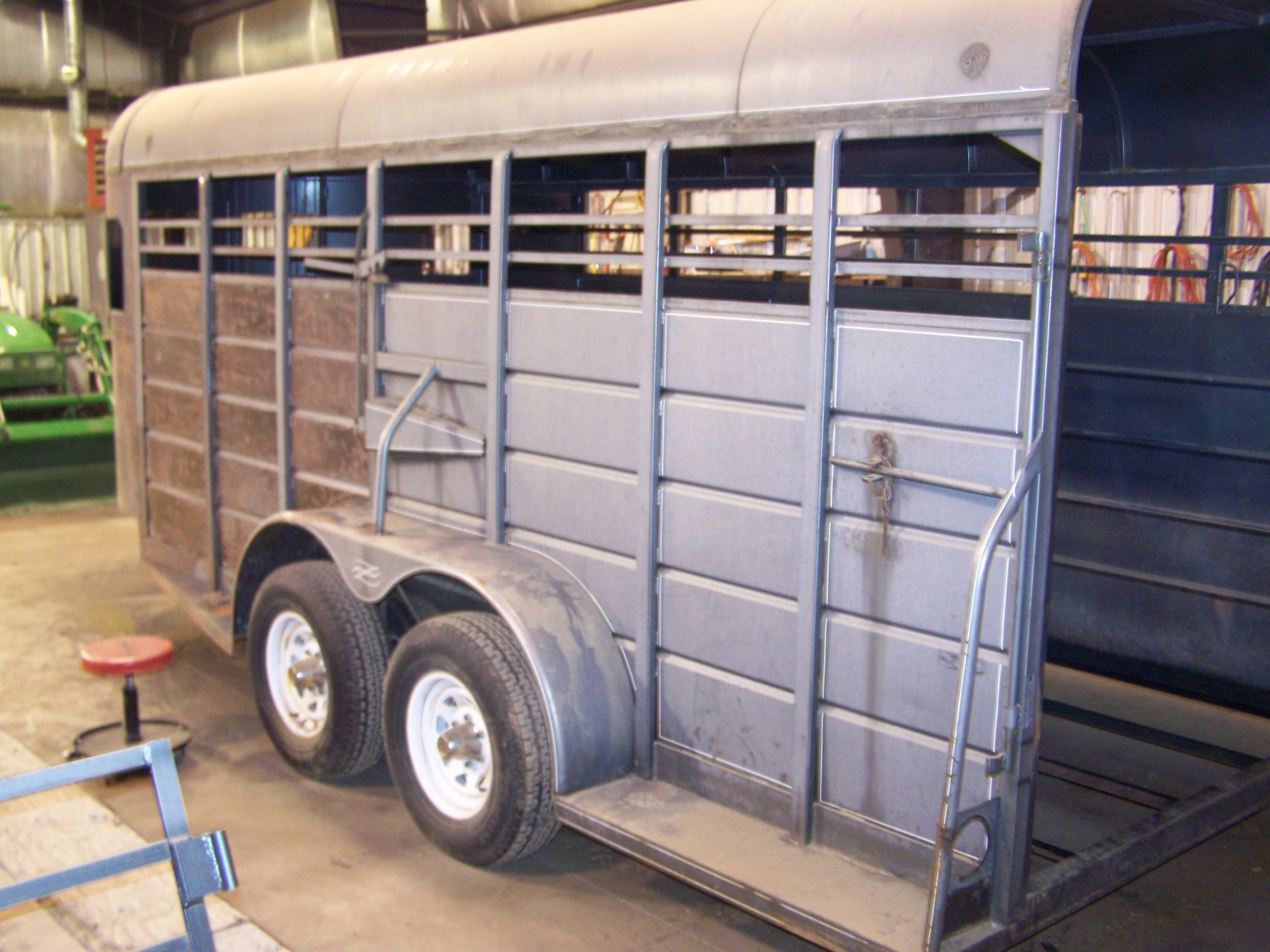

Thought I would share this project with the rest of you fellas. Trailer is a 1990 WW 4 horse trailer, started out I needed a new floor, (I fell thru couple times:eek:), the top was rusty from faulty factory paint, and lights were .....well worked when they wanted too. The trailer steel was still perfect shape so figured lets save it.
Anyhow, this started as most my projects.. as in I can do that vs. paying someone else;) Well I soon learned that sanding and prep for paint is something best left for the pros!!!!!!!! Not sure of how many hrs sanding, wire wheeling, etc went into this but then again I probly don't wanna know!!!!
Sanded all flat areas that I could, then took it to a sandblaster place and had all corners, edges, etc blasted. Sorry forgot pics before teardown and sanding began:eek:

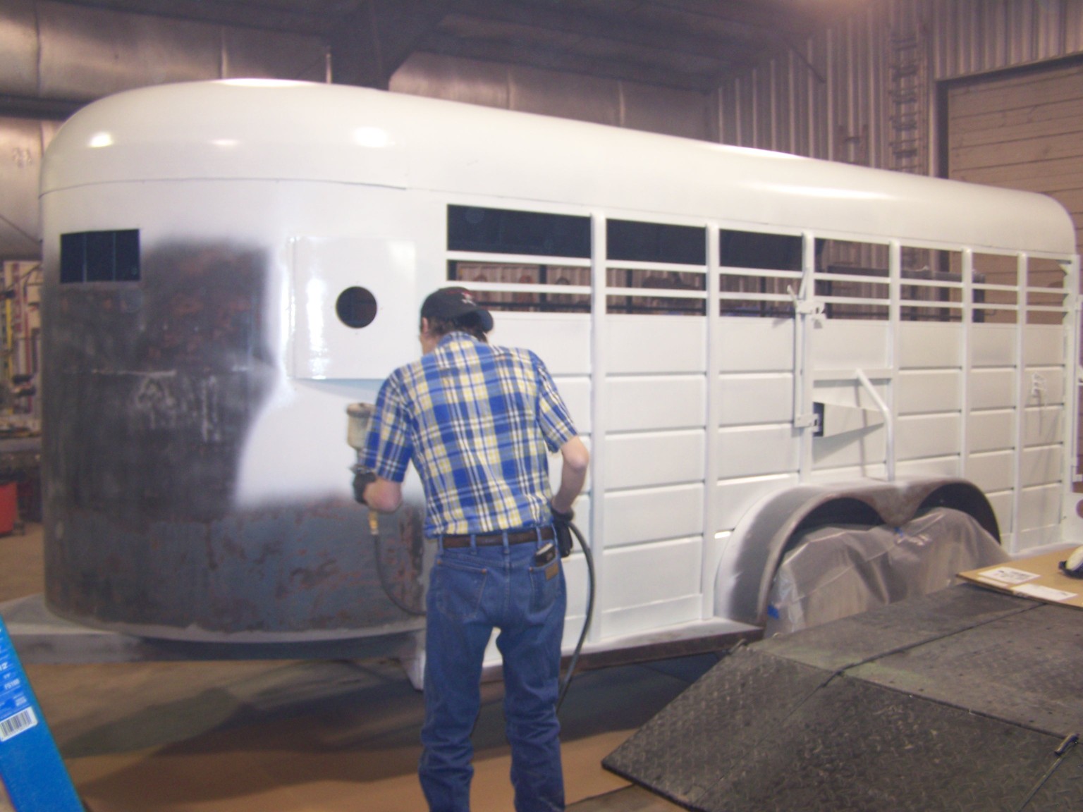

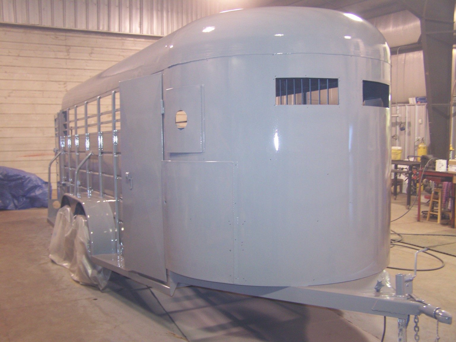

Had my little brother shoot the primer, he loves painting!!!!!!

Brother got sick so had a buddy shoot the color....

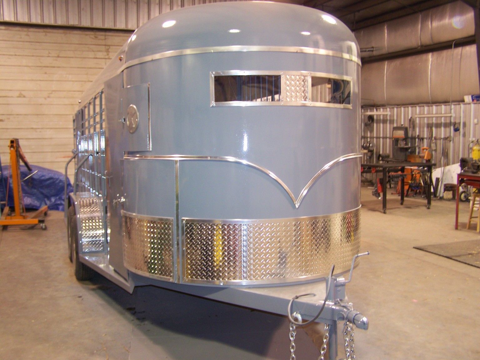

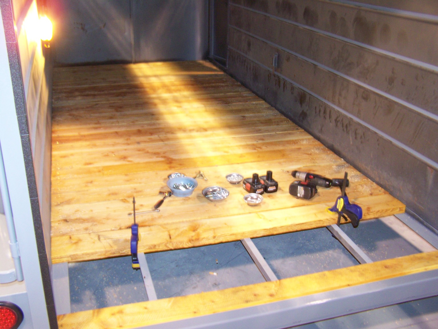

Installed new rough sawed 2"x6" floor, has 4 coats of raw linsead oil on all 4sides!!! New front windows, safety chains (old ones were too short), diamond plate aluminum shields, LED lights all around, wires, etc. Was able to reuse the factory trim for rest of the trailer. Word of advice..... use an air rivet gun when installing over 150 stainless steel rivets;)!!!!!!!!!!!!!
Before floor was installed I sprayed Eastwood rust encapsulating paint on all cross members and even in the front mangers, and tack compartment. Just to help avoid future problems;)
All in all I love how it turned out!!!!!! Wish it was darker paint, but NO WAY am I doing it over again!!!!! lol Now just have to purchase new floor mats and install the 2 divider gates.
