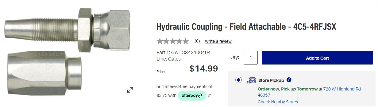

Working on an International Bucket Truck w/Altec boom......one of the lines at the operator station bucket has broken and someone recommended a "hose field repair hydraulic fitting"..........I have a few, but have never used. I realize they're generally considered "non permanent" repairs, but can someone comment on expected longevity.

Not couplers, but a 2 part connection fitting. Male or female pipe coupling on one end, your choice. Basically, you screw a nozzle with very fine threads into the (cut off) end of the hose followed by a reverse threaded cap that clamps the hose to the nozzle internally. They are re-usable, too. I've found them handy for that occasional blowout that occurs when a hose gets trapped or snagged and gets cut at the crimped fitting end.
I see them on Amazon, NAPA, etc. typically 15 - 20 bucks.
But you are in a bucket and probably NOT wanting an unexpected blowout, so I'd call it a temporary repair and buy a new hose to replace the bad one(s).

My personal experience with these types of fitting is completely positive. They must be installed carefully though. I have see guys screw the fitting into the hose at an angle and before it straightens out it carves a chunk of rubber from the inside of the hose. This chunk then circulates until it clogs something.
