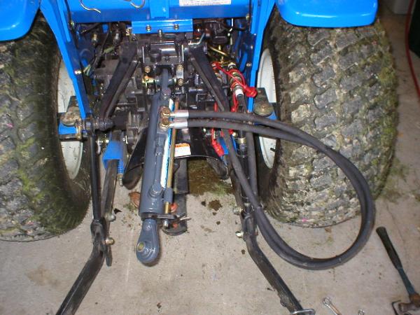

I have the NH rear remote kit. Want to add the CCM hydraulic top link. What length hose are y'all running? Any pics of the setup?

Here's the top link on mine. It's not from CCM, but it's the same manufacturer I beleive. The hoses are probably 3-4' long.

Thanks inspector - do you like the "loop" setup or would you prefer a shorter hose with more direct routing?
They could be a little shorter, just don't get too short and put something in a bind.
