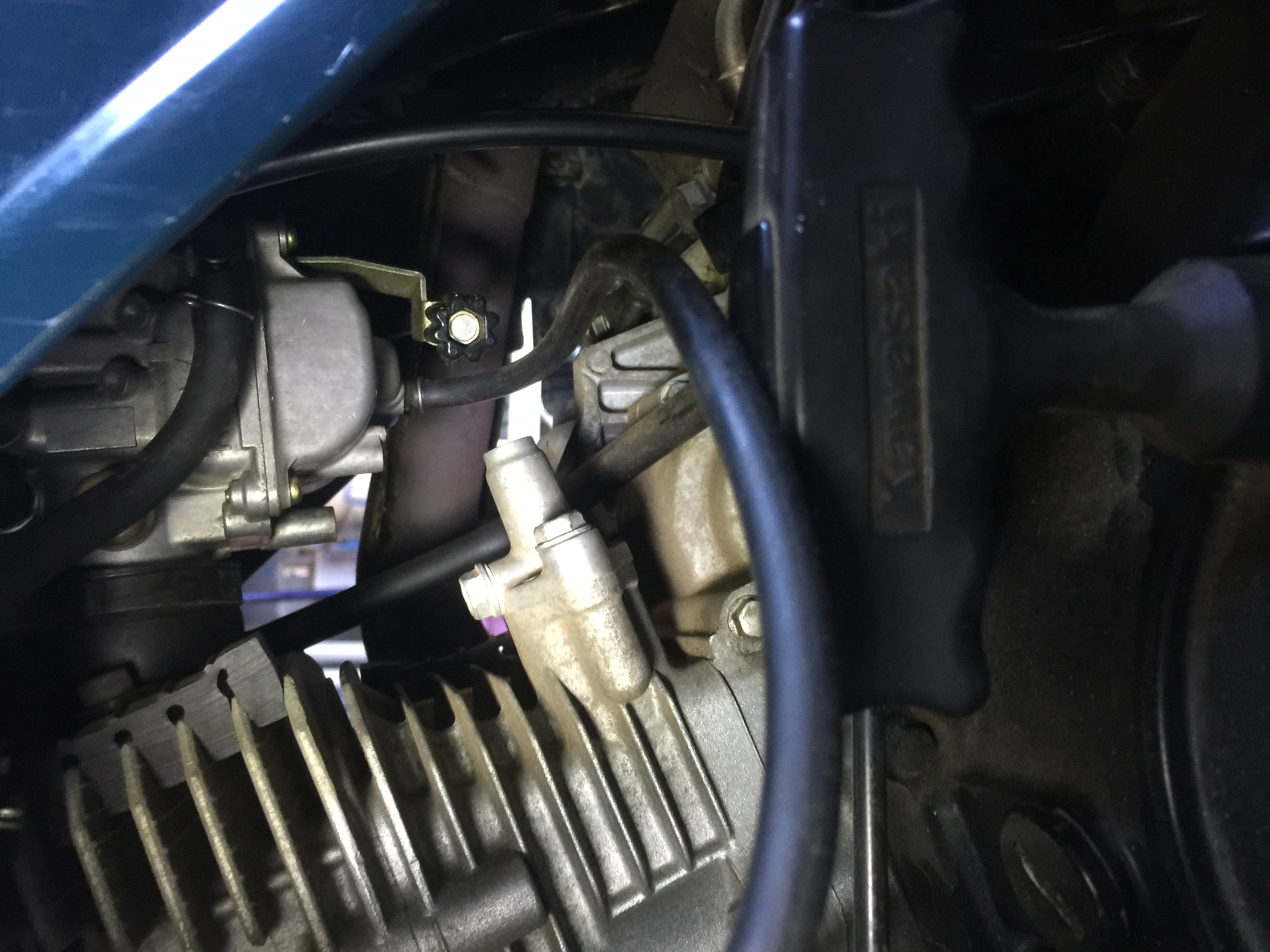

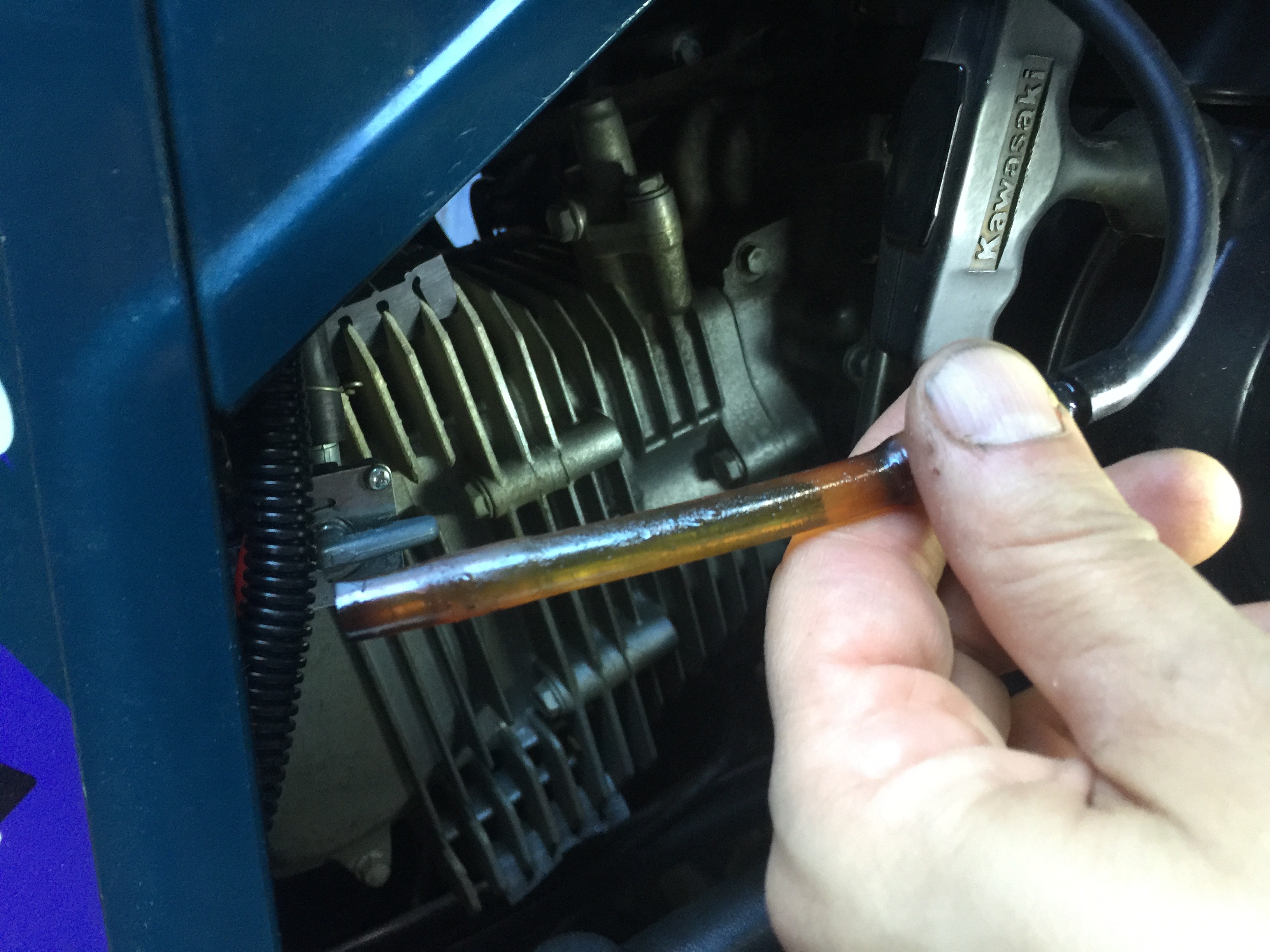

Hi we bought a 96 Kawasaki bayou from my wife's cousin in may. We had the carburetor rebuilt by the Kawasaki dealer in June.it was fine until the other day.i was turning it on every couple days just to charge the battery. Yesterday I started it and did other chores when I came back it was off due to no gas. I put gas in and restarted it. Ran it for another five minutes or so and shut it off. This afternoon went into our shed and smelled gas and saw a puddle on the floor. Saw that it came from a hose that was connected to the bottom of the carburetor but the other end was disconnected and just hanging down. I looked for a place where it connects to but didn't see any obvious place to attach it. So can someone tell me where it connects to? Thanks in advance.

My guess is that is a water trap and there should be a plug in the end of it. The water is heavier than gas and settles in the tube. You take the plug off every so often and drain the water out. Without the plug in the end gas would just pour out.
Edit I think where your holding it is the valve assembly that opens and closes the tube to drain the water????????????

That is an "over flow"tube;just so the gas doesn't drip on the motor;not connected to anything.Your carb float is stuck or have a bad needle and seat.On mine(apart a hundred times),just shut-off the fuel shut off when not using.Do not plug it;you could flood the motor and ruin it.

Most atv carbs have a hose off the bottom of the bowl to prevent gas from running onto the engine when the float valve doesn't seal it connect to an overflow tube inside the carb . If that is what it is then the rebuild didn't last long, which is not surprising with todays fuel issues, But if you plug that line it will cause the carb to overflow and fill the cylinder, air cleaner box, and possibly the crankcase with gas.

I think Birdman got it--two issues unassociated.
Hose is for draining the water out of the carburetor bowl end of/beginning of season/before removal. Rerouting can be a pain and may have been missed?
Gas pouring out sounds like stuck float valve. May just have got the needle stuck up. Pull air intake boot and see if it travels freely down and see. If not I'd pull the carb & check everythings clean and moving freely. 96 should be straight forward.

The drain valve screw on the bottom or the carb is indeed used to drain out old gas/water from the
carb. But that is also where you get corrosion from water sitting in there. Sometimes, opening that
screw is a mistake, as then it refuses to seal again. Best to take off the bowl and clean it. The hose
directs the effluent to the ground, or container.
