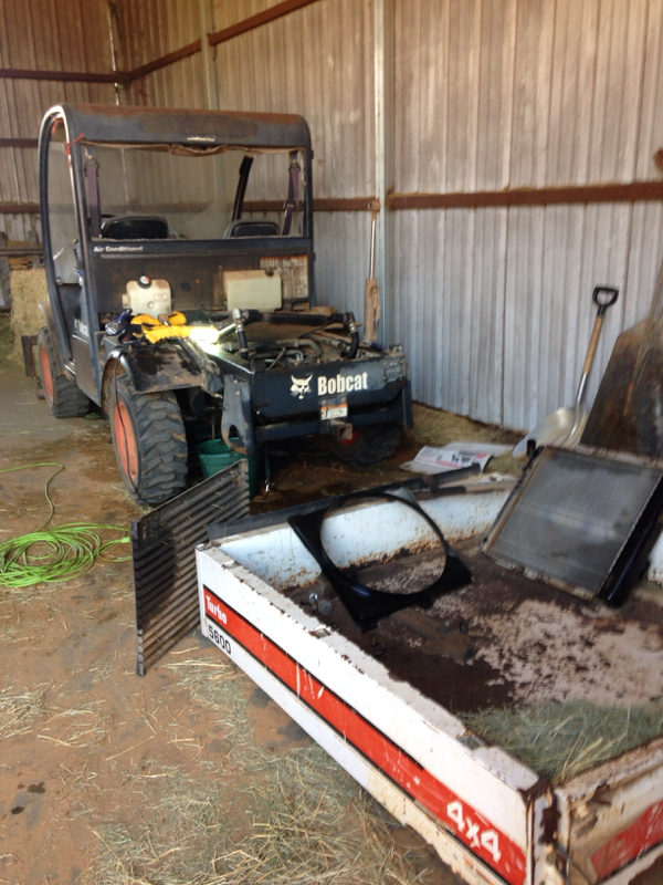

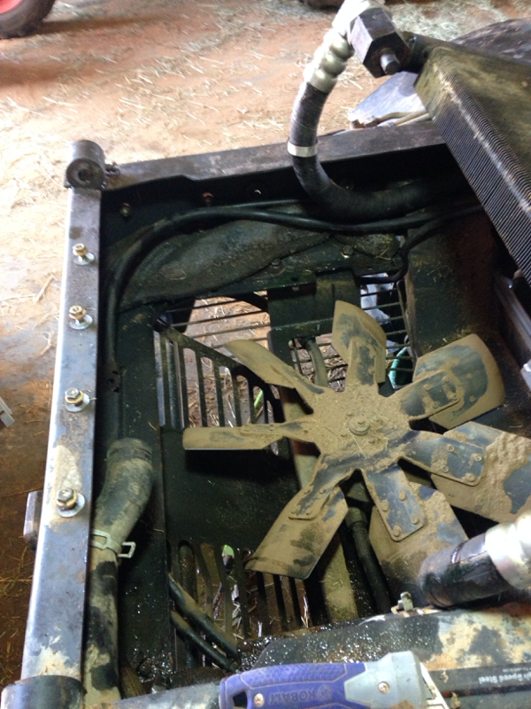

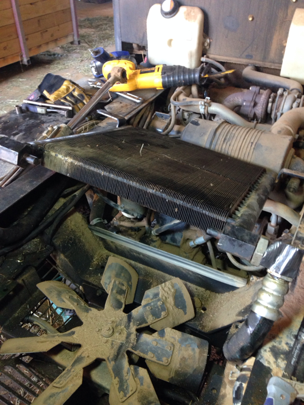

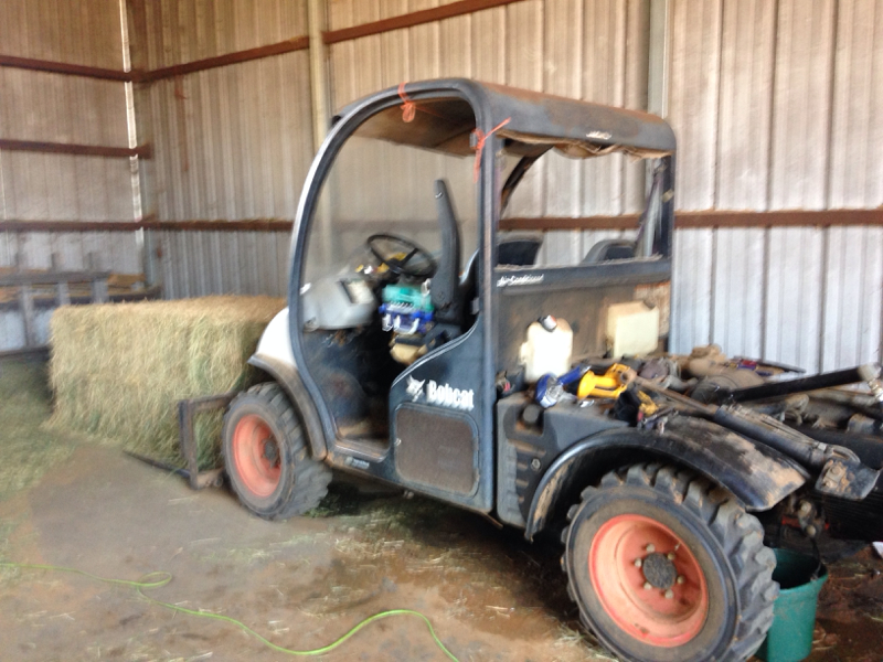

I have had this ToolCat for about 4 years now, my brother used it prior to me with his landscape company. It is now used at my horse ranch. As you can see by the plexiglass front windshield, no back windshield, or doors,and the carpeting falling out, it has seen better days. It pushing 3000 hours and engine is holding strong. Main issue I have had is the stupid hydraulic hoses. I have come close to replacing all of them one by one. I am now conquering a hose that runs the fan for the radiator. Which happens to be run underneath, behind, and around said radiator. Do I had to pull it. One thing I realized when pulling hydro oil cooler is the amount of dirt and debris buildup between it a coolant rad. I recommend all that have a TC to be sure and lift up the oil cooler to clear coolant radiator regularly. It's a pain in the as if yours is as old as mine but worth it. My unit has been getting a little hot when worked hard and I am pretty sure that was the cause. Anyways, here are a few pictures of my progress.
As you can see Juan was in the middle of moving a hay bale.
