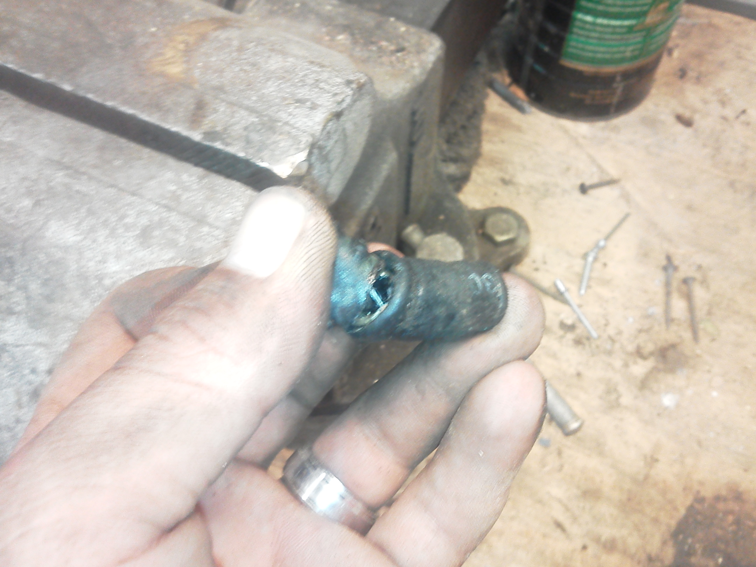

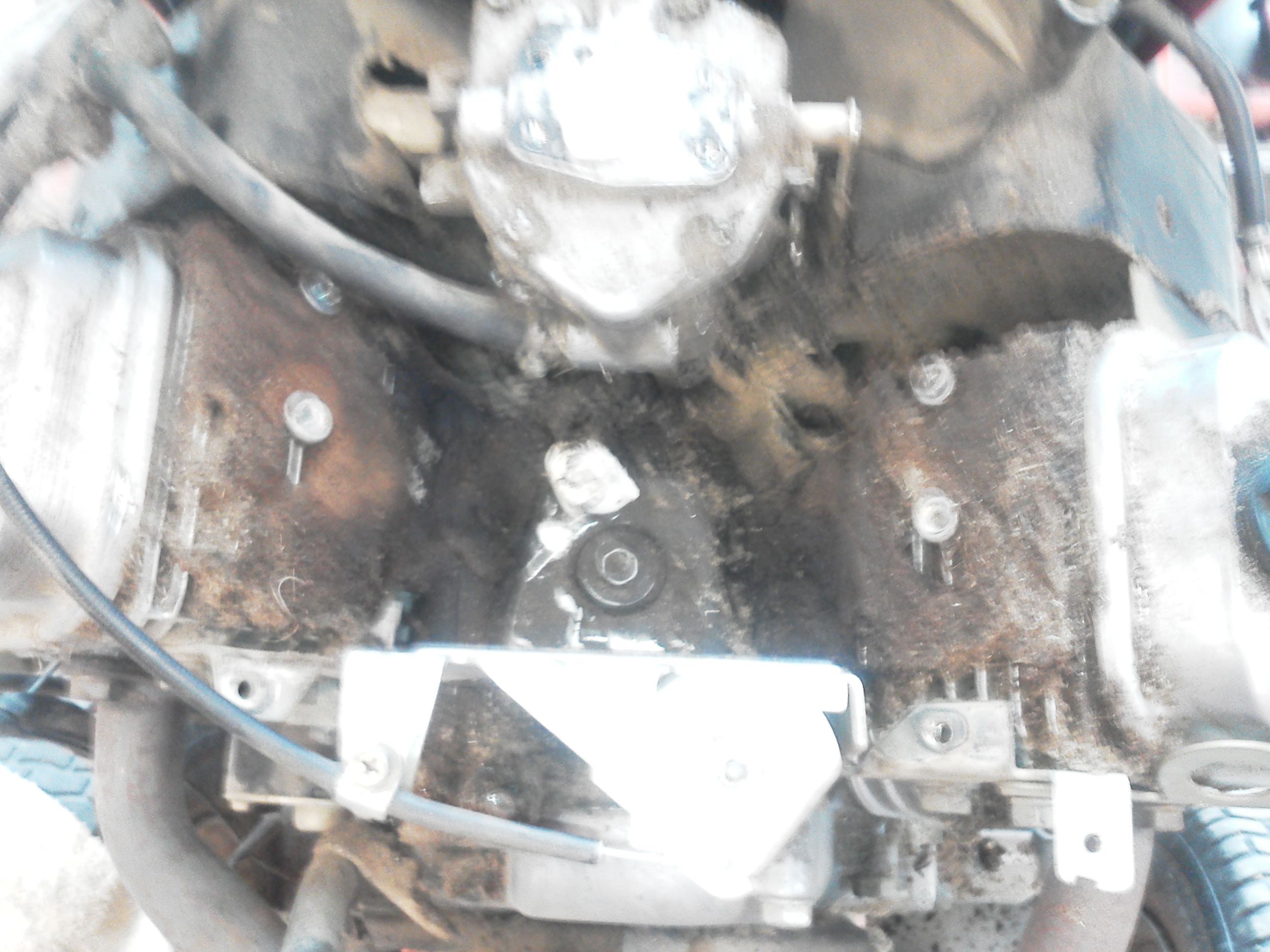

I took your advice and went ahead and pulled all the heat shields on the cylinders. The outsides looked good but the valley was caked. I appreciate your input. I wouldn't have thought to clean this area otherwise due to having to remove all the throttle linkages to get the shield out. Turns out in the end the problem was the vacuum line from the valve cover to the fuel pump. I guess as the hose softened up from the heat it was leaking.

before & after pics
actual culprit

A well-cared for Vanguard should last at least 2000 hours. The key is proper maintenance in a timely manner. As you found out, looks can be deceiving. All too often there are nasty gremlins hiding from your eyes and those can greatly affect the life of the engine. Air-cooled engines cannot be properly cooled if the fins are clogged and other areas have heavy build-ups of oil and dirt. So far, you have found TWO problems. Most likely, the problem you were having will now be solved. However, if you have not performed the other tasks I mentioned, then you run the risk of a shortened engine life. At 1200 hours, you are past the half-life of the engine. How many more hours you will get from it is in your hands. I'm glad that my advice assisted you in discovering what was wrong. If you found value in what I said, then follow the rest of my advice and protect your investment. A little time and money spent now can save you many hundreds down the road.
