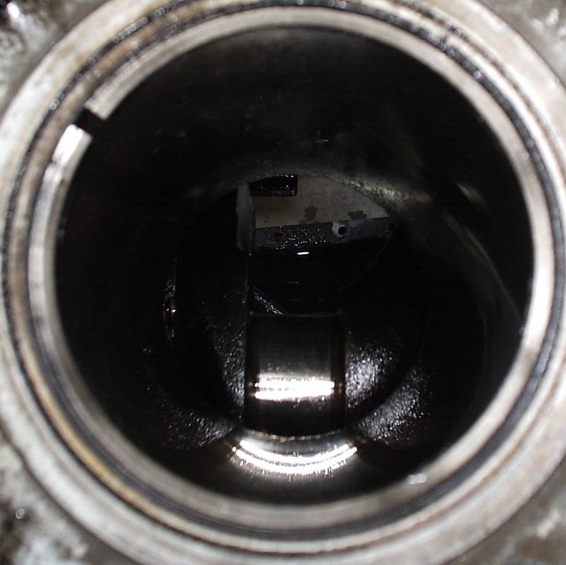

   / Hot,Oilyand sluggish YM1700 #3
I just had the same kind of problem with my YM1700. When I tore it down I found the rings worn very bad. When I removed an oil ring from the piston and put it in the cylinder there was a 1/4 inch gap. The new rings had maybe a .020 gap at most. I replaced rings, rod bearings, had head worked with new valve seals and it solved the problem. To date I have 18 hours since rebuild and still full of clean oil. Very happy with my decision to go ahead and rering. I also added the YM2000 water pump and I've not seen it go above 200 degrees even with some heaving mowing and hard tilling.
Here is a picture I attatched with the ring gap.
That does it. I was trying to decide whether to put in rings. For the $100 I think I'll go ahead.
