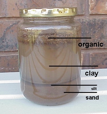

Yes, there is a simple way to determine moisture content of most materials that will contain moisture, whether it be sand, dirt, wood or other. For soil structure you can do that test yourself also. Shake sample with water and leave set for a few hours.
http://www.deldot.gov/information/pubs_forms/manuals/mat_research/pdfs/doh_2.pdf
Sugar sand would be difficult to compact. Fill material for construction should be free of any organic material. Ideally builders sand would be a good choice, similar to foundry sand. If you have a soils person connected with your county extension service he/she may be of assistance or if not they could point you to someone that works in that field.

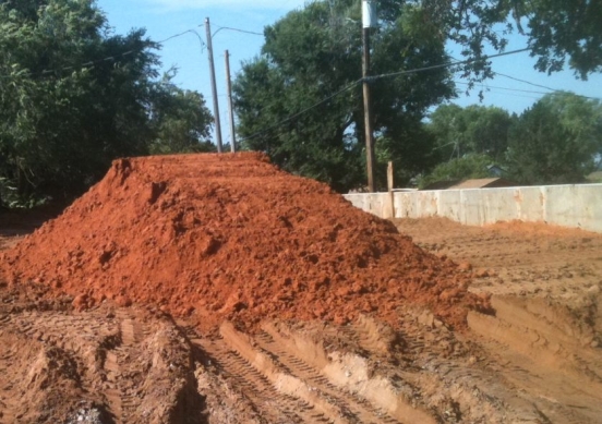

How well your sand packs depends on the grain size distribution and fractured surface of the sand grains.
For water content take a handful of sand and squeeze it. When you open your hand and the sand remains in a sort of a ball it may compact. Use a vibratory packer.
