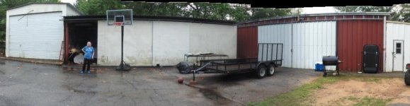

They tried to bill us for a commercial rate for my shops in the pic.
They are about 100 yards from the house.
Darn near choked when I heard what they wanted for the commercial fee. We probably average < $10/month above the meter "rent".
But the middle building has an "apartment", w/ toilet & stove. (and 400 amp service panel) So my lawyer (wife) convinced them it was residential. Luckily the tax assessor doesn't seem to talk to the electric company.
