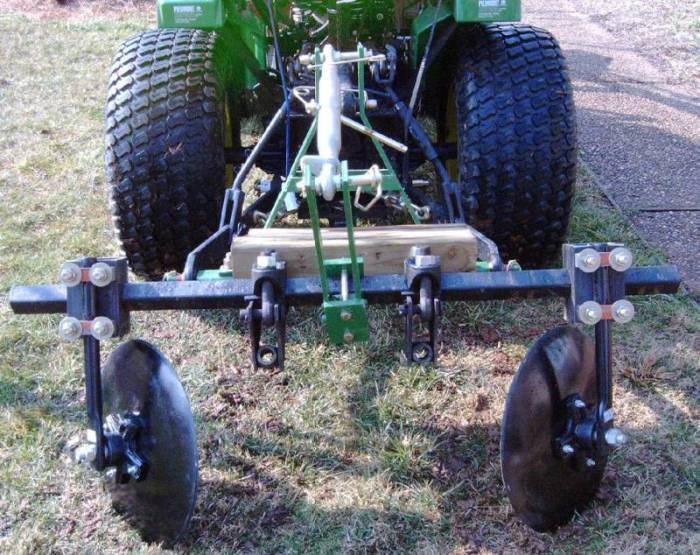

Take a look at the Agri Supply web site and find a device called a "keulavator". Think it comes with 2 discs or can have 2 mounted on it. Even my little 4010 will pull 2 12" discs opposed at 45 degree angles behind it to make raised rows. It would pull them with the both angled the same way to tear up the soil. Trouble is my little tractor would get kicked around a bit with them back there. Yours probably won't.
I made my own rig from the diamond bar from an old M soil ripper. Here's a pic of it. The Keulavator looks similar to this.
Ralph

Correction. Think those in the picture are my 20" discs.
Ralph
