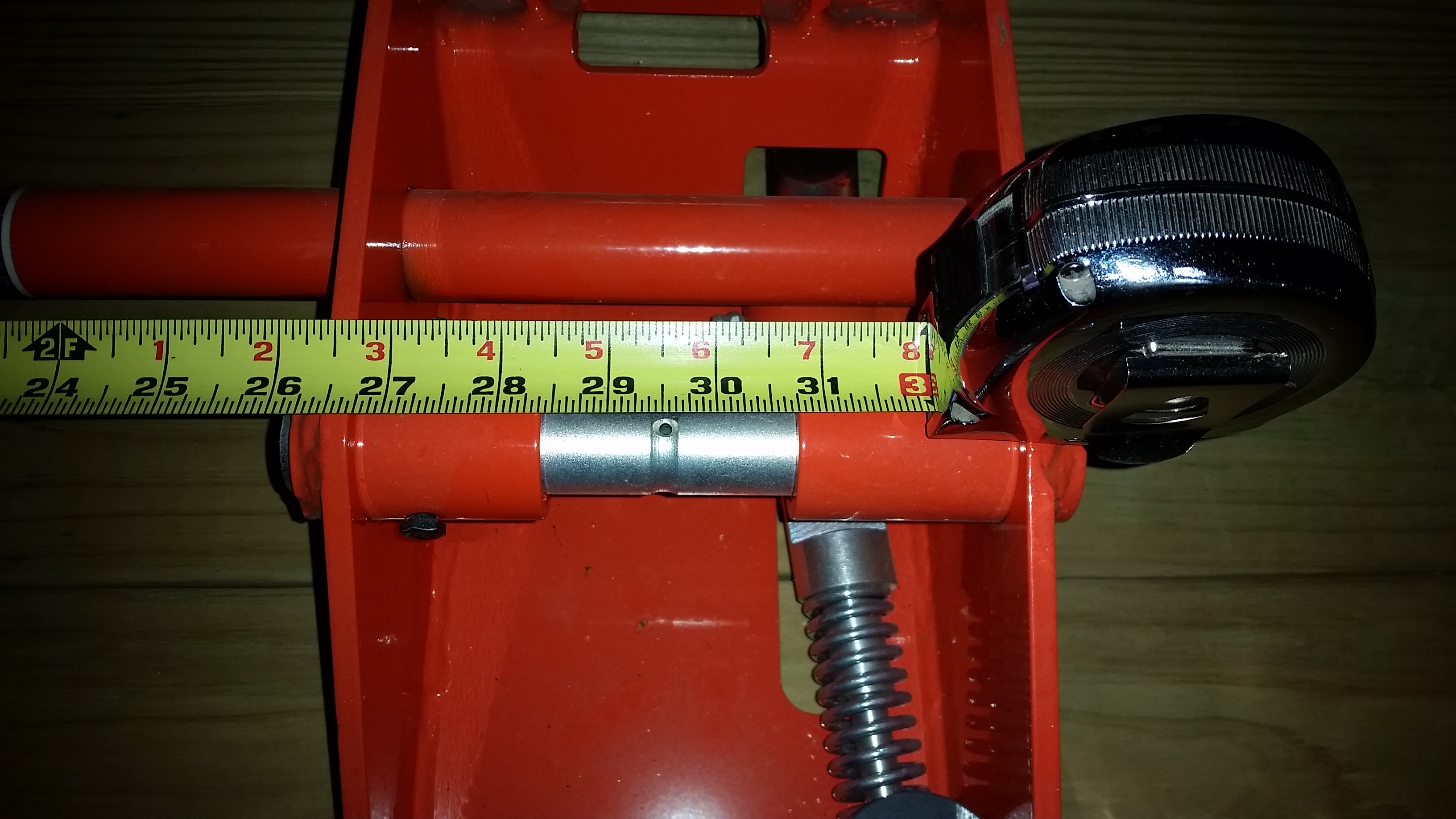

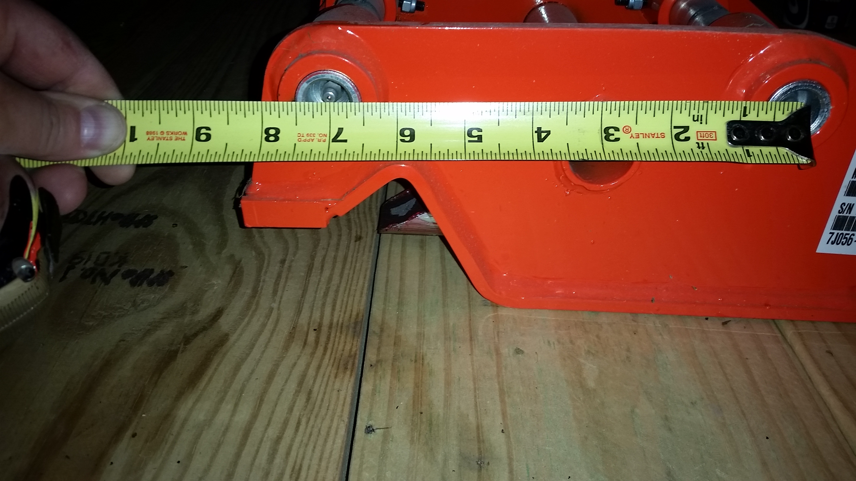

This info may be late for jodebg, but seems to come up occasionally.
The B2366 skid steer quick attach (ssqa) adapter has these critical measurements:
7" pin spacing, with 1" diameter pins and 29.5" from center to center of the hydraulic loader cylinders.
   / How can I access the diagram and measurements of a Kub B2366 universal quick attach?
Thanks, Chris.
